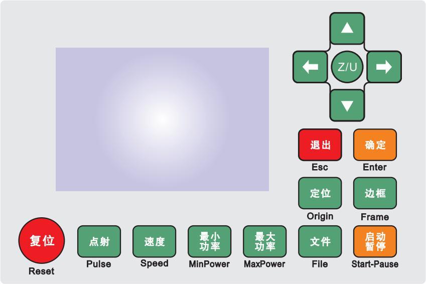

âOn the Ruida controller, press the âZ/Uâ button to enter the menus.â This is where I am now. Can you put me in the right direction to find this menu?
For an ordinary laser with a Ruida 6442 controller (for example), youâd poke the Z/U
button on the machineâs control panel:
However, photos of the Mega show Monportâs custom firmware has done away with the panel in favor of their âintelligentâ M-Design Hub
program, so instructions for ordinary machines do you no good.
It is possible you can set the IP address through the Monport program, but the description says it supports only âWiFi / USBâ connections, so a hardwired Ethernet connection likely isnât possible. If you can find the WiFi address and set LightBurn to use it, that might work.
This seems like something you must figure out with Monport tech support, because the machine is definitely running customized firmware âŚ
