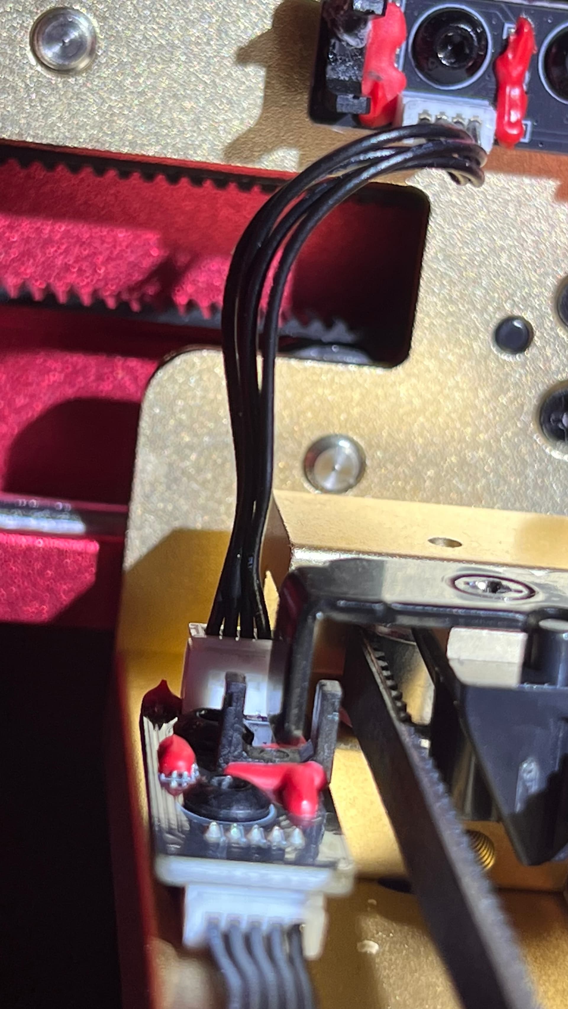

  • Are you certain that’s the proximity switch for the Y-axis? Make sure that’s the one that will eventually align with the metal tab that’s positioned to trigger along the Y
    Yes it is aligned (picture attached)
  • It’s not apparent to me the plastic piece that you’re indicating may be broken. Can you take a clearer picture of that?
    Updated Picture is attached

Oh… that plastic thing you’re describing is in fact the proximity sensor itself. At least one side of it. One is used for Min Y-axis travel and the other is used for Max Y-axis travel.
You will need to get that replaced for homing to work. In the meantime, you may be able to get away with manual homing but I’m not aware if the firmware will allow that.

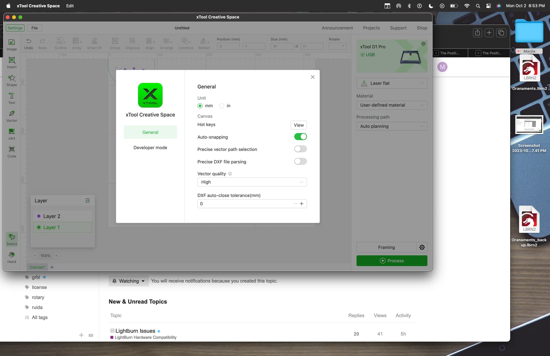

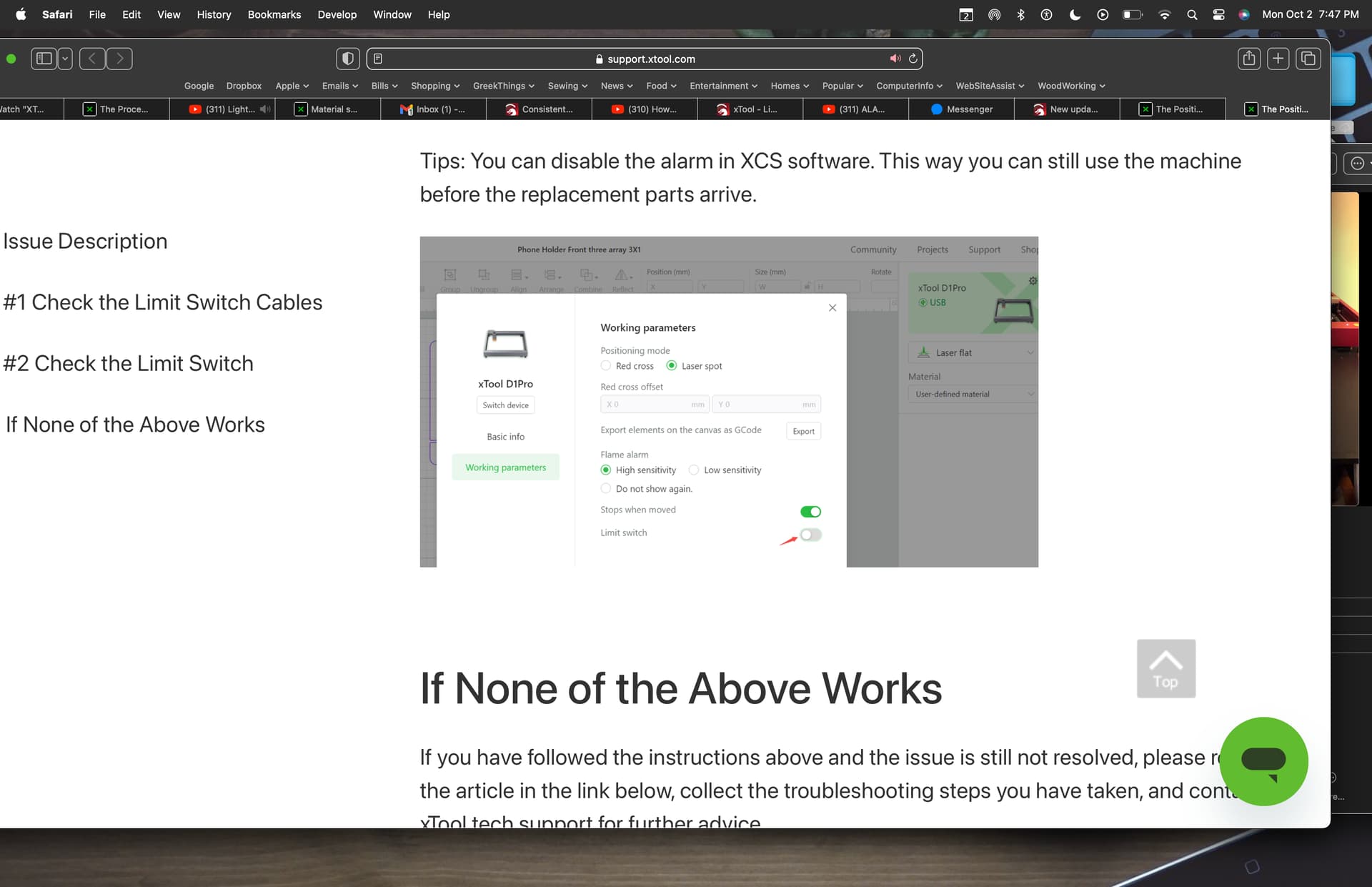

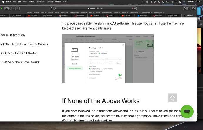

I am also trying to figure out who to send the pictures and videos too so I can get replacement sensors, plus I do not have the option in xTool Creative Space, like the document say I should for the Limit Switch to turn off (see attached picture)
What does your screen look like instead? Can you confirm that you’re on the latest XCS?
I assume the video was with the switches connected then? Please confirm.
My xTool Create Space looks like the below picture
and Yes, the switches were connected in the videos

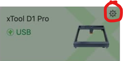

How did you get to that screen? Did you push the gear icon shown here?
If not, can you try pushing that button?
I clicked the Setting button. I clicked the “gear” button and see it now Thank You!!!
