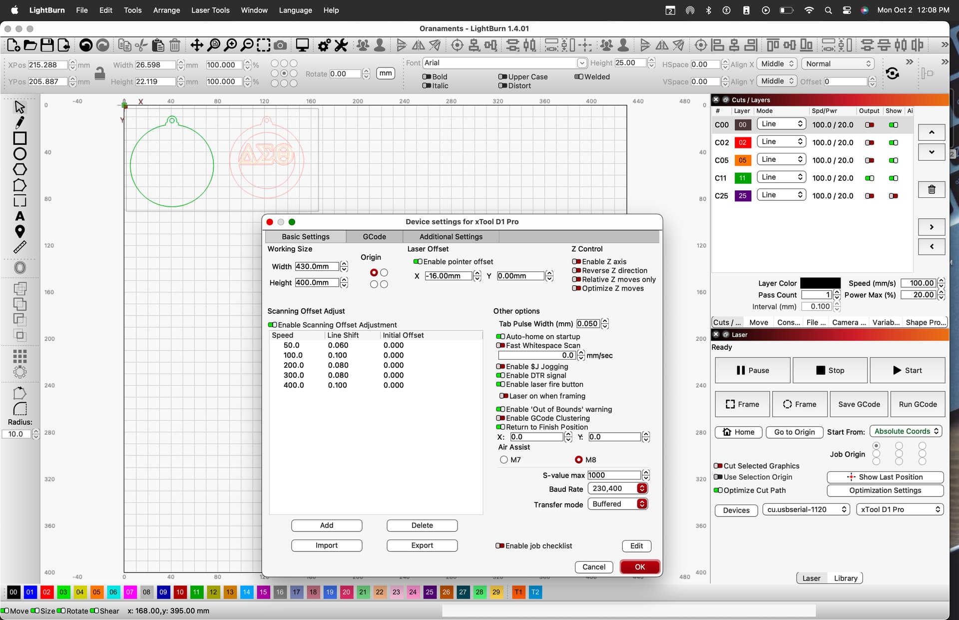

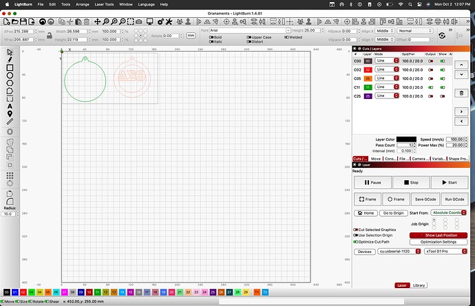

@MarjorieNicole07 Can you provide the following:
  1. Full screenshot of LightBurn with your design loaded and ready to burn?
  2. Screenshot of Edit->Device Settings
  3. Can you confirm what happens if you do this:

  1. I have attached both screenshots

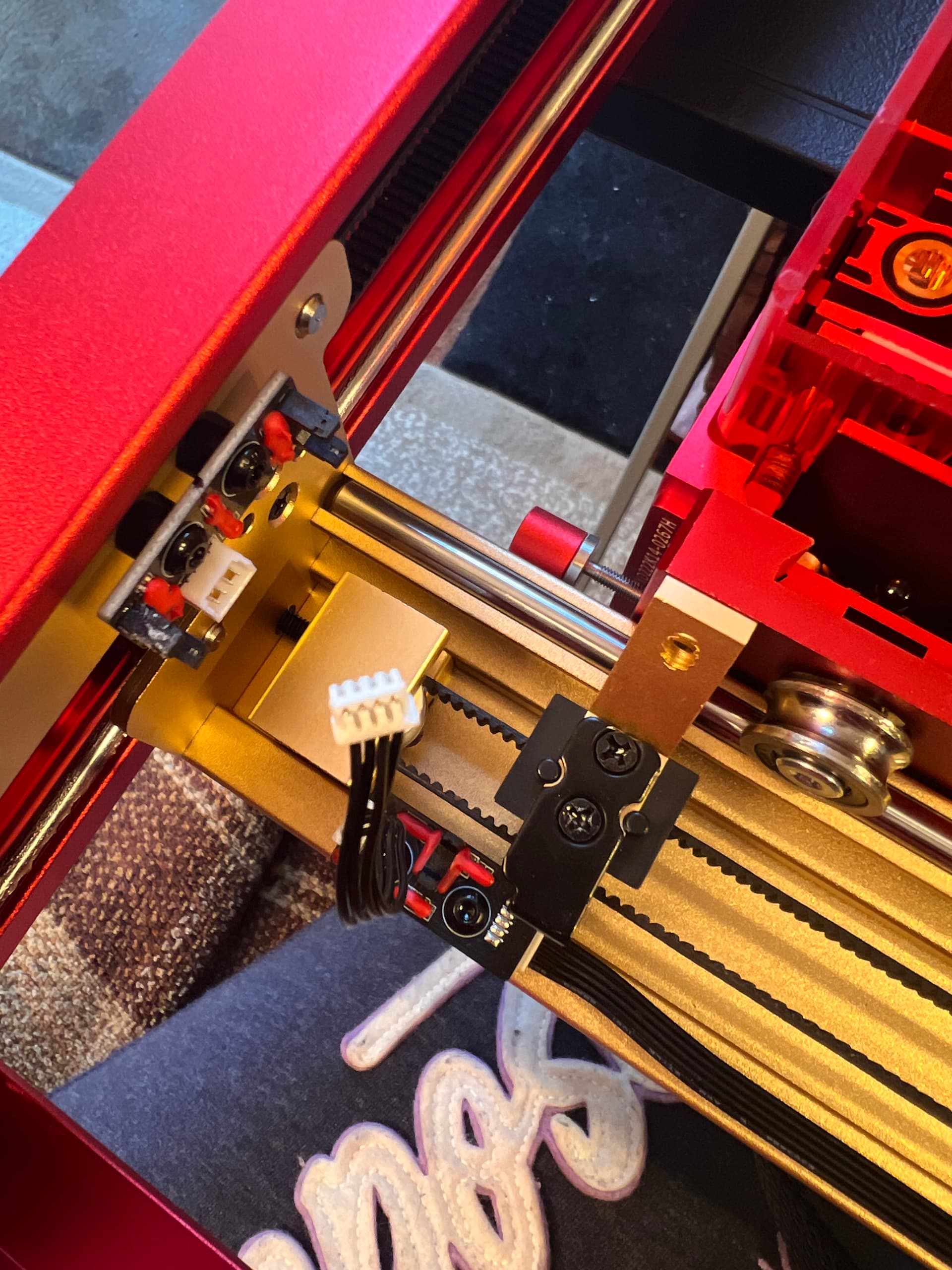

I looked at my sensors for my Y axis and in the article you advised me to look at, it states that I can turn off my Limits in the software of XTool Creative space, under the Working parameters section.
I do not have that section in the software. I have reseated my scensor connections and I am still getting the Alarm 1 error message on the Y Axis
I was suggesting you physically disconnect the switch to test.
Ok, I have disconnected it and as soon as I hit Frame, I get the loud buzzer sound, I have also attached a picture of it being disconnected. Also I did notice that a plastic piece (located in the picture - top left, near red bar) looks like it is broken.
A few questions:
  1. Are you certain that’s the proximity switch for the Y-axis? Make sure that’s the one that will eventually align with the metal tab that’s positioned to trigger along the Y
  2. It’s not apparent to me the plastic piece that you’re indicating may be broken. Can you take a clearer picture of that?
  3. Instead of framing, can you rerun the homing test from earlier. Move the laser head to middle of bed. Then home. What happens? What type of movement do you see?
  4. Are you able to tell from where the buzzing noise is coming?
  5. I suspect the buzzing may be due to loose belt tension or other mechanical issue. Do a mechanical review to see if anything is out of alignment and review tension or if anything is loose.
