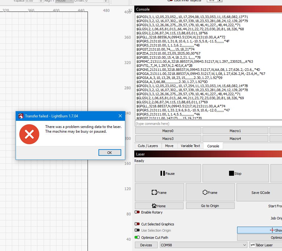

Console continuously has code running and Problem sending data to the laser
I have the right COMMPort selected and under Laser it says “Ready” but the Console just continues to type code and when I click Start it shows Error that “There was a problem sending data to the laser. The machine may be busy or paused.” Clicking stop or pause wont do anything and it will not respond with the Home button. What am I doing wrong. It worked the other day.
Ignore the “Ready” message. It doesn’t mean anything.
The console messages show a very different command style than grbl. This will be a different firmware, you need to change the type of laser, I guess. Or you selected the wrong COM port.
