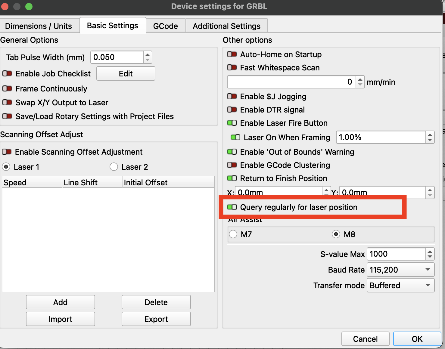

I got a new laser, Algo Alpha MK2. When trying to run lightburn after connecting I get this message in my console that keeps running. After homing is oked

PS:0.0
<idle/MPos:0:000:0:000:0:000/Bf:63,65535/FS:0.0/Pn:xyz/CL:0,0/
This just keeps running. Usually with my other laser while a job was running it stayed on the cut/layers screen.

You mean you have this line scrolling through the console all the time? Disable “query laser position” in device settings to solve this.
I have been looking, but do not know where to find query laser position to disable it.
Thank you

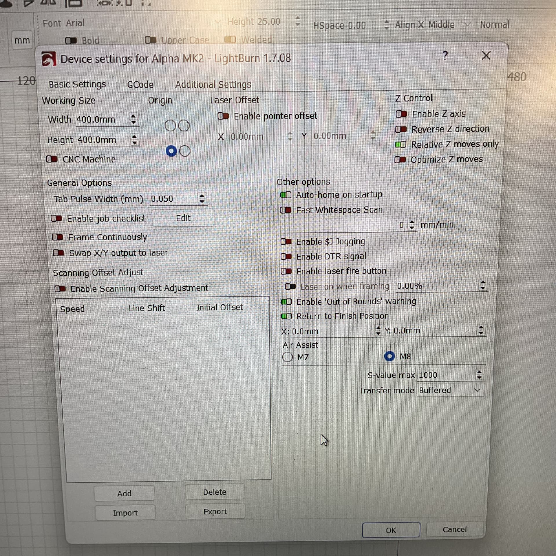

This does not show on my screen
Ah, ok. You are not running the new 2.0 version. Then it’s no issue related to that version. Can you show the console window?
I was running the new version but my laser turned off partway thru my job. I reinstalled 1.7 and will update again later. This did happen with 2.0.1

I was running it at the time this occurred,but then reinstalled the earlier version because I was using a brand new laser. Yesterday was the first time I ran it.
