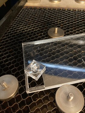

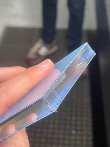

Constant cracking / shattering / fracturing on 12mm acrylic
Hi all. Pressing question today. We just can’t seem to escape what seems to be stress fractures on our extruded clear 12mm acrylic. I’ve tried varying speed, power, air assist pressure and nothing seems to change. We aren’t using anything to clean or wipe before the cracks appear either. We’re cutting with a 150w glass tube with a 4" lens. Typical settings we’re cutting at are 5mm/s, 85pwr, 20psi air assist. If anyone could shed any light that would be greatly appreciated.

You call the marks in your picture tension/stress marks, I have only observed something similar in acrylic that has been in contact with acetone or chlorine, but if it happens it cracks over a larger area, yours looks very local.
Last week I tried to use a lower power setting, closer to your 16mA and it yields almost exactly the same results. I’m starting to think the slats/bars on our bed are flashing back and causing the cracking, only strange thing is that its only recently started happening. My next best guess is how our material is being stored, its in a fairly cold environment and temperature shock is about all else I can think of. We also never seem to get this problem on 3mm but 12mm it is rife.
This does not match my experience. I cut directly on the honeycomb bed, with the reflections that must be there during the process. I do not have marks or the stress cracks you have.
Could it be that you have received some bad material?
