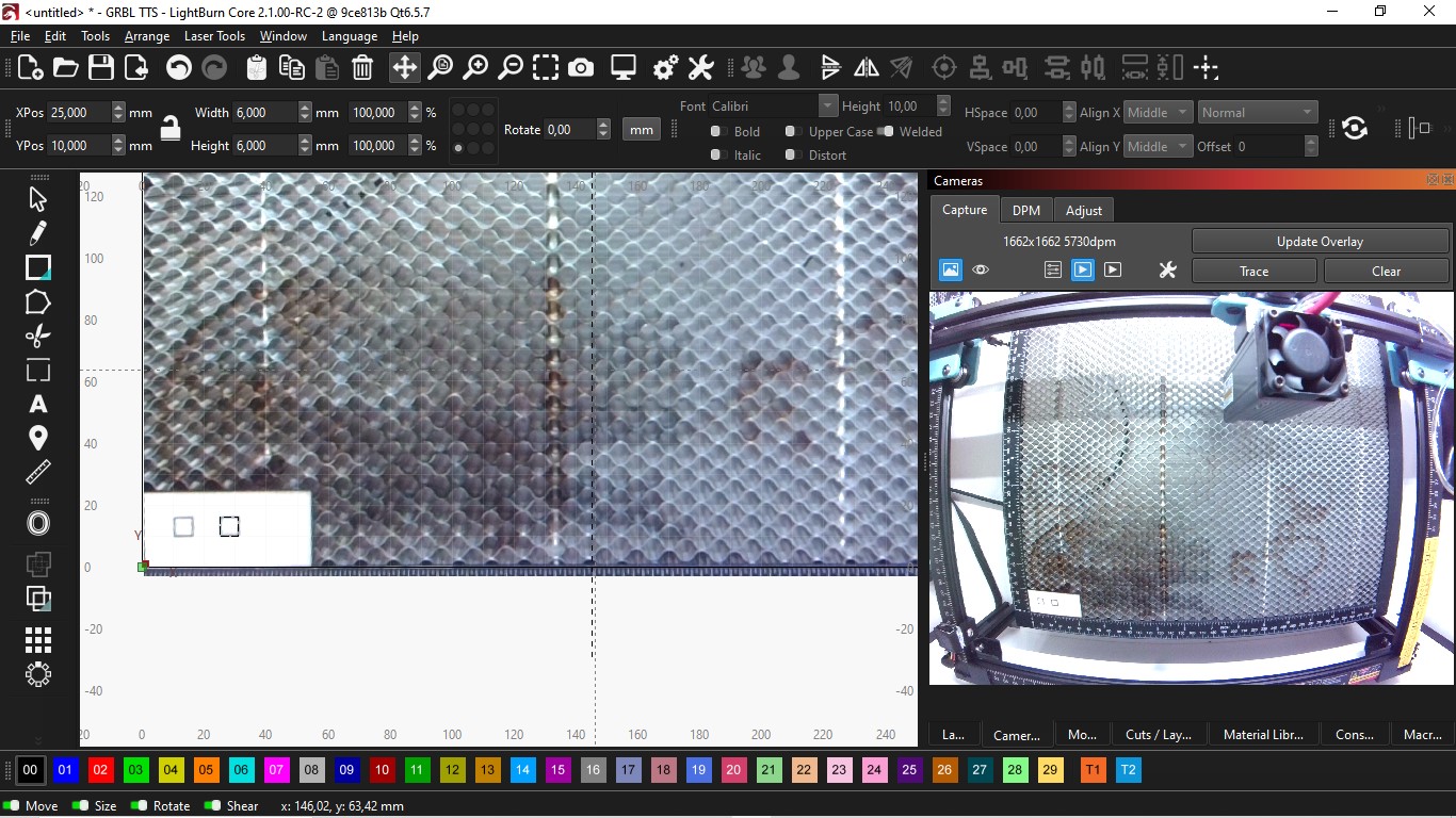

My 120 degree 5MP camera continues to deliver great results after using 2.1.00-RC-2 update. I just followed the lens and alignment calibration steps and with very minor adjustments ( X shift 0.5mm & Y shift -1.5mm ) the size and position remains perfect anywhere on my 290x290mm work area. One minor issue, which is still a mystery, was when one time the framing of a job was way off from my XPos and YPos settings. The framing continued to be off regardless of any adjustments to origin and only after relaunching LB did it go back to “behaving”. Take care and keep up the great work. PS…… there are two squares in the cut piece one on RH has the “selection” sitting on top of cut out …. not very clear in the pic.
