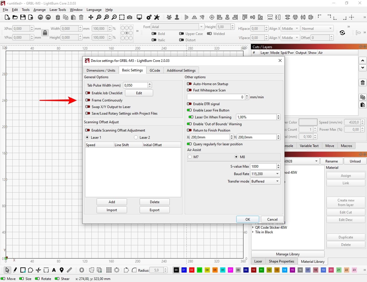

Continuous Framing Xtool D1 Pro
Is continuous framing no longer supported for Xtool D1 Pro..
If I switch to a different device like GRBL this option appears.
Have you check if the option “Frame Continuously” is selected?
I don’t have this option in my device settings for Xtool, It does show up if I change to GRBL device

Does this happen when you switch to GRBL device under “Devices” in the “Laser” window?

The xTool D1 pro is not running GRBL, but a compatibility layer over their proprietary firmware.
@Kuth We made this special “xTool” device type, which bypasses this compatibility layer.
It is recommended to use this for the D1, D1 Pro and S1.
For reference: Setting up xTool S1 with new xTool device type in LB 1.7 and Beyond
I can confirm, that Continous Framing for the xTool device type is also missing on older versions, and I’m sure there’s a good reason for it.
xTool has some “undocumented features”, for example: Their firmware seems to have different acceleration speeds for engraving and marking/cutting, and they use some “magic heuristic” to decide which one to use.
