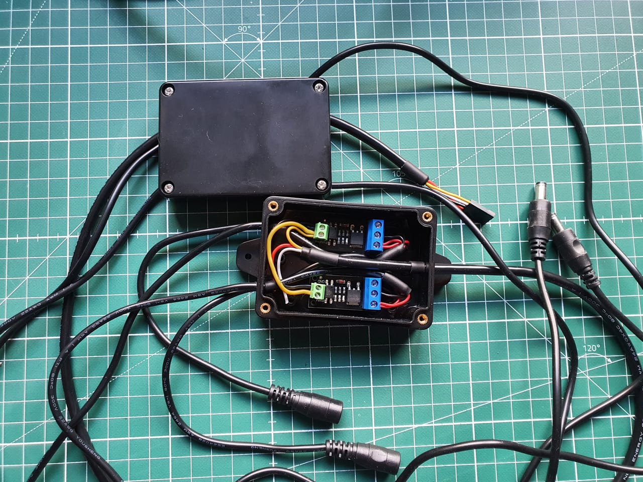

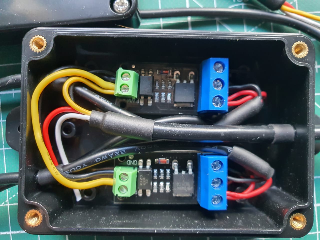

I control Air Assist and the Enclosure fan. The laser fan is always running if the laser gets power. Not a good plan to play with the power for the laser itself. Her you can see pictures of my switch box: Facebook
Facebook
This should give you an idea how it is connected. I don’t have a schematics made.Unfortunately in this forum you can not attach pictures.
