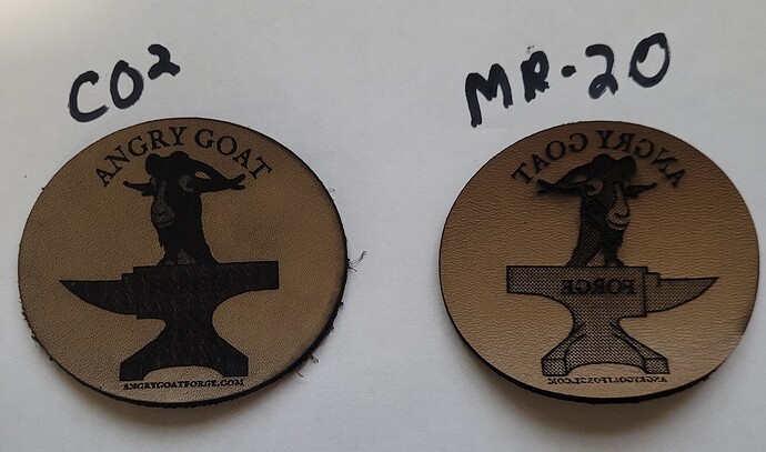

I think that the AtomStack MR20 included a new controller as the original shipped on the Atomstack A20Pro. So, unless there was manufacturing defect this controller was a direct replacement. There is no way to install it other that the way the original controller was installed, The rails are marked 0 to 440 and the wire harness will only work closest to X0Y0. The issue with homing may be related to the graphics are reversed. I have 2 lasers connected to computer cutting the same artwork on both machines with no changes. The results of that cut follow:
I suspect that the orientation confusion may be related to this issue. I will put the original controller on this machine and recut this art. Maybe I have the beasty put together wrong from day one.
Perhaps it’s electrically a drop-in but still requires configuration. Is the new controller only meant to be used with A20Pro or is it meant to work with multiple lasers?
This may be related to your origin setting being put to top-right.
