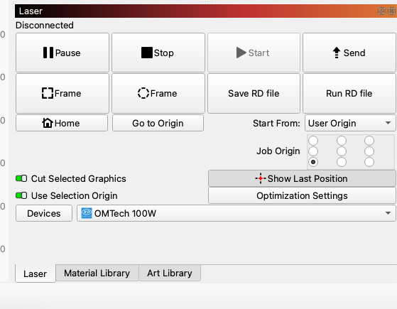

Controlling job origin with multiple objects imported into Lightburn
Is there a way to read multiple objects/files into Lightburn and have only one of the objects used to set the job origin. I have tried putting objects on different layers, having the layers output or show, but the position of ALL the objects still affects the job origin. The goal is to read in multiple files, edit and size each one and be able to print each one with it’s own job origin, for example, centered.
Use the Cut Selected Graphics AND Use Selection Origin Switches in the Laser window.
Thank you Tim. That option was not obvious to me at all. Happy New Year 2026 to you and everyone.
