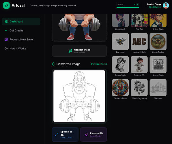

I recently used this site (Artozal – AI Image Converter for Artists | Free Trial for UV, DTF & DTG Printing) to produce a line drawing from a JPG picture. I was very impressed with the results. Having tried all the usual online apps (as well as Trace) I just wasn’t happy with the results, so I went looking for something else. That’s when I ran across Artozal.

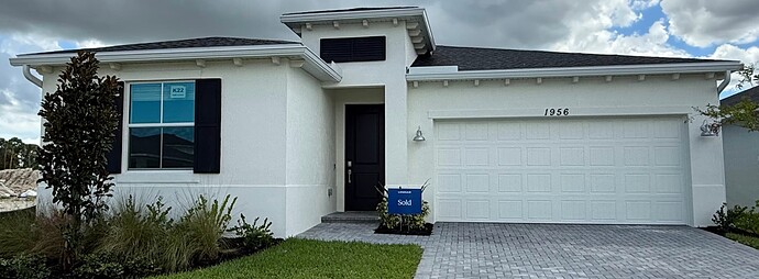

This is the photo that the customer provided.

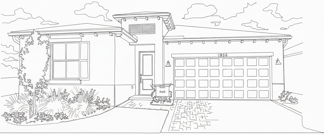

The line drawing that Artozal produced (there were a number of different styles to choose from).

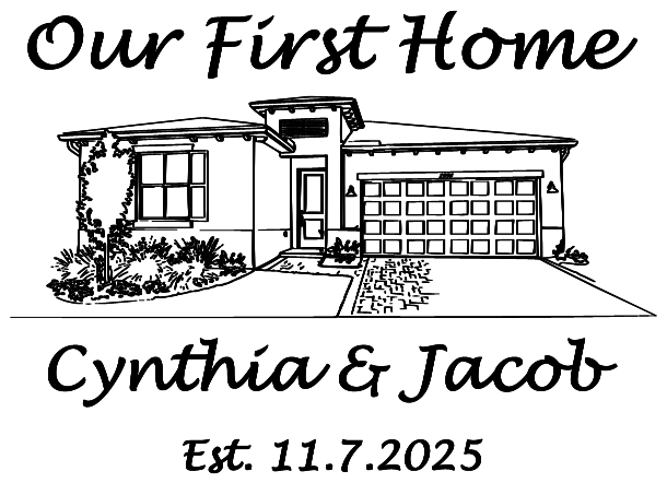

And, with a little editing in Lightburn,

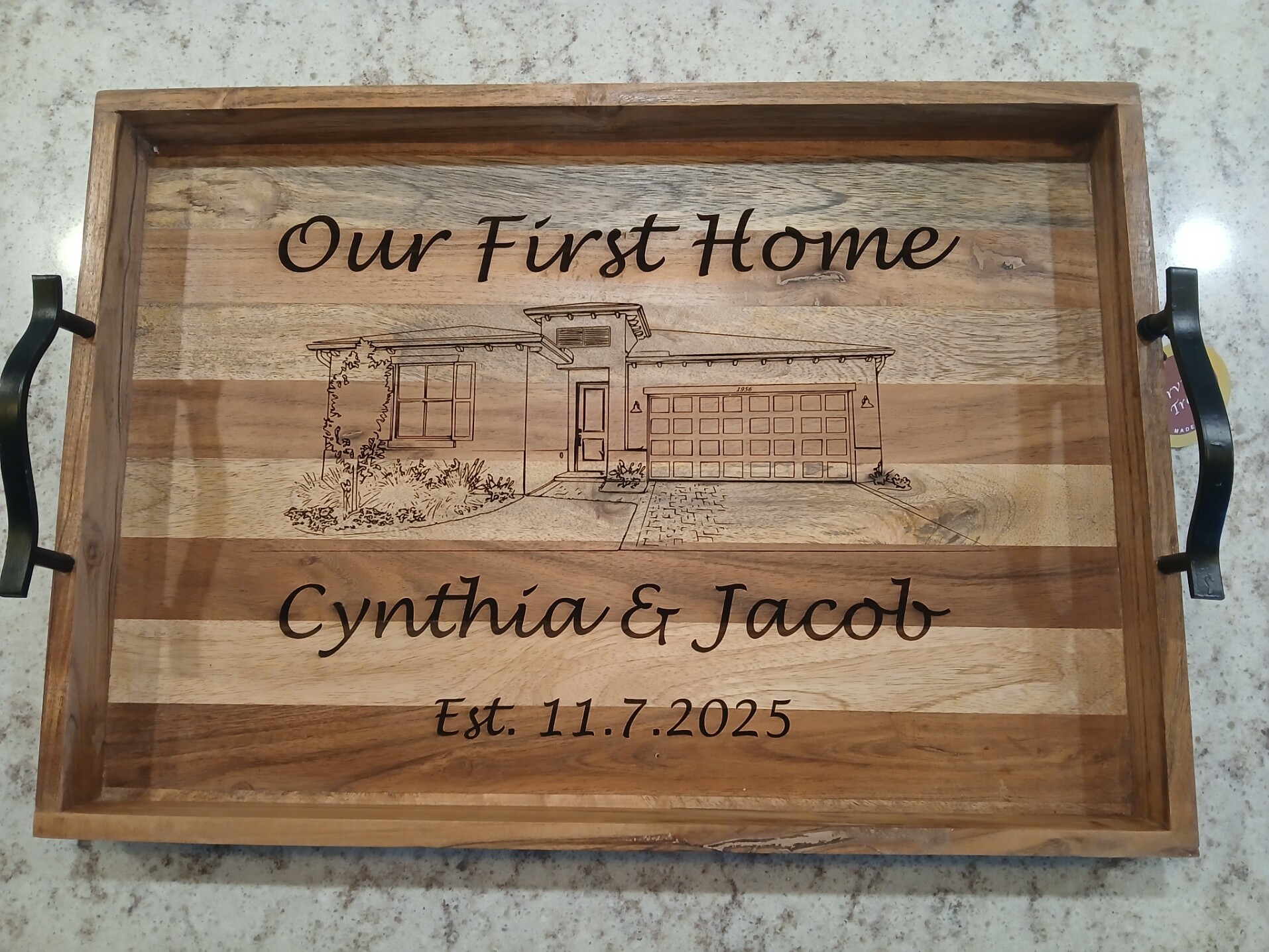

The final image that I engraved on the serving tray.
All in all, this online program gave me a pretty amazing result, and the client is very happy. They do ask for a small donation to download your image file ($5 gets you 10 downloads). For me, it was well worth it. Just my two cents worth.

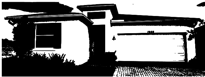

Did you try putting the line drawing it provided through Lightburn trace, Im wondering if it would make further manipulation of areas such as window-frames, window glass, guttering etc easier to place on a seperate layer…Quickly.
This is what Lightburn trace produced.
I tried adjusting the sliders to get a more usable image, but never got it to where I was happy with it. After trying a couple of different styles in Artozal I found one that was just the ticket. The client wanted the “Sold” sign removed, so I used the Node Editor in Lightburn to take it out, and add some shrubbery (Ni….shhh…shhh).

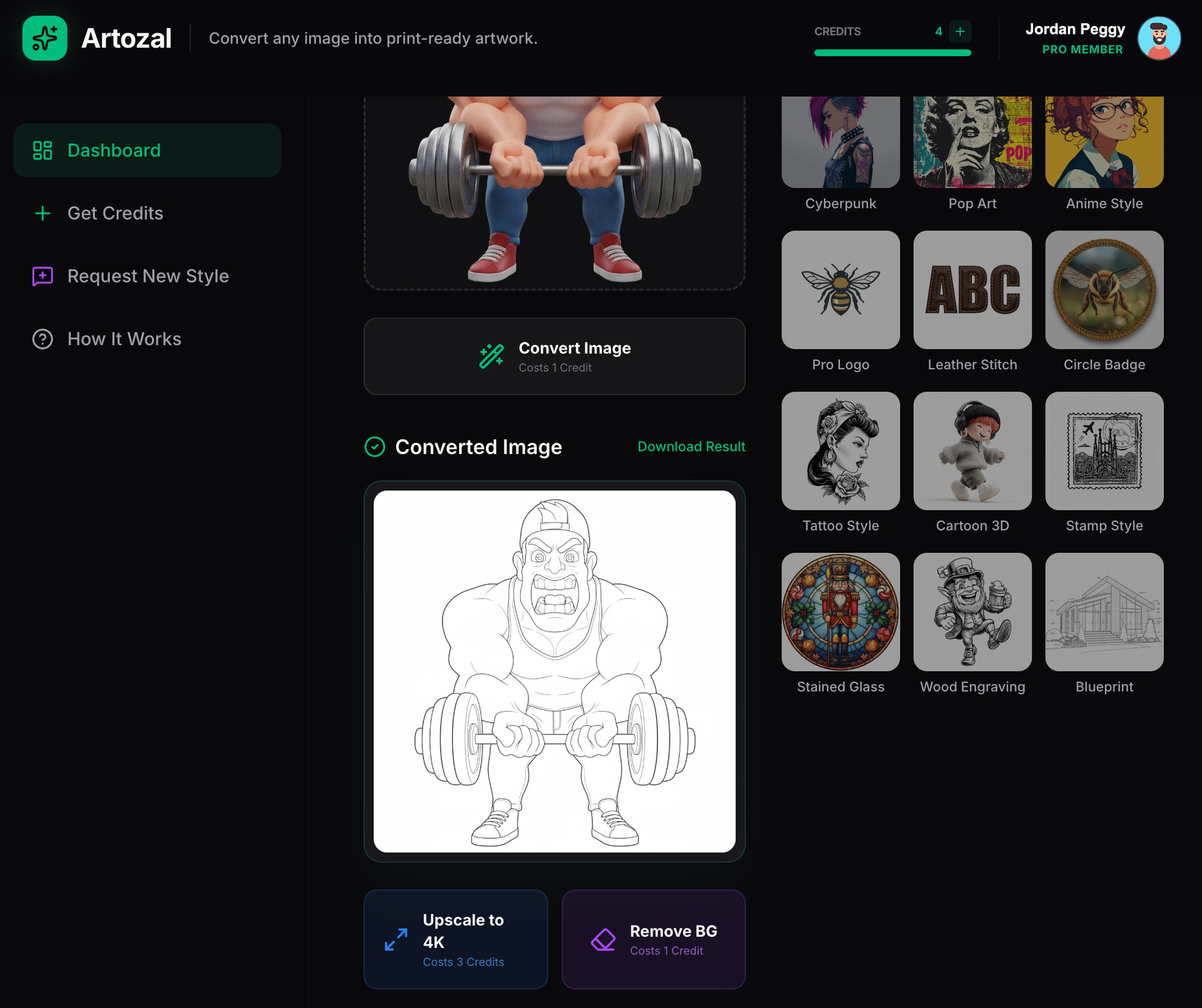

As someone else mentioned about Artozal, I’ve been using it too and really like it. I especially like being able to upscale artwork and remove backgrounds to export Png
s it’s been really helpful for lots of projects. Definitely give it a try and see if it works for you!

Have you tried the newer style for architectural drawing. it does a very good job of producing fine lines but also puts dimensions into the result. I have been using both the line art and blueprint styles for engraving clear acrylic that I give to the relatives for night lights. After conversion in Artozal I trace the png image in lightburn to get a vector drawing and then its easy to remove the dimensions and any unwanted artifacts.
Keep spreading the word about Artozal as i think it has the potential to become a must have application for all types of image conversion that lightburn can cut or engrave. Hope you have continuing good results

I’ve been in ongoing conversations (via email) with Wissam and he’s made some tweaks to the “Line Art” style, with an eye towards making it more laser friendly. He also suggested I run the conversion cycle multiple times, as it will give you slightly different results. What was “Pencil Sketch” is now “Line Art” and it works very well. Yes, I did try “Blueprint” as well as “Wood Engraving” and the each had their pluses and minuses. I did try the photo converter you suggested and it works quite well. This is only the second time I’ve needed a program like this, in the last year, at least I have more options available for the next time.
