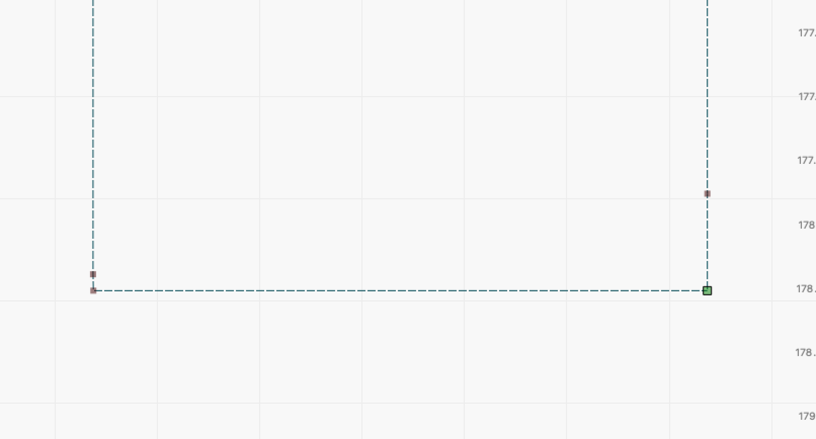

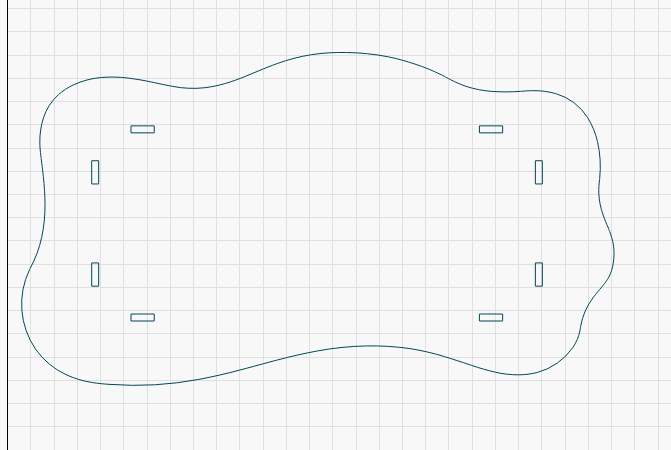

I have selected a number of slots with the shift key and then I should do Convert to path and then Resize slots in selction, but that Convert To Path always remains gray what am I doing wrong???

Can you post the .lbrn2 file for us to examine…?

test.lbrn2 (20.2 KB)
If you “clean” your slots, you will be able to use the resize function just fine.
The function expects 100% 90 degree angles.
then ,How clean the slots???
There are 2 options,
  1. delete all nodes beyond the 4 corners in each slot
  2. draw a new slot and snap it over the old ones, you can easily drag the new one onto its corner and snap it over the old one. If you put all the old ones on a tool layer, it is easier to delete them afterwards.
