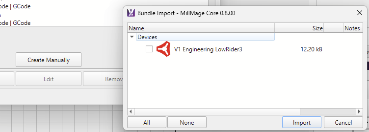

We already have Device Presets for the LowRider 3.
Not sure how much that one differs from your version 4.
I’m not familiar with the attached vCarve *.pp postprocessor. Can you send us a GCode file you generated with this, so that we can investigate further and help you configure the device in MillMage?

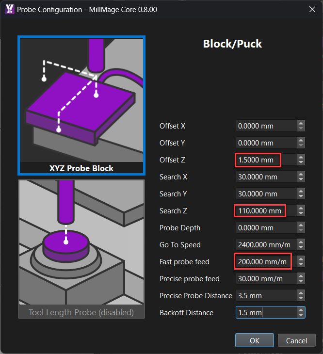

I had a look at that Vetric post. The default LowRider3 profile should still work for you as a base to get started, please Edit and rename it, change the size, and connection method as needed.
Change the probe thickness from 0.5mm to 1.5mm and the probe speed and search distance to match what is in the post

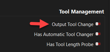

The Vectric post includes some other prompts to handle a tool change. I disabled the Tool Change for my LowRider,
because I prefer to just to selectively enable output for operations, and ‘Process’ as I need to rather than start a job with a toolchange in the middle.
But it would be easy enough to enable and add code for a tool changing routine that is similar to what is programmed in the Vetric post, happy to help with that if needed.

i installed the preconfigure V1 in MM I have lowrider 4 and i than just imported the V1 tool change code into tool change under custom , changing M0 to @P as it doesn’t like M0.
under tool management
output and has tool length probe click to on
it may not be the correct way to do it, but it works for me
