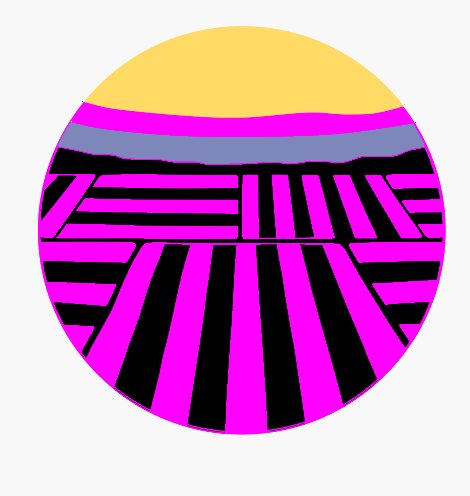

Try This One. The whole design is there but you will have to shade the design elements individually, SVG files do not contain shading information. Still some work to be done but its doable. I would put the whole design into one cut/layer and start from there. Going to be a challenge.

I see 5 different colors.
You can play with the sliders on the image control panel and on the trace panel. Try the sketch trace option, also.
You can use multiple instance of TRACE, so get some results then move sliders to get another set of different results
Put each color on a different layer. Set the layers to different scan angle and scan interval and power levels to achieve different looks. You may even like one layer done on OFFSET fill as those layers often to.es have a patchwork effect.
