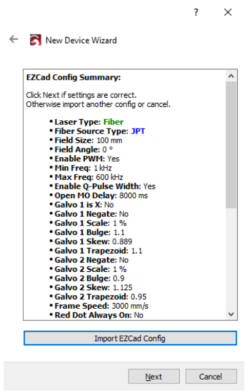

If you import the correct config file, you should see a summary similar to this:

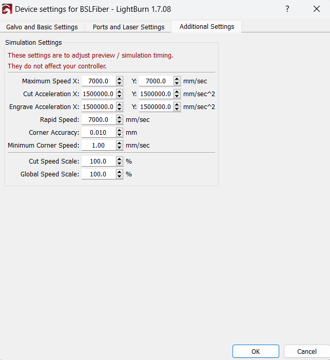

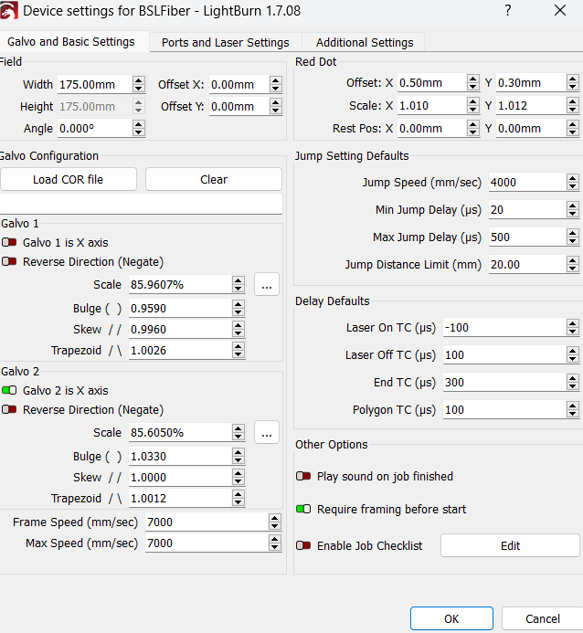

Can you send us both .cfg files and screenshots of both tabs in the Device Settings?

Yes. I will in a second. I’m actually uninstalling both lightburn and the laser and reinstalling in case I did something wrong. Quick question, do I need to also put in the parameters and info in the MPLaser if I don’t plan on using it. I only want to use Lightburn with the laser. Thanks

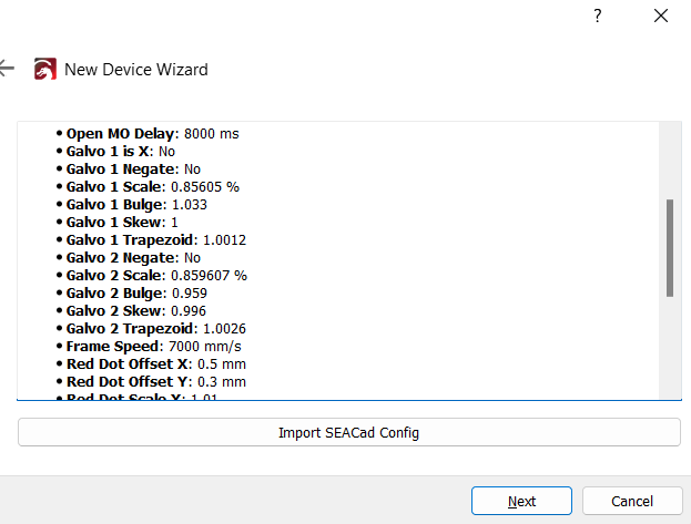

Okay. I did the resetting of it vs installing. I’ve got all the settings imported into lightburn. I haven’t done the 9 point correction yet though. I want to make sure all of these are correct first. I’ll upload the snapshots I’ve taken. Thanks

We can’t see the first part of the summary of the import but it looks quite complete. I’m guessing, this was the LmcPar.cfg?
The other screenshot of the summary showing the Jump Delays and Timings is then probably the BslCAD.cfg. It’s not currently possible to load both files in LightBurn (We are working to change this) - Did you manually enter them in the Device Settings or were they included in the other config file?
Before you do the 9-Point Calibration, engrave a rectangle of 150x150mm and measure the result. - The config file you loaded already populated the Scale, Bulge, Skew and Trapezoid values, and you might not even need to calibrate the lens.
