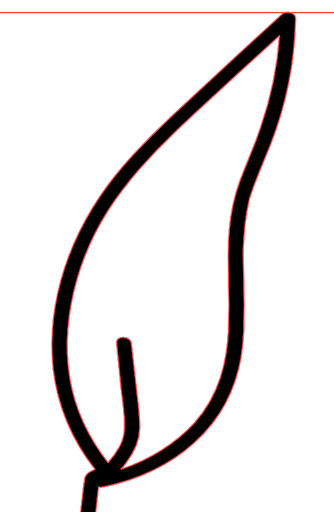

I would like to know if there is an easy way (either on lightburn or illustrator) to convert a shape into a single stroke/line ?
Here is an example :
This is an object, and I would like to make a single line out of it like this (drawn by hand in this case) :
Is there an automated way to do that ?
For the record I want to cut a single line at really low power instead of engraving, to save time doing a product.

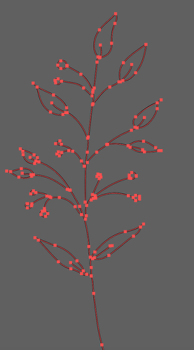

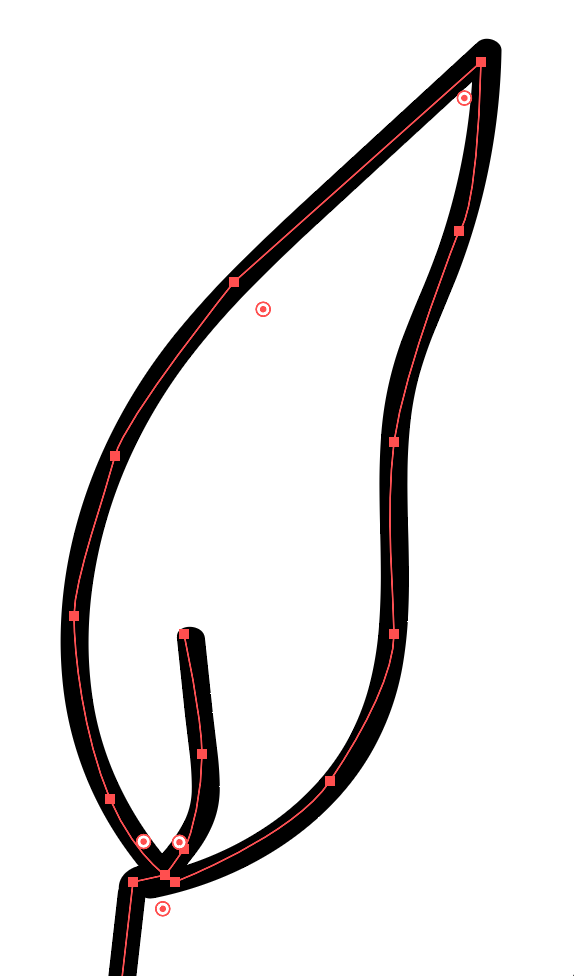

After hours I finally found a solution that suits me on Illustrator :
Rasterize - then image trace → Line art —> Expand.
Here is the result !
