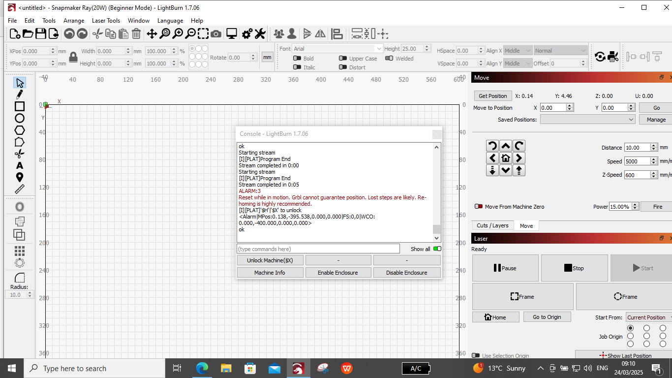

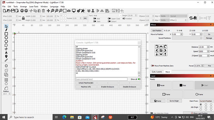

If I press Home button in move window it moves to Back-Left corner - Pulloff 2mm - Alarm 8..Homing fail.
Press $X to unlock.
Press Arrow-Right - moves right 10mm - Repeat and it moves another 10mm.
Press Arrow Left - Moves left 10mm.
Move position X 0.00 Y0.00 - Moves to front of machine - Alarm 3..Reset while in motion
I’ll just tether the phone and switch to laptop so I can send a screenshot.

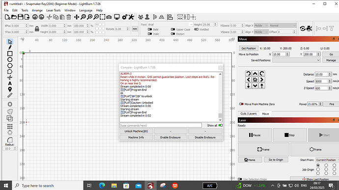

I input X10 Y250 to move window and it Alarmed…I Unlocked and pressed Go again..and it moved to that location with no alarms/errors
Its like the Home button thinks Home is back/left of machine but Get-Pos & Move to think X0 Y0 are at the Front of the machine.

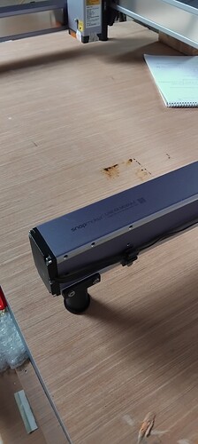

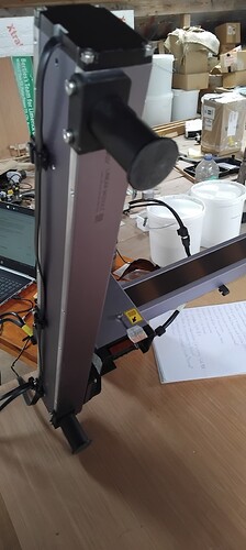

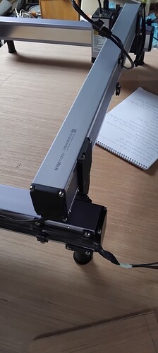

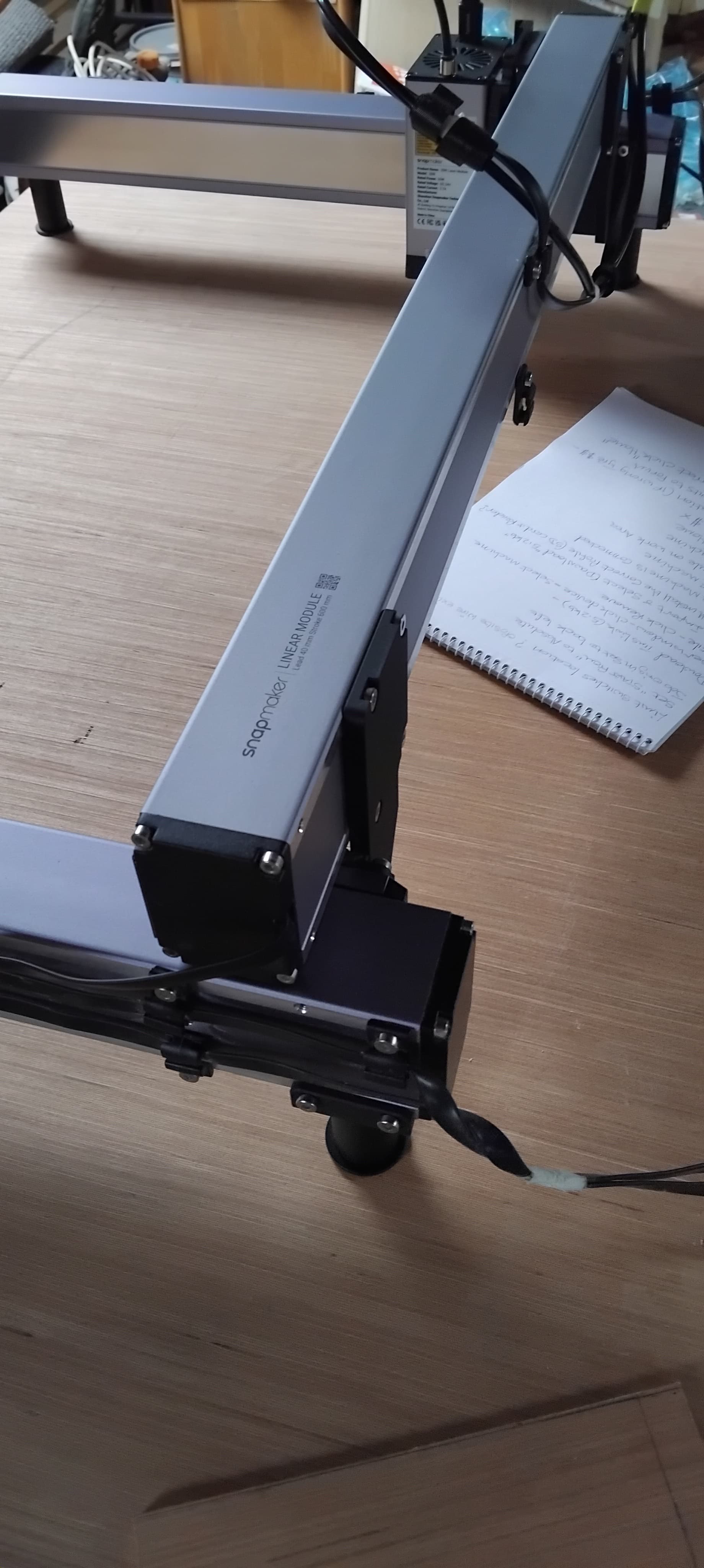

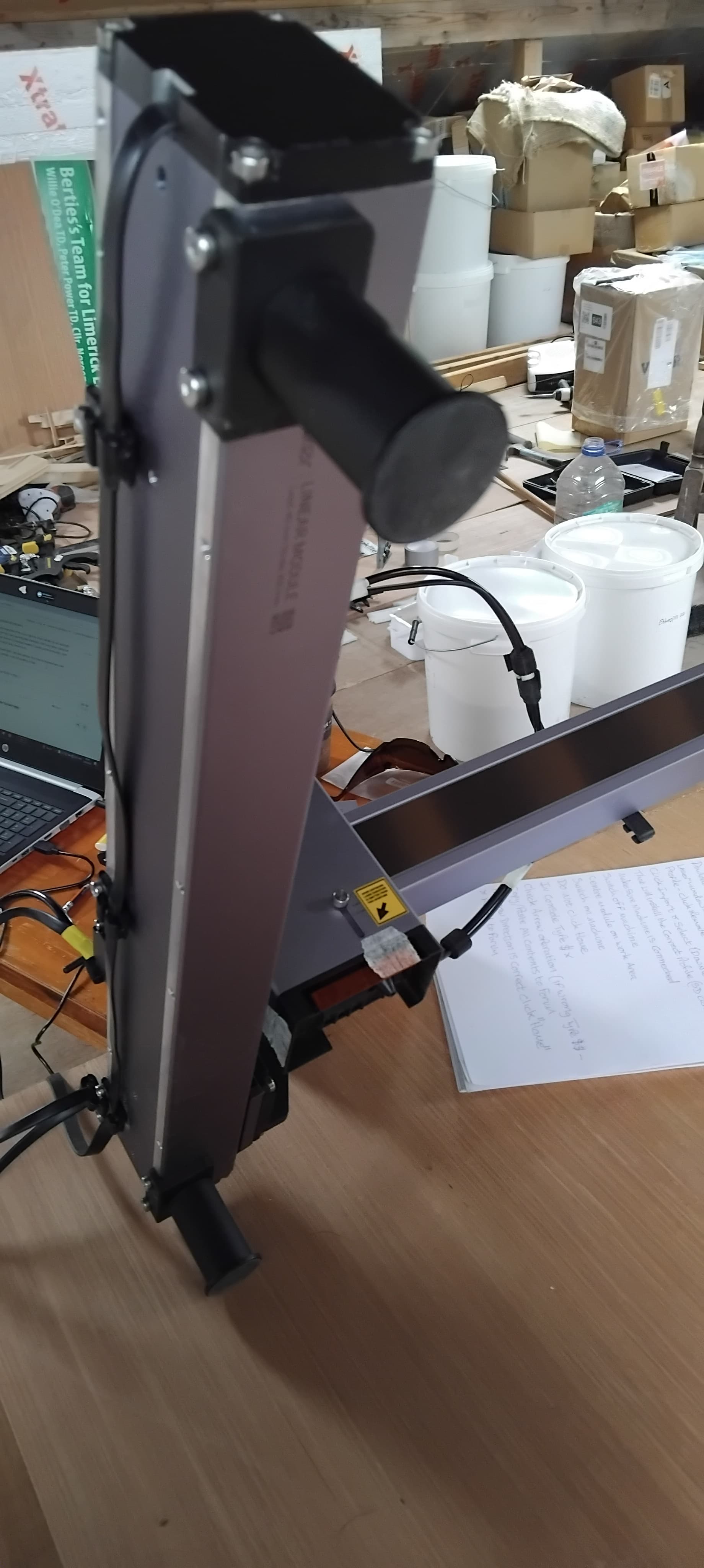

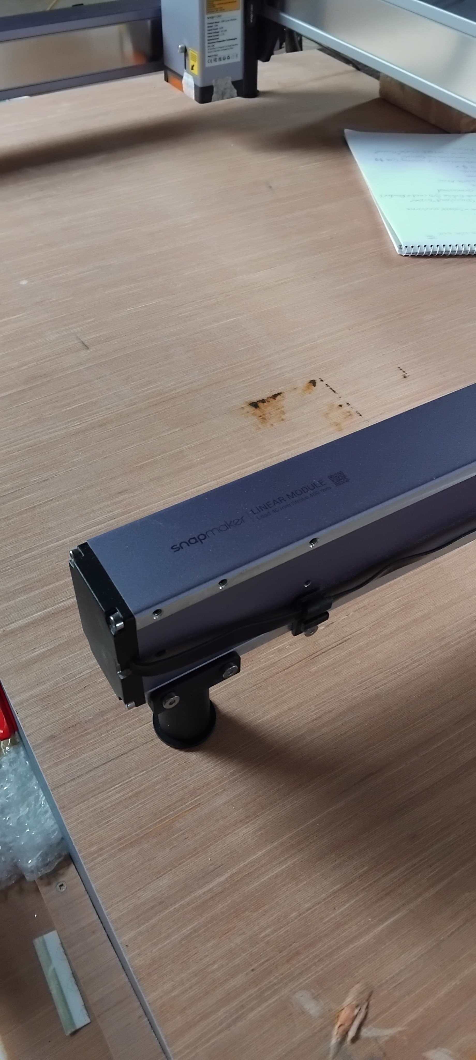

When the machine arrived I had two identicle Y axis…like same in every detail, which means I got two lefts or two right hand Y axis that would not mirror each other when fitted.
I asked on snapmaker forum and was instructed to position the left hand axis upside down, which was massively counter intuitive in how it would fit. It did eventually, but it was hard to understand how it could be sent out like that.
The SM logo is on the underside instead of topside!
Do you think that an upside down axis would work just like a right way up axis? the upside down axis is also on the left side, where I assume the limit switch is supposed to be…but would it have a limit switch if its really a Right side Y axis.
Its bugging me how this thing didnt work when set up as its so well made. I have asked Support about it today and I’m also sure the guys that gave me the workaround would have mentioned further issues.

Yes, but I could not bring up a mental image of what you described. I expect I would need a Snapmaker machine to make sense of it. Sorry that is all I can offer.
No problem, I couldnt figure it or picture the workaround with the machine right in front of me, and I did argue with the SM forum guys about it..but they were right.
I’ll photo it tomorrow, cause its a real curiosity and SM may have rreplied by then with some insight.
That’s interesting. I would think the two y axis would be different. They should be mirror images of each other. There would be no wiring to the one on the right. And there would be a limit switch on the front left of the Y axis. Usually its underneath. Wherever its at if the carriage is moved all the way to the front it should activate the limit switch.
Found this on line. Assembly instructions if this is your machine. Does look like the Left and Right Y axis are identical except for the X axis mounting plate orientation. Both have cables coming out of them and on the controller there are 2 connectors marked Y. Looking at the instructions i don’t see anything to mark where each Y axis connectors go.
From what i can find the Left and Right Y axis look identical. But it may be important which one plugs into which port on the controller. I cant find anything on that
The Snapmaker support reply confirmed that both Y axis are identical and that the logo being underneath is normal and also that the limit switches are positioned oposite end to where the control wire exits the axis body. So that means the limit switches are positioned at the Left end of X axis and at the Back of the Y axis.
The ports for both Y axis into the controller have no marking for L/R and nor do the cables, so whether it matters and how it works would be best explained by someone qualified.

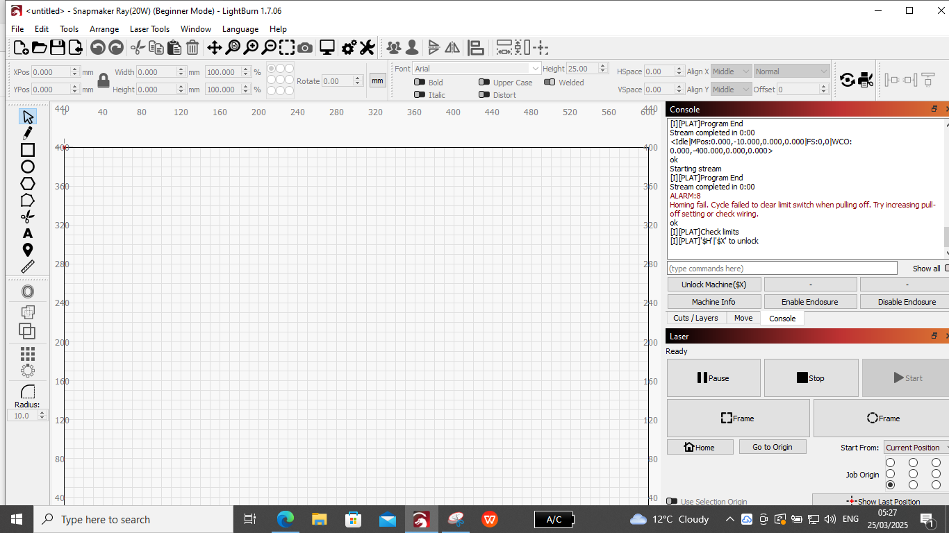

I pressed Home symbol (centre button) in Move window and the laser head traveled to the Back Left, Stepped out 2mm and Beeped with Error as in pic.
Please do me a favor and maximize your Lightburn window. There is information that is not on the screen.

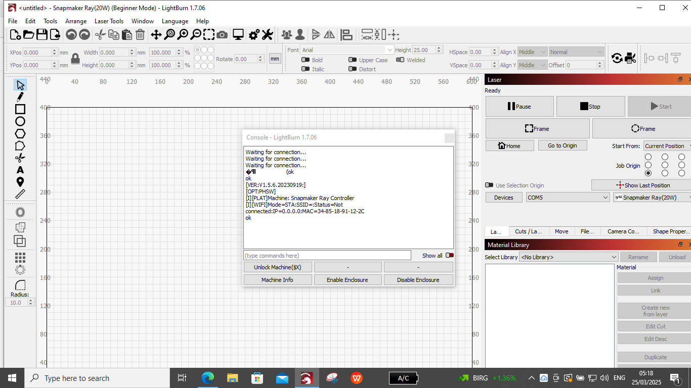

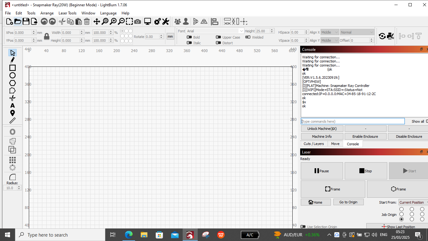

Just confirming that you installed the profile file I sent and now the laser moves in the correct directions with the arrow keys.
I see from a previous post you have been in contact with Snapmaker. What do they say about your homing error?
Type $$ in console and copy the entire output here.
