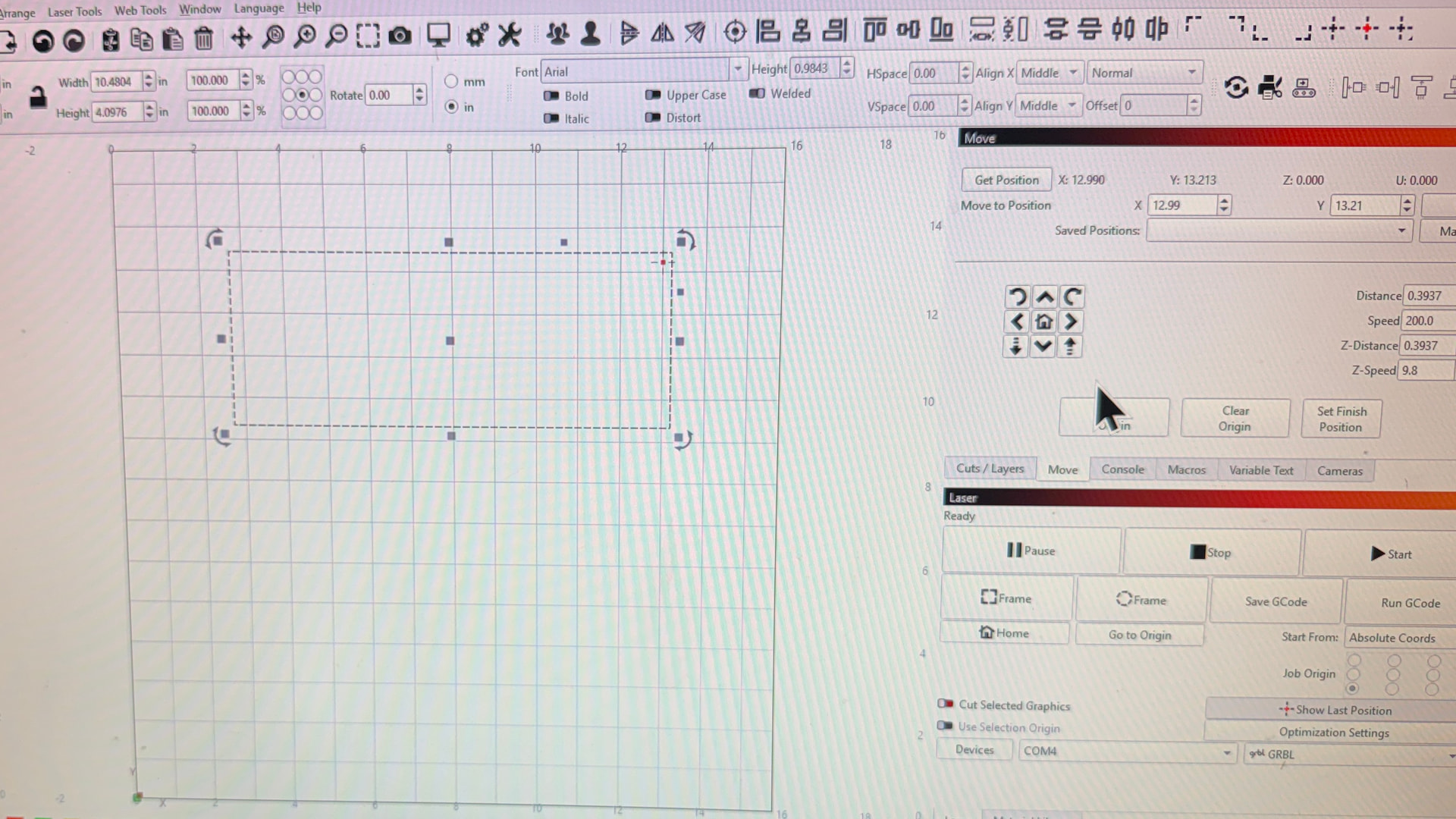

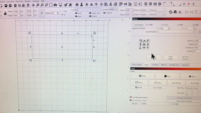

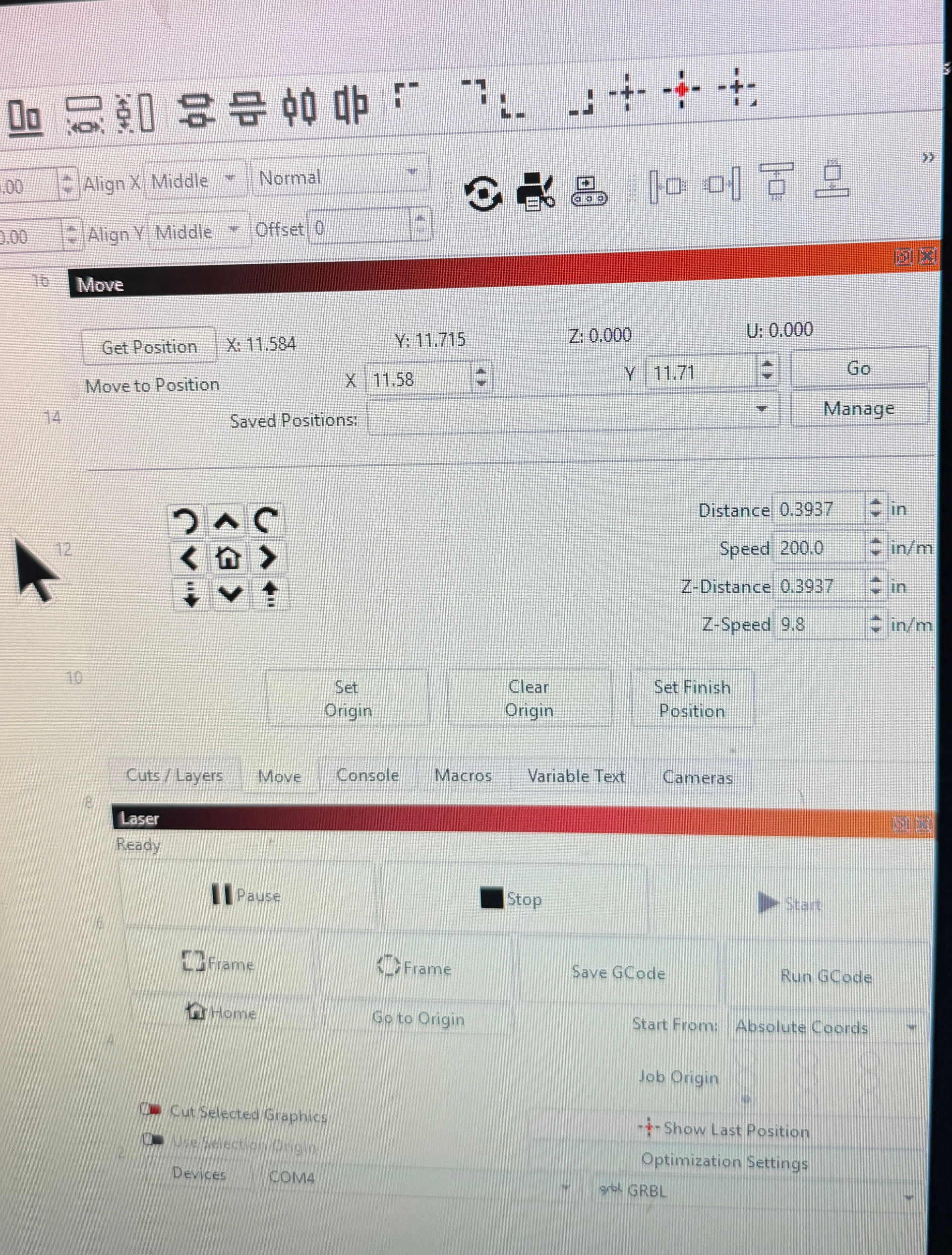

I am using Lightburn 2.0.0. I was using 2.0.3, This is occurring in both versions, but I have had less trouble in 2.0.0. This all started with my homing not working and when the laser would “home” it would get a horrible grinding noise and stop. with an alarm 1. and tell me to rehome. That never worked, so I went on to Use Origin, which seem to work for a while, then today. all coordinates started being totally off. That was using 2.0.3, so I uninstalled and went back to 2.0.0 and things are the same in that version as well. I am using a Laser Tree K1 Pro 30W Laser Cutting & Engraving Machine which is on their frame, etc. I have only had it since the end of January. I have disabled Home in order to not get the grinding and User Origin was working well yesterday, but today is when the mess with the coordinates started. The laser would be in the bottom left corner, and as you can see in the images, it does not show that it is even close to x=0 y=0. I am using Windows 11. I am trying to figure out how to post the screenshots.

Your screen pic shows absolute coordinates. The only way this will work is if Lightburn knows where the home location is. If you have homing disabled in firmware, the laser position when you power it up becomes the home location. Place the laser head in the front left corner before turning it on and Lightburn will call that the 0,0 position. From this point on don’t move the laser head by hand. Only use the jog controls in the move window or the location pin in the main workspace. But, getting your limit switches working properly is the better path.

Yes the images showed absolute coordinates, but that was just showing what the stupid machine was doing…nothing to do with how crazy things were. I got those numbers when I had the laser at the bottom left …and hit the get position. That is why…
