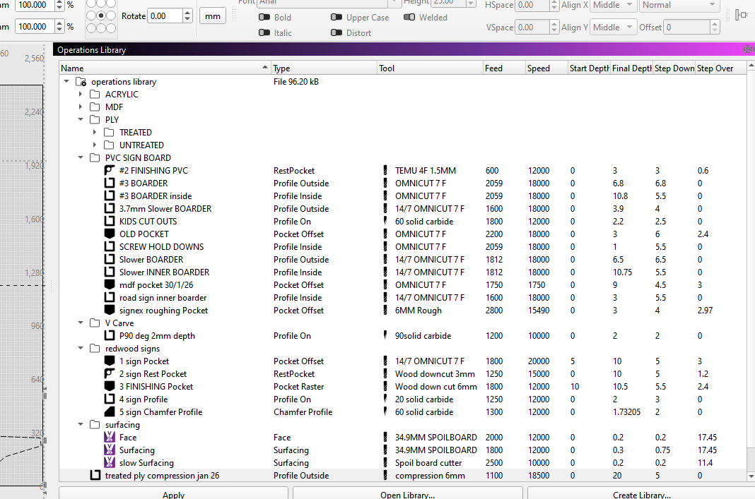

IF im reading this correctly you want operation not the file ?
The only way I can think of, is right click which operation you want to transfer, click save to library (bottom of tab ) once you save it it always there, saves so much time when do repetive materials
in new window open operation library tab, click on said operation , highlight item you want operation to be assigned to and click apply
I give each saved operation a name and save in files like below
after typing this just realised operation tab is assign. operation library is apply ,never clicked till now they are not the same , doesn’t bother me being different I’m used to it, but may be confusing to others, there will be a reason behind it I’m sure :slight_smile:
