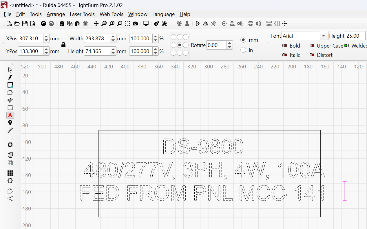

I’m using Lighburn Pro 2.1.02 recently updated, but the issue has been persistent before the latest update. When selecting boxes of text and pasting over to LB, it adds 4 spaces to all lines except the bottom one. I keep having to go back to each line and remove the spaces so the text is centered in my space. Has anyone else noticed? anything I can to do mitigate?

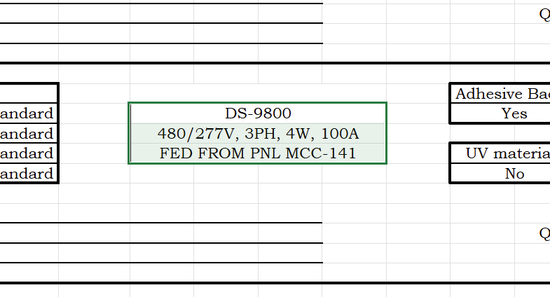

Example below: I selected the three boxes and hit ctrl+C, The text is centered in the square in LB, but when I paste (Ctrl+V) is adds 3 spaces at the end of every line (not 4 sorry). That pushes the text off center, I need to go through and remove the spaces to each line.
If you can please paste your excel or docx file into your reply so we can investigate.
Interesting. When I copy and paste from Excel to LB I get a bitmap image.

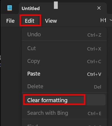

Also, in the new Notepad under the Edit tab there is a option to Clear formatting
Really??? That kind of negates the whole concept of Notepad.
Thanks for the heads up on that one.

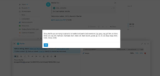

I can’t upload excel files. File format not authorized by this platform. I’ll try DMing you guys
Append .txt to the end of the filename
Remove your email address, unless you collect spam for a hobby.
Testing the company firewall. Might do it some good
That didn’t work. same error msg
So I can’t upload .xlsx file . I tried recording a screenshot showing the issue, couldn’t do that either.

This is the error message
