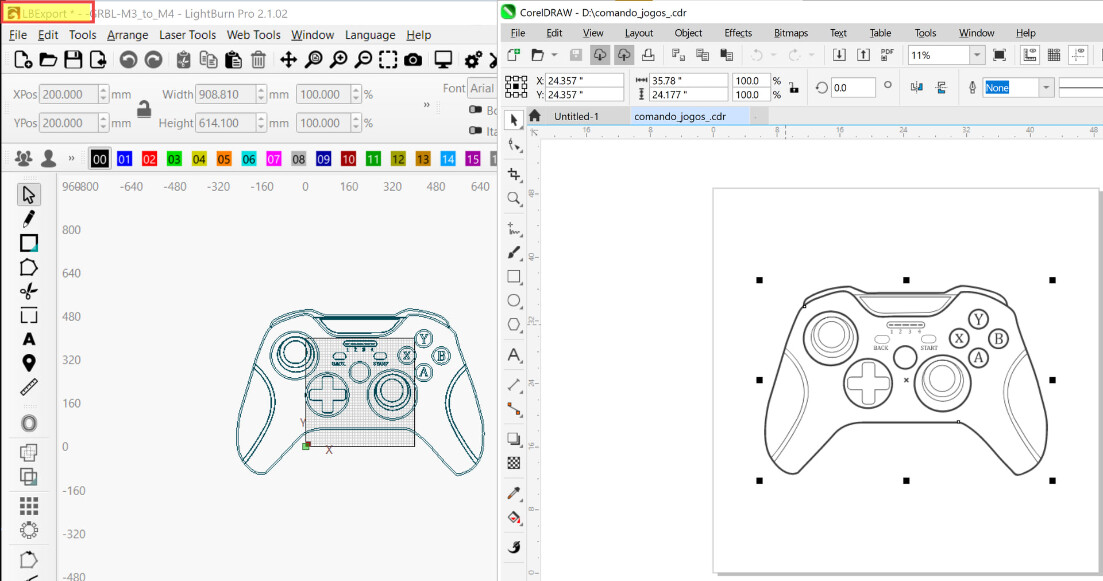

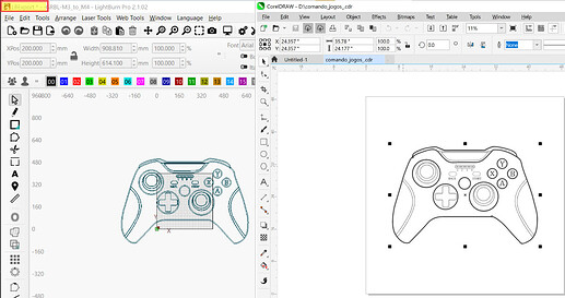

I´ve Corel Tech 2024 and it works with 2.1.02:
