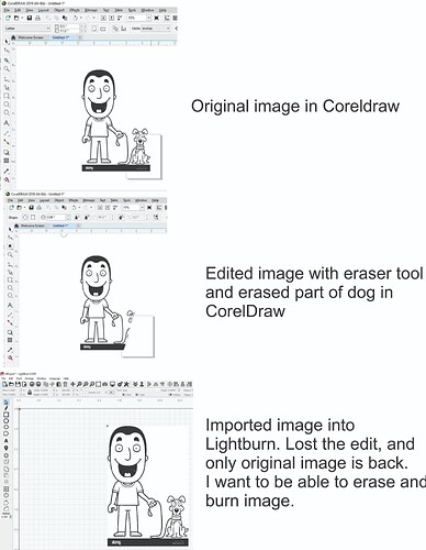

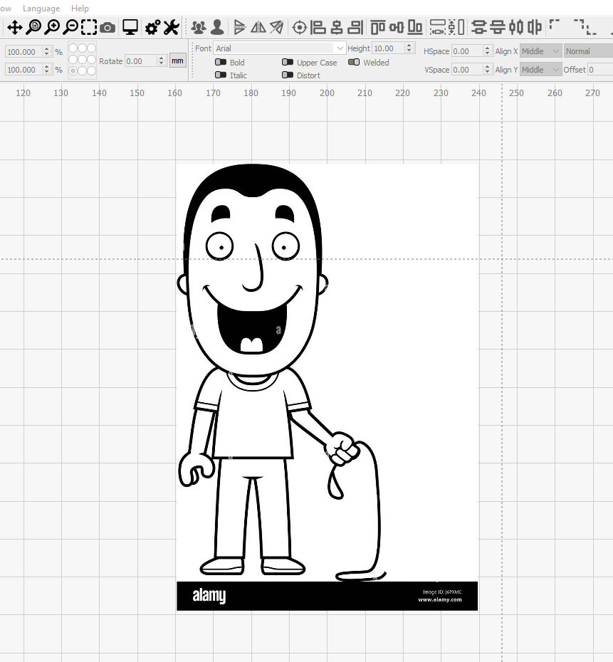

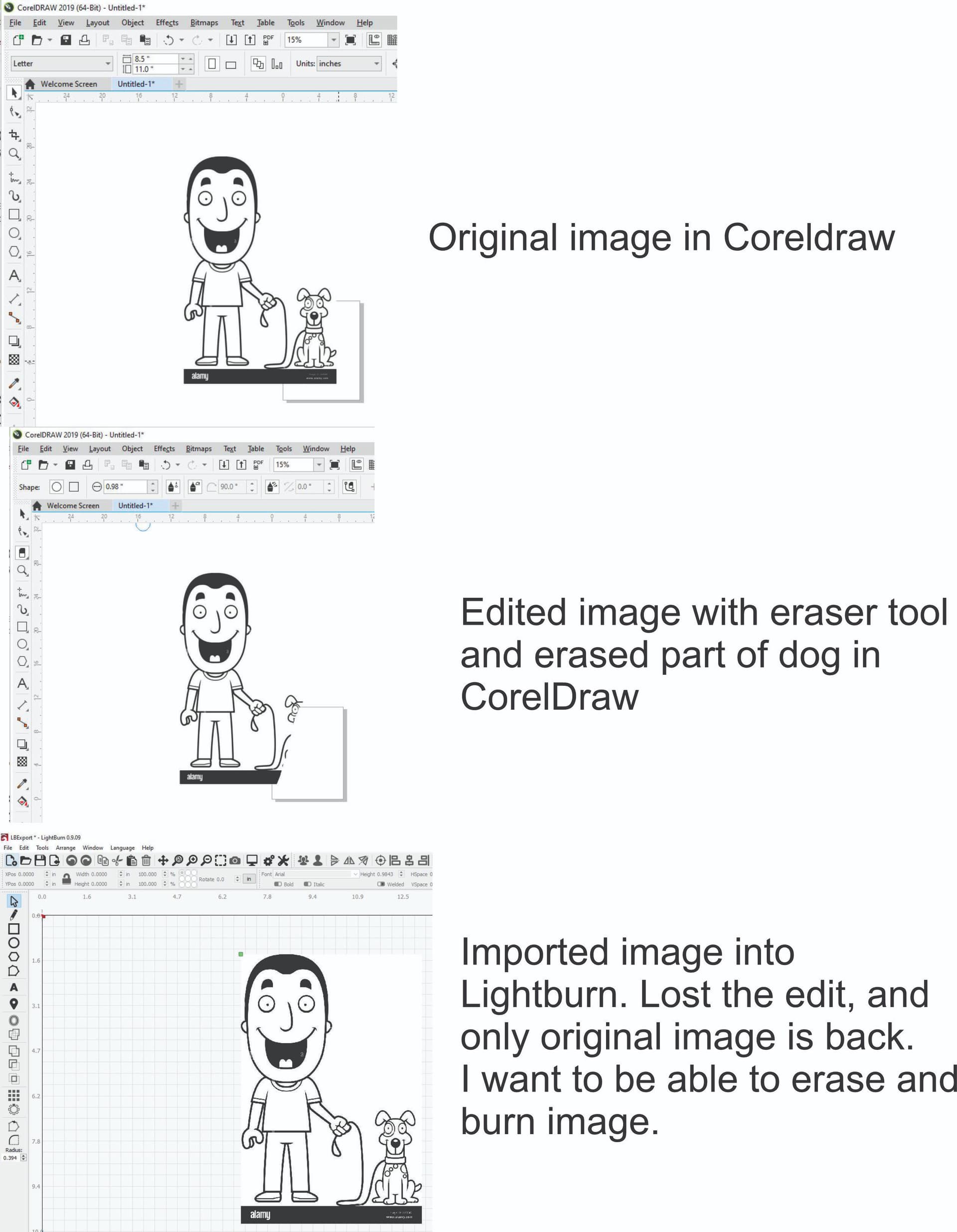

Hello~ When I edit an image in Coreldraw and upload to Lightburn, my edited image does not show up. Example: If I had an image in Coreldraw of a man and a dog. I use the erase tool to remove the dog. Then upload to lightburn, the dog is still in the image. How do I permanently erase parts with them being imported?

I want to be able to edit or erase parts on an image and burn . See example.

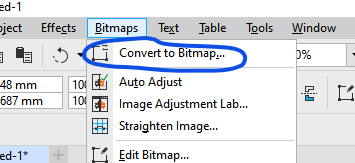

I’ve had a little play and it looks like the eraser tool actually creates a mask on top of the image. I’m guessing that doesn’t get transferred via the background export/import process which uses a temporary AI file.
There are probably several ways around this (including tracing the image to vector) but if you perform a ‘Convert to Bitmap’ after using the eraser, and then use the Corel/LightBurn macro to transfer it over it comes over correctly.
It look like this may solve my problems. I will give it a try. Thank you for the help.

This worked and saves my issues. Thank you.
