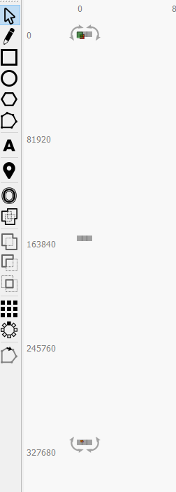

Hi Timothy,
I get a message about a missing font, but otherwise it opens fine. Nothing is “on the page” though - it’s all off to one side and about a half-mile below it (not much of an exaggeration, either):
This is the stuff closest to the page:
Zoom waaaay out though:
And all this stuff is 327 meters below it:
Do you use “Import” instead of “Open”, maybe?
“Import” is for importing stuff into your current project. “Open” is to open a new project, replacing the current one. Unless you intended for all this stuff to be there, that’s the only way I can see this happening.
All that stuff waaaay below the main drawings must be something I attempted to import sometime back. Sometimes, when I do import (to intentionally bring in other objects - I do not attempt to use Import to open files), the files import somewhere way off the main items on the page - so far away that I cannot ever find them.

When it crashes, do you get a crash dump at all, or does it just shut down? If it gives you a dump of some kind I’d like to see it.
I’ve sent you the updated version by email.

I’ve re-sent it in a new message.
Received and I can now open the file.
