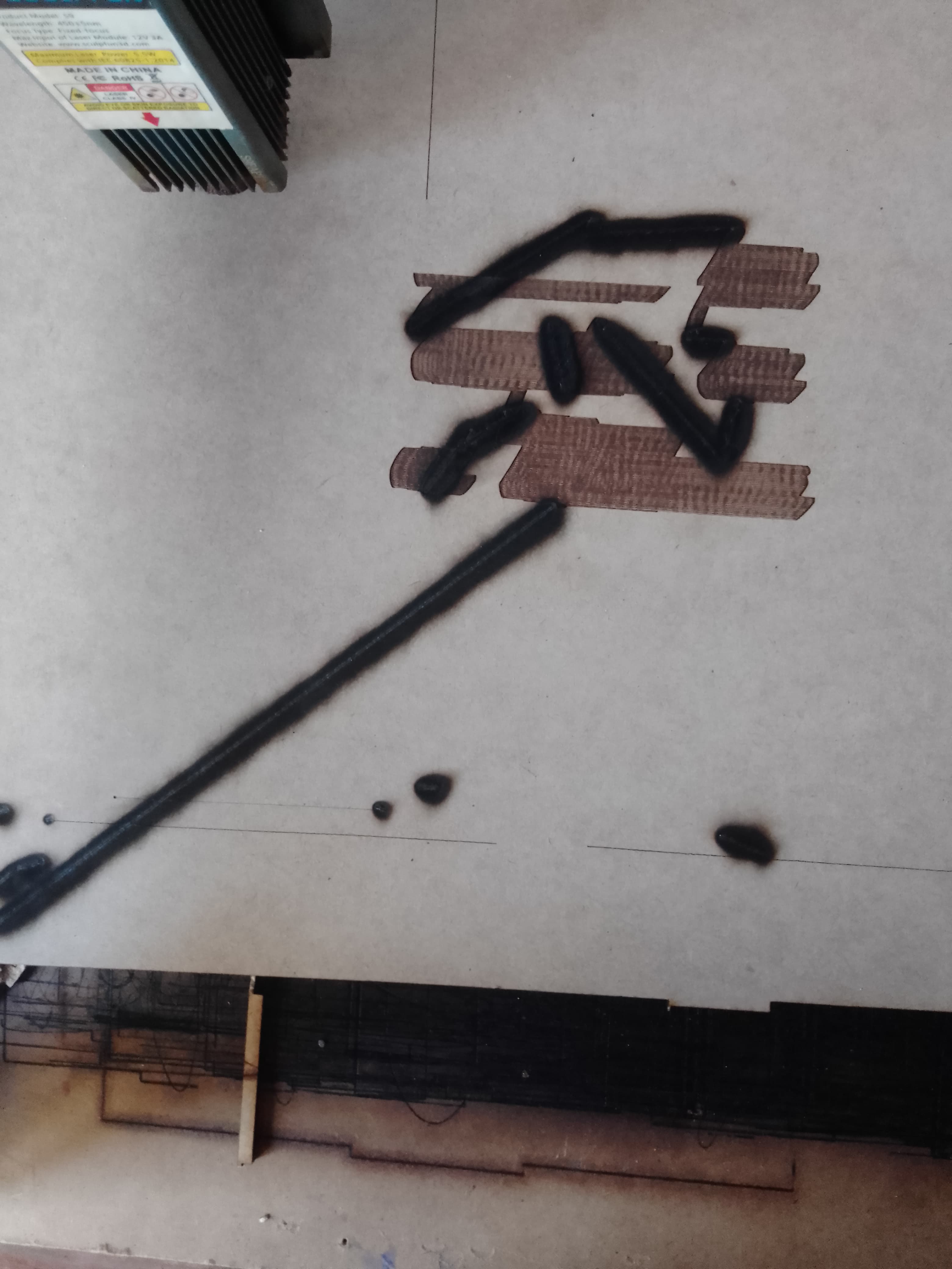

Porque corta el recorrido ya puse el valor del dólar en 32 y lo puse en verdadero y sigue igual

Are you saying it burns lines while traveling to the intended burn areas? Can you upload a picture of this?

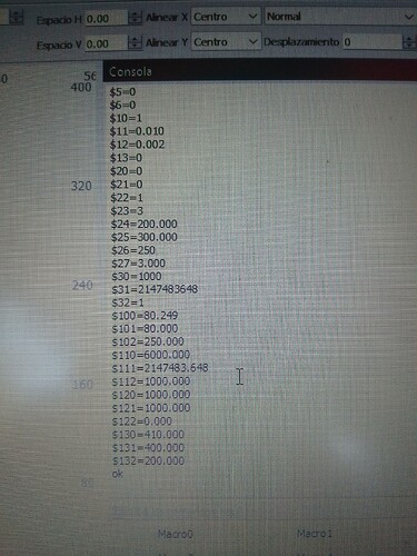

Enter $$ in the Console window and verify that you see $32=1 in the list. It is possible it did not register in the GRBL controller.

Please open the Console window in LightBurn and request two reports by typing the following:
$i
press Enter after each request.
Please select and copy the text from the Console window in LightBurn into a reply here. this will tell us which GRBL should have been selected and how the laser is set.
It is possible that you have a Firmware that resists changes from the user and resets them when power is turned off and on again.

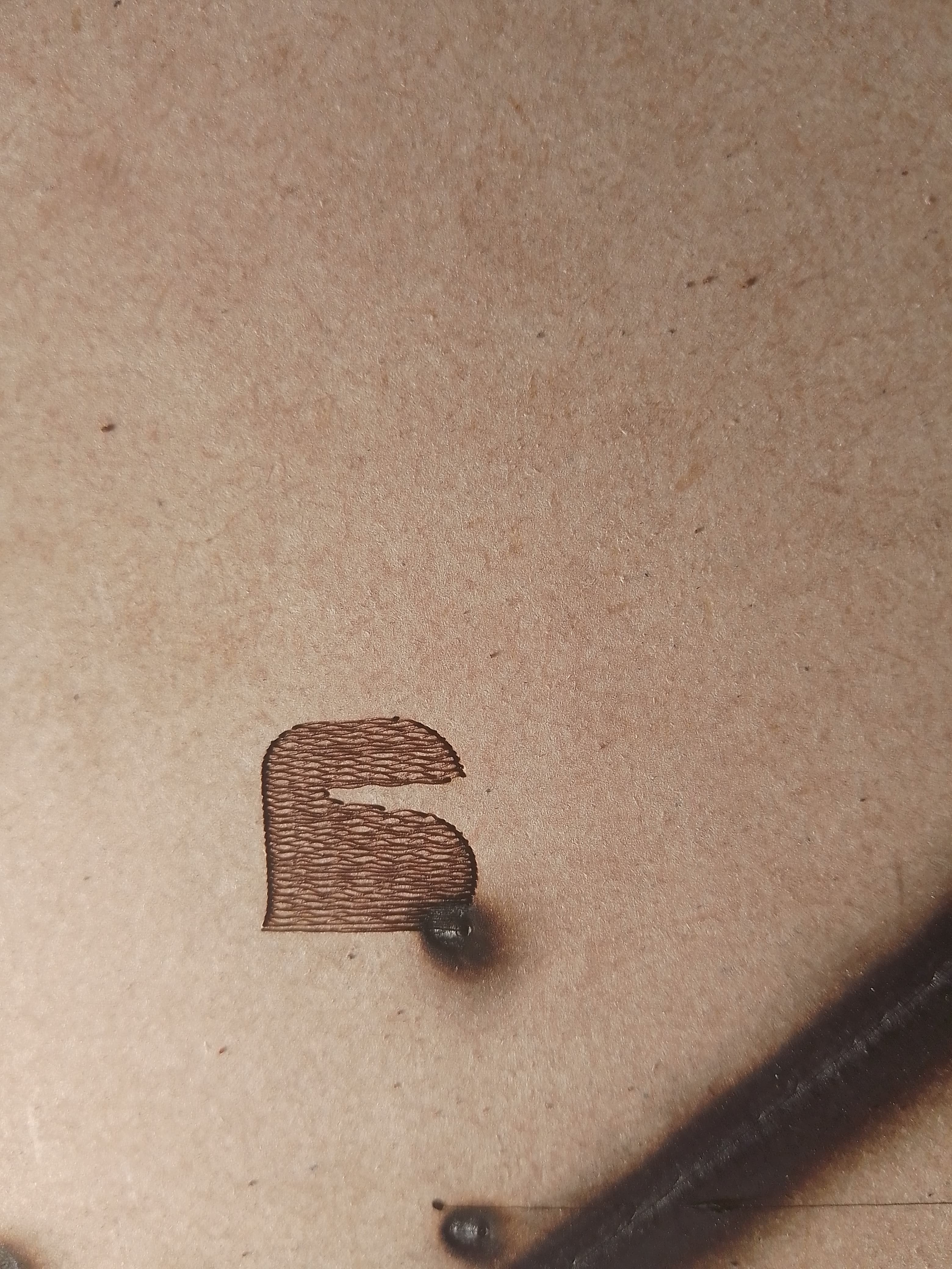

Intenté realizar una letra a ,en modo de relleno y la realizo de esta forma ,primero quemó el recorrido a máxima potencia y después deformo la letra
I tried to make a letter a, in fill mode and I do it this way, first it burned the path at maximum power and then I deformed the letter
Please type the following commands into the console Window pressing enter after each one.
$31=1
$111=6000
2.147 Million is a very strange number for those.
This may be of interest: grbl/doc/markdown/settings.md at master · gnea/grbl · GitHub
For your letter A test. Please click File, then click Save GCode and save it somewhere easy to find. After that, change the file type by adding .txt to the end and upload that file here (the same way you added the picture).

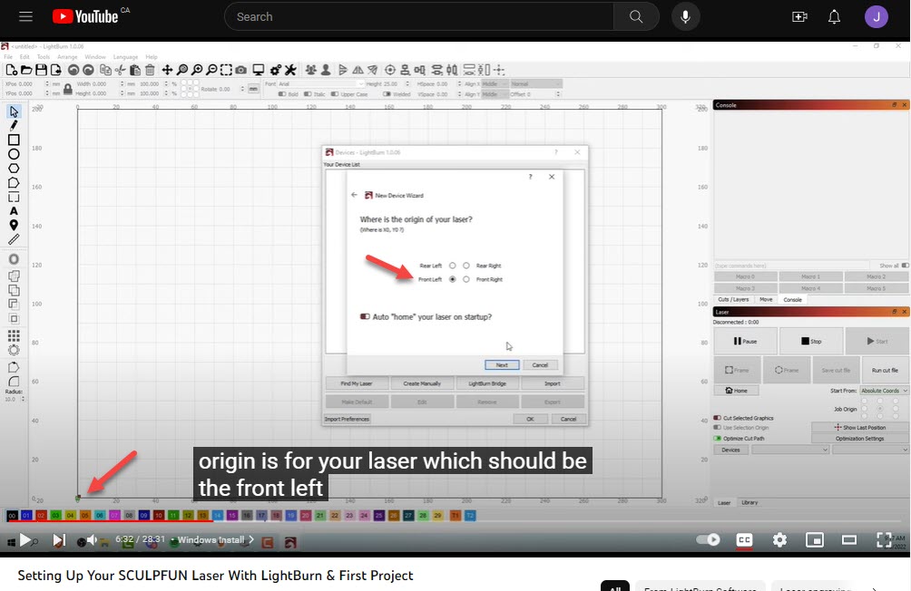

Gracias por su ayuda la verdad es que va muy bien las configuraciones que me han dicho que haga ,ahora solo invierte los objetos al momento de grabar o cortar
Thank you for your help. The truth is that the configurations that they have told me to do are going very well, now it only inverts the objects when recording or cutting

The reversed, mirrored or flipped engraving is often caused by selecting the Origin incorrectly for the engraver.
If you are seeing engraving that is inverted Light-to-dark please save a copy of your project file and change the end of the file to read .txt and upload it here.
