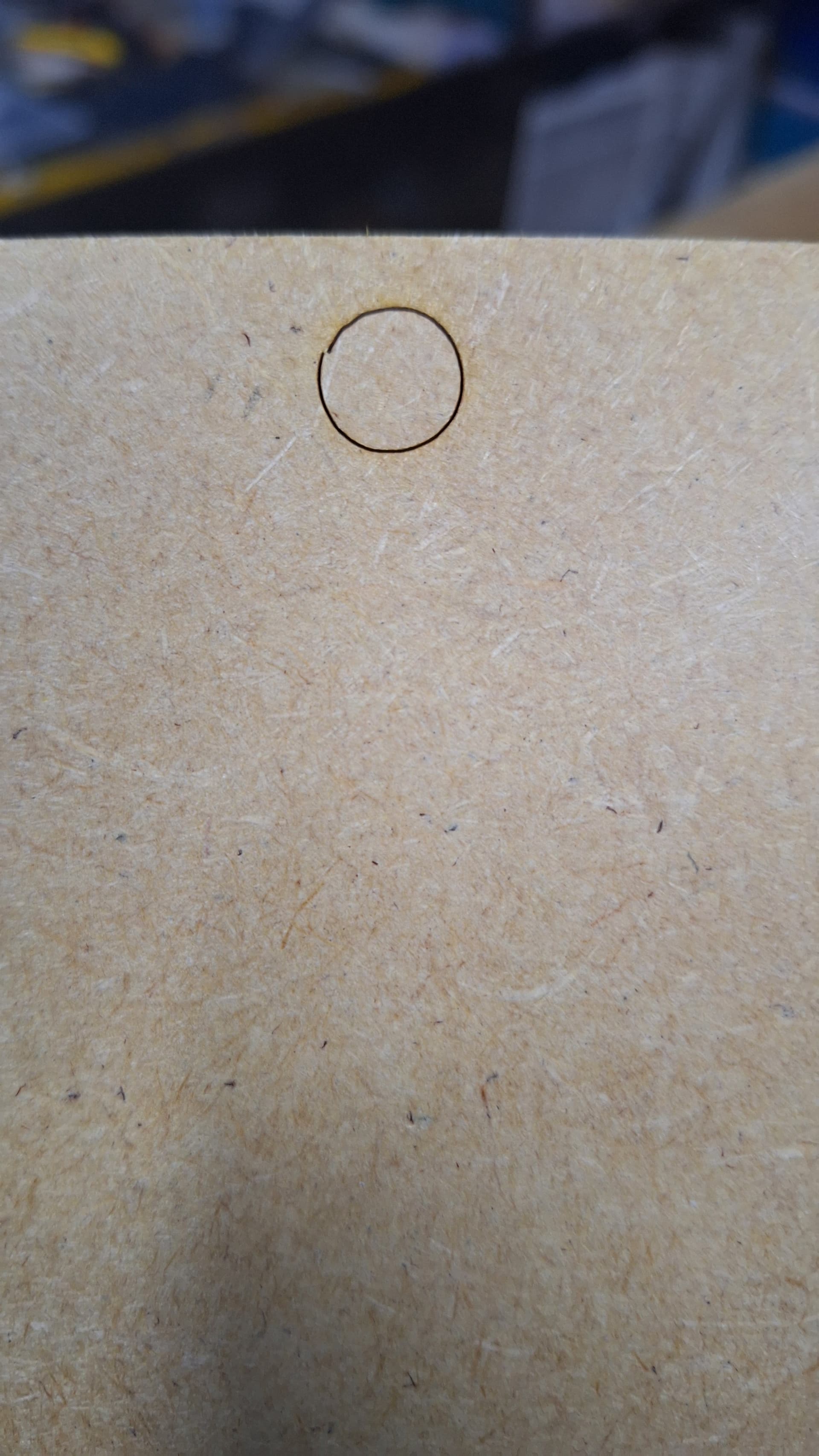

Tengo tarjeta mks dlc 32 y en cortes rápidas no termina el corte o no cierra, quien me podría ayudar
That sounds like a mechanical issue, but we need images to help understand.
Definately mechanical. Most likely a loose shaft coupling or pulley.
Do not stop if you find something, check everything.
Sabes que me he fijado que al momento de disparar el láser hace pausas en las esquinas, es decir el láser no es constante, como por ejemplo en una letra A en cada esquina realiza pausas
You know that I have noticed that when firing the laser it pauses at the corners, that is to say the laser is not constant, like for example in the letter A it pauses at each corner
That may be normal. It has to slow down to a stop, then change direction and speed up. Variable power is used to minimize the burning in the corners.
Concentrate on fixing the mechanical issues first.
