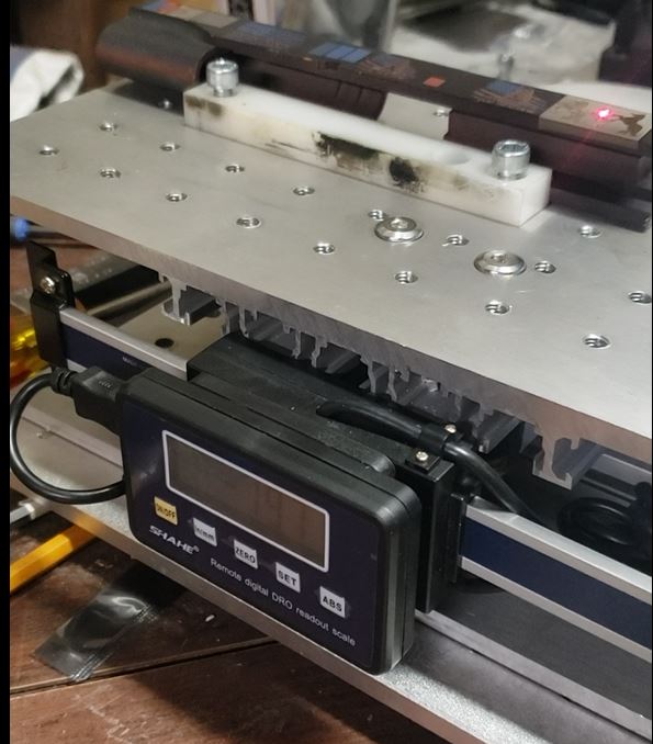

Prototype table I used for testing. Next one would be a lot longer. Yes, microstepping. Ballscrew setup but probably need to spend more money on the ball screw and and add some quality rails to really be a player.

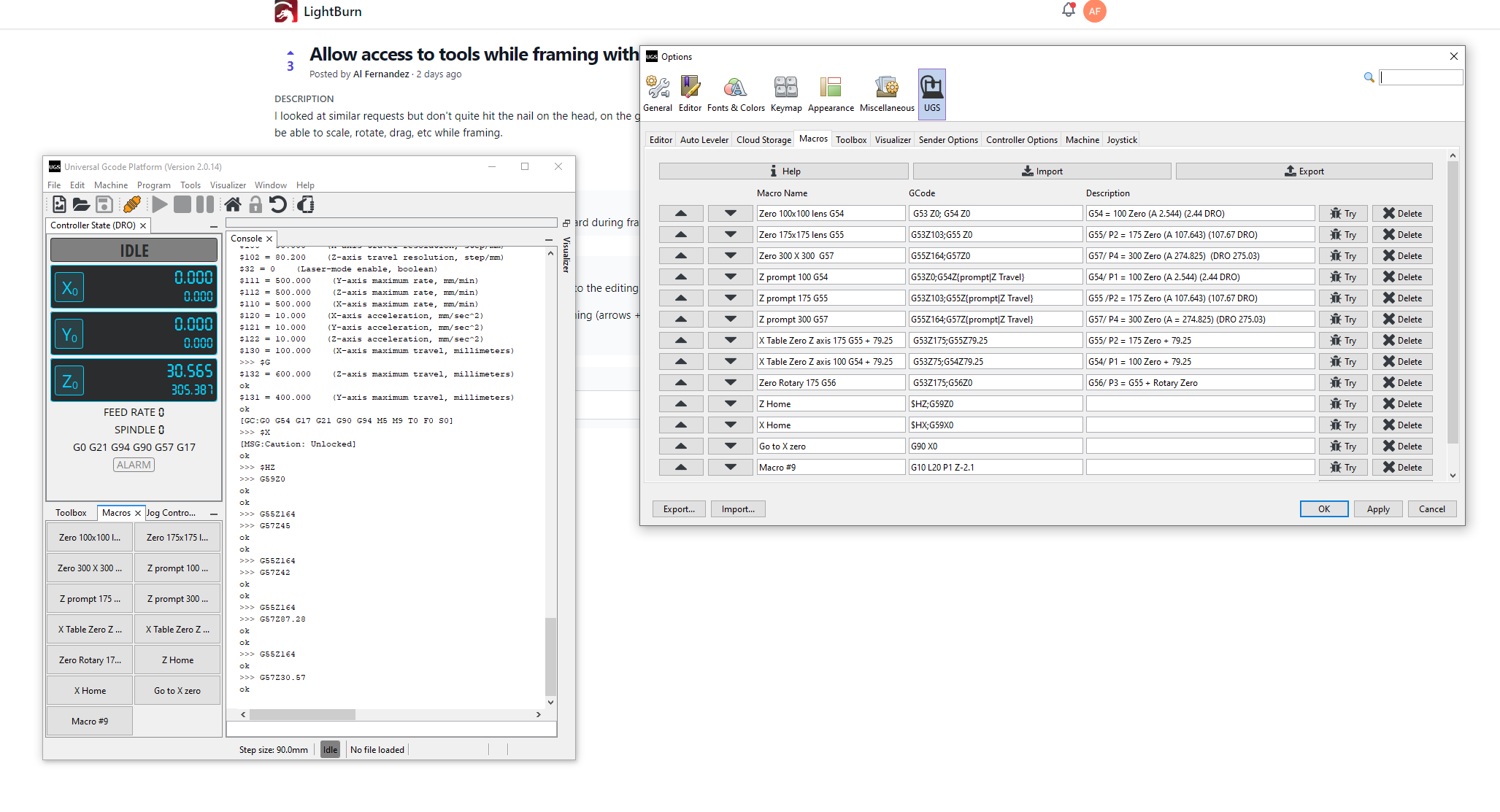

Running it with Universal G-Code Sender and a Uno board for now. (Also run my motorized Z axis with the UGS) DRO as a backup and make calibration easy.
It would be nice to see LB controlling both.
