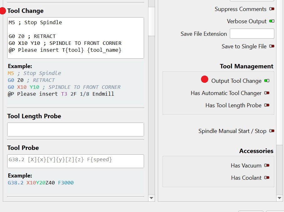

You can absolutely use “Tool Number” to reference your bits. Just make sure to disable “Has Automatic Toolchanger” in the Device Settings here:

Here is my version of the manual tool change:
Thanks. Curious shouldn’t the Z perhaps home to full retract to allow room for the tool change?
Fair question. But you have to stay off the switch. Unfortunately, the difference between Zzero, which you set based on material height, and Zhome is a variable.
