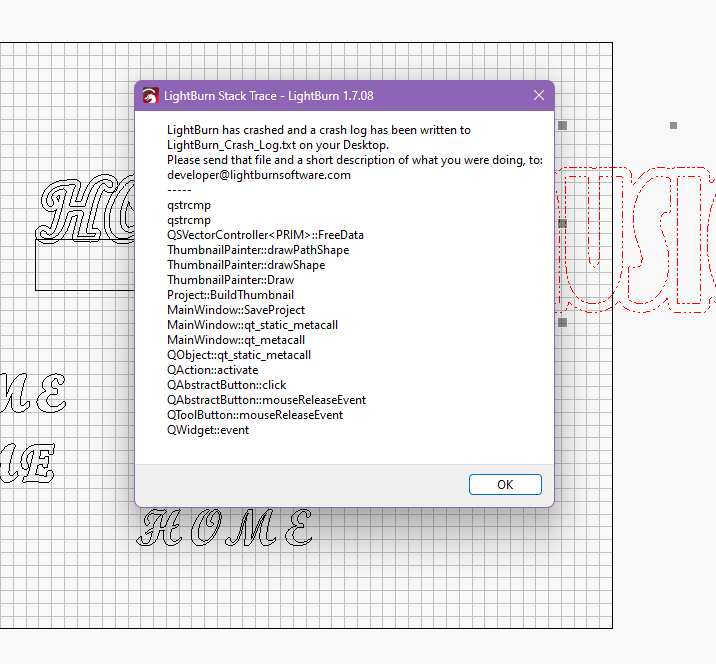

lightburn crashing, coping ctrl+c graphic than paste ctrl+v to another project, when i make save crashing. Problem is that not every time so i dont know whats wrong.

Hi, did it again. crashing means if i click on ‘‘ok’’ lightburn closing him self
open project
choose grafic
ctrl c
open another project
ctrl v
till here it s working
if i make save than crashing
Screenshot 2025-05-27 112410
after than lightburn erased my second project that i tried to paste, look screenshot HOME KEY.LBM2 -0kb-
and open new one by name - HOME KEY_ThNOFk.lbrn2 -214kb
LightBurn_Crash_Log.txt (7.2 KB)

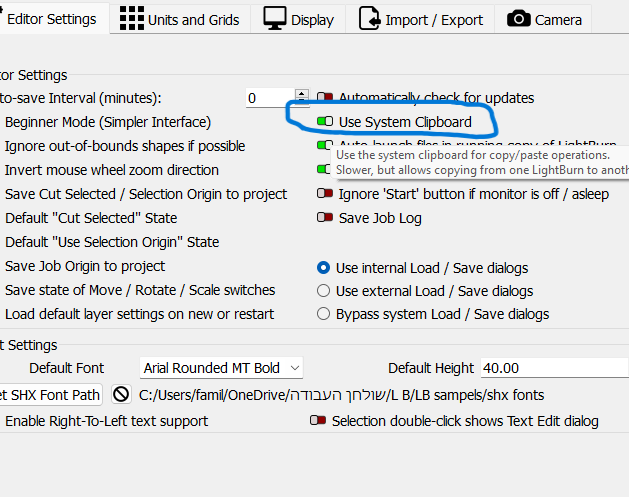

i think I found what was the problem, use system clipboard was off, tried many times on and off. every time was off lightburn crashed after save.
maybe u can do something for this or help some one will ask about this problem in the future.

Glad you found it! I had no idea you could turn that on or off.
Please report your findings to support@lightburnsoftware.com and include a link to this thread.
Good job on continuing to research the problem. :nerd_face:
