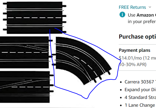

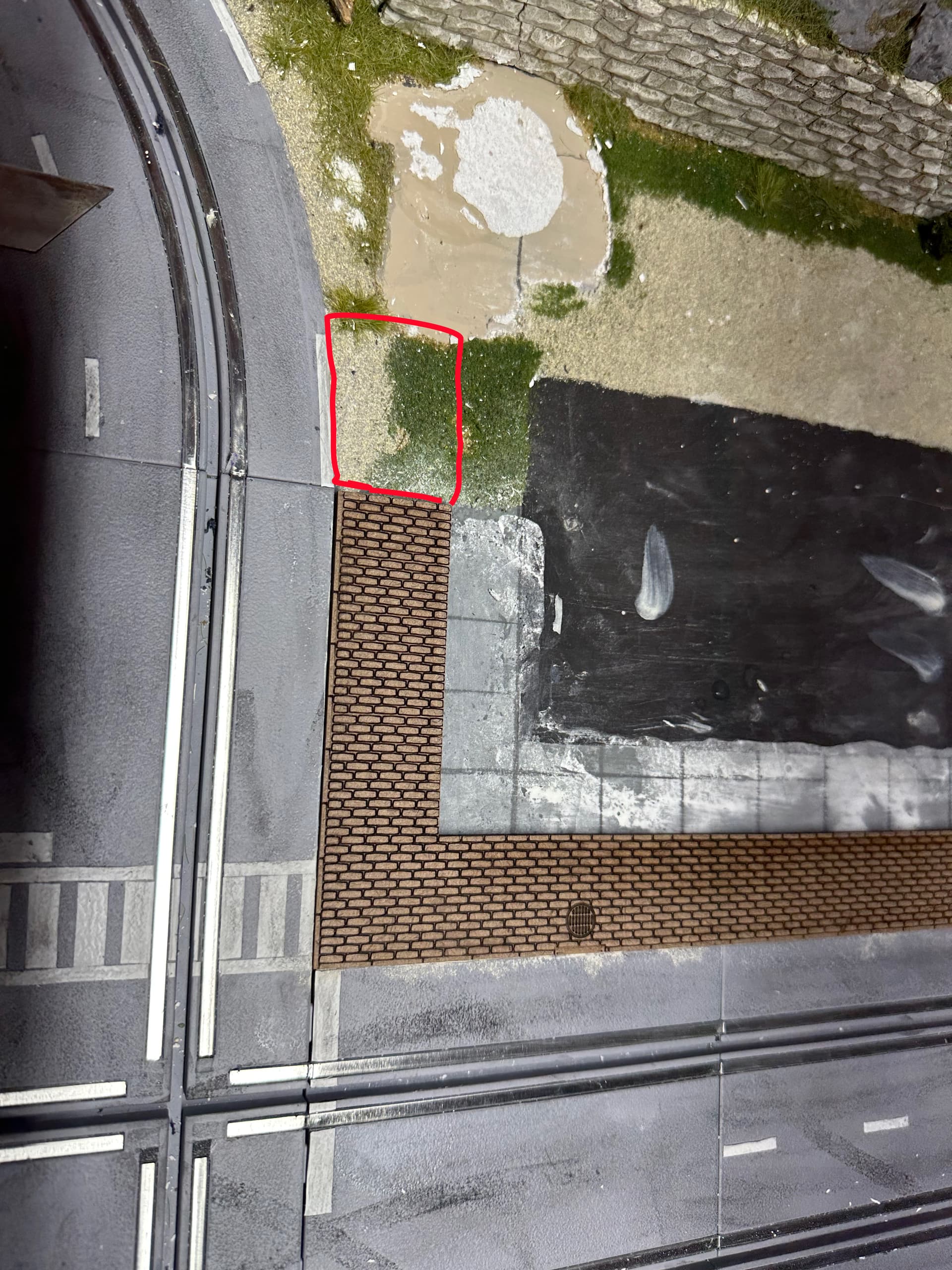

I am designing a O scale sidewalk for a slot car track. I had a finished product, but, alas, things change. I want to extend my sidewalk per the outline in the pic a few inches or cm. I would like to outside or the sidewalk to follow the circumference of the track until it terminates. The track is a 90 degree turn. I have no clue how to start the math or even where to ask about starting the math to curve my larger rectangular perimeter stones to follow the track. Thoughts? Thinking? Sorry about my crude drawing. The sidewalk will follow straight up on the right and then curve to the left on the left side until it terminates.

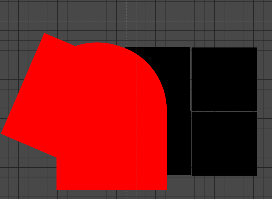

I would go back to the Boolean tools. Draw the sidewalk large enough to cover the X and Y axis you want. Then overlay a curve to match where you want to trim and use boolean subtract.

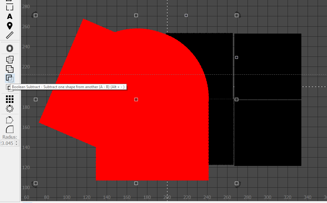

Here black is the sidewalk tile and red is the curved road path
Select black piece that will be overlapped. SHIFT click red layer, then boolean subtract A-B

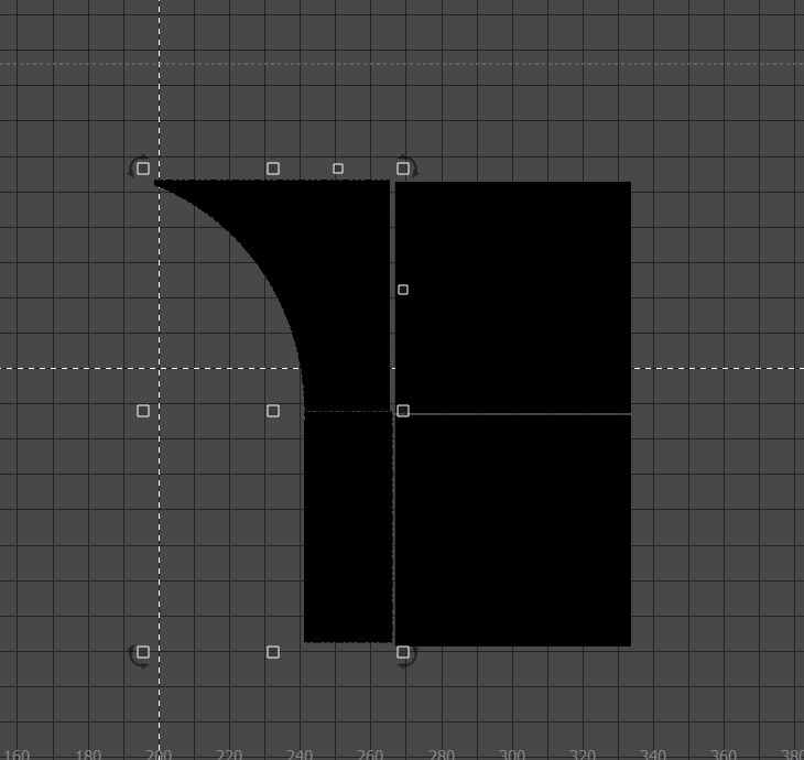

resulting in the curved black layer

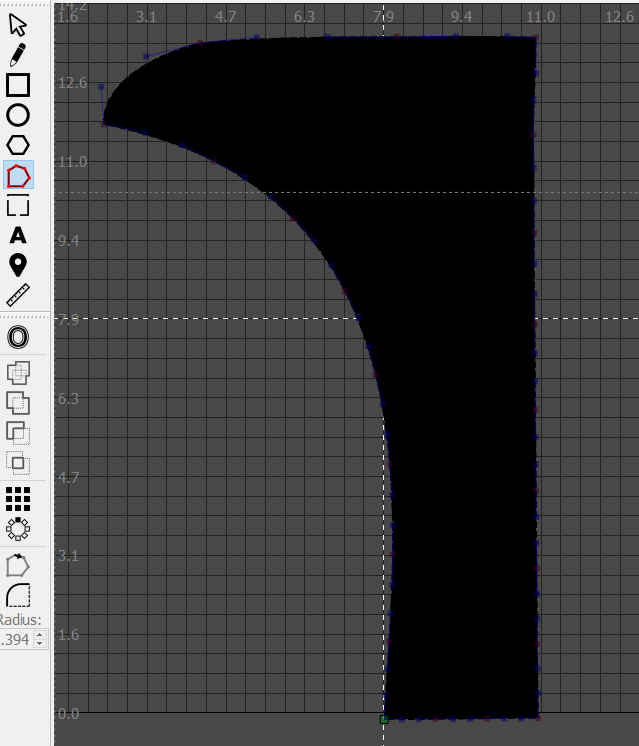

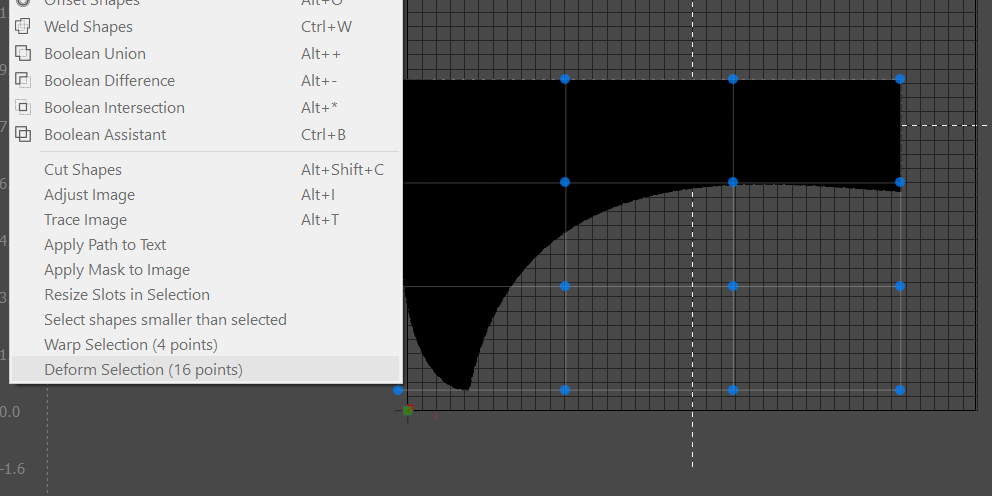

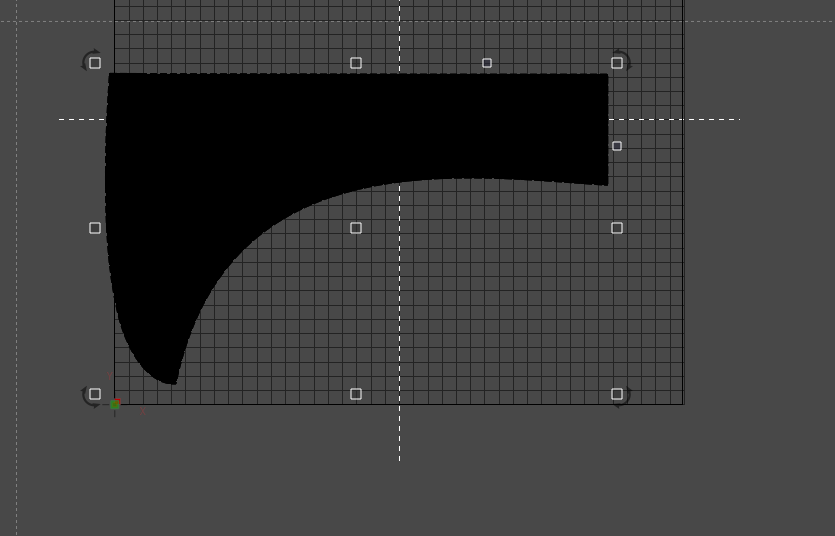

There is a new tool in the latest version.
DEFORM takes a shape and gives you 16 handles to drag around. This was a rectangle that was DEFORMED to get the curve.
The node edit works to adjust the shape.
