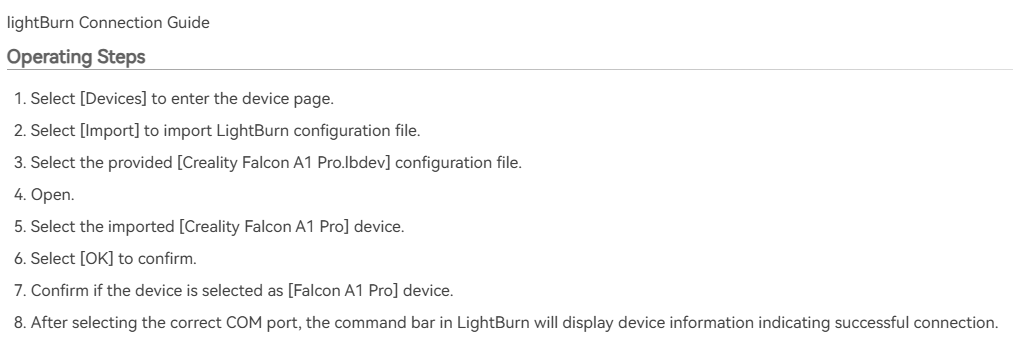

I didn’t see Creality’s instructions on how to add this device to LightBurn, but it looks like they just created this wiki entry and might still be working on it.

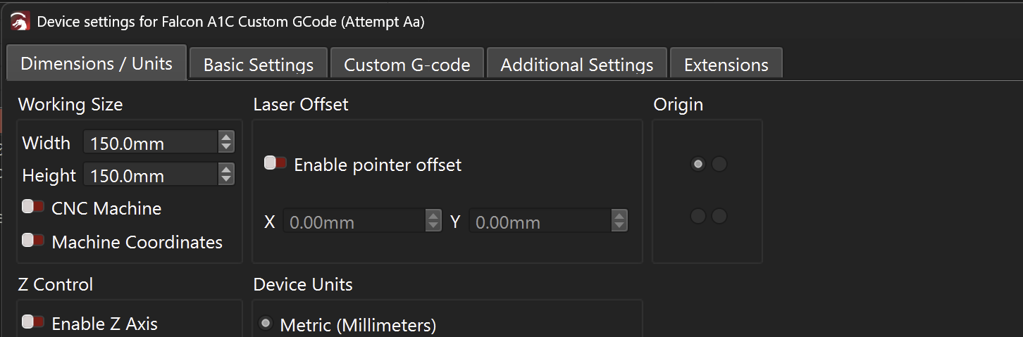

If you can send us your exported device I’d like to see if there might be a settings mismatch.
Hi, thanks for the reply.
Creality did not provide me with a specific A1C LightBurn device profile.

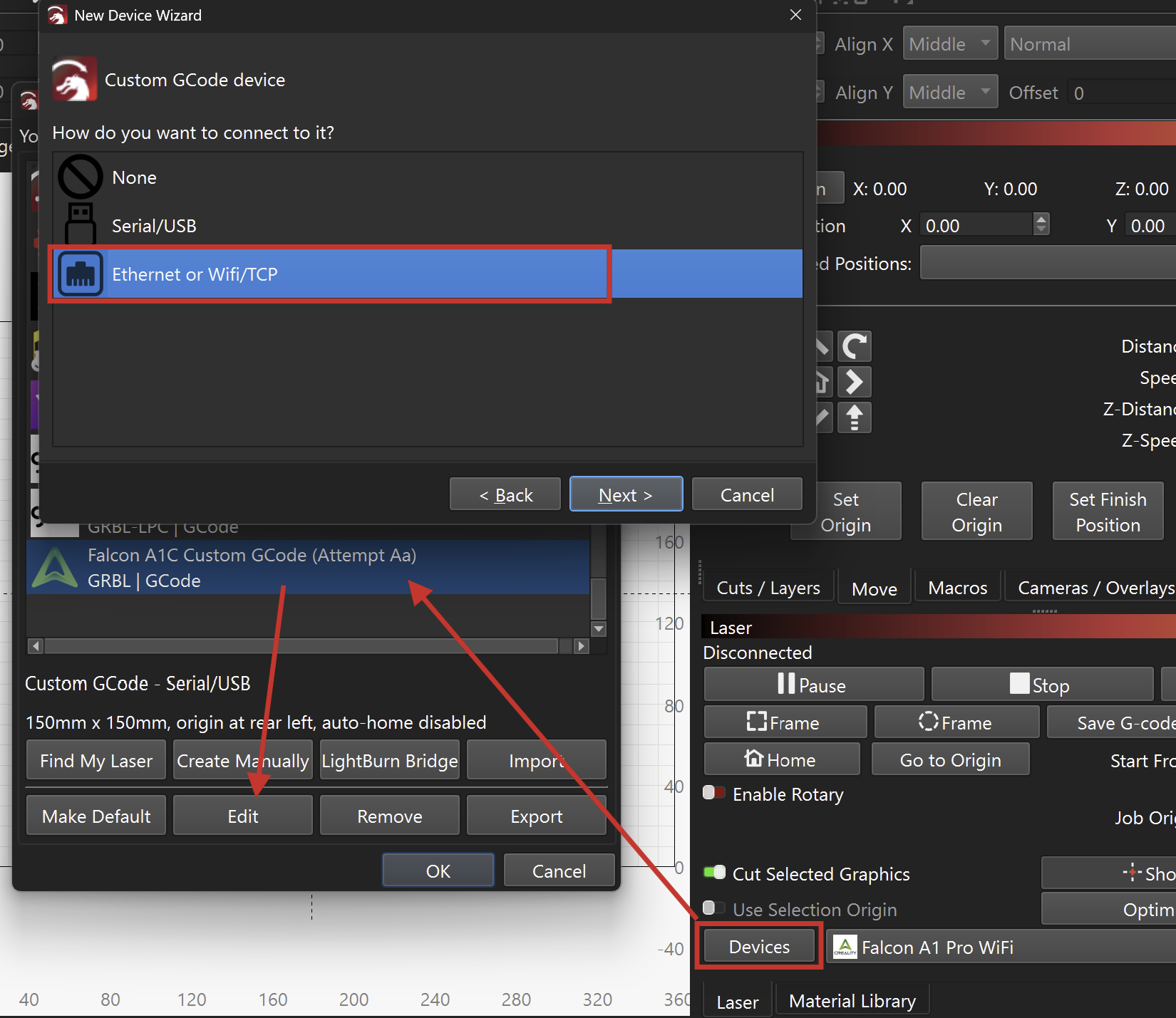

I do have a Falcon A1 .lbdev profile that I downloaded and used when I later set up the A1C over USB, and that works.

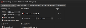

For the WiFi connection that I reported the issue with, I did not use that profile. I created a separate device manually in LightBurn 2.2 using the new Creality Falcon HTTP flavor.
My A1C currently reports firmware:
CV40mini-MASTER-Release V1.1.2 20260903-1149
I couldn’t find a newer A1C firmware on Creality’s website, but I’ll check directly on the machine when I get home from work today to see if an update is available.
I’ve attached the exported device for the WiFi/HTTP setup so you can check the settings.
Thanks for looking into this!
FalconA1C_test.lbzip (2.0 KB)

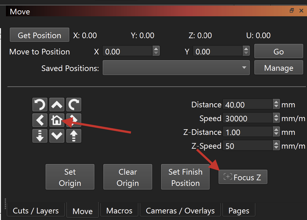

Console GCode and User Macros will NOT work on any of the Falcons over HTTP. The remote API is all about job submission, and technically does not have a way to run individual commands. It’s annoying. We have to map our functions to REST calls.
The console is still there so you can see API messages, but entered commands don’t actually go anywhere. We will improve that UI.

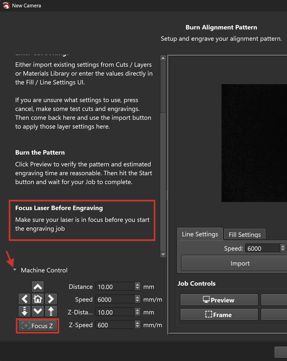

The Z Focus button should call the AutoFocus function, no need for that macro.
The features that should work are:
  • Jogging
  • Framing
  • Running Jobs (arguably the most important)
But if you could not frame, then there might an API difference between the A1 and A1C. I’ll look into it.
