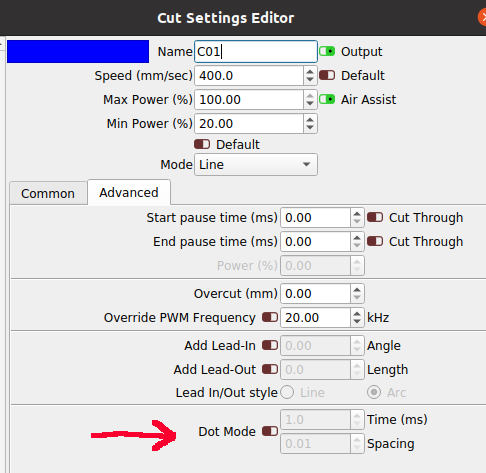

I often need to reverse my piece of wood to cut front and back side (same lines).
I use “print and cut” function to do that, but I’d like to use dots to align the 2 sides.
is there a way to create a dot (not a small circle, juste a dot).
I’d like to go through my piece of wood with 2 dots to align the laser on the back side of the piece.
There is maybe another way to do it right ?
thks :slight_smile:
Probably just make a square or circle really small. Or use line and make it 0.1mm long
yes, that exactly what I’m looking for
There is a ‘dot mode’ available. Might be usable for your application.
dot-mode
That’s an interesting option. Hadn’t heard of that before. But think this may be a Ruida only option. I don’t have it.

In the move tab use the fire button and just increase the power.
I have done this to put a small reference point on wood.
I imagine you could just crank up the power to 95% and let it sit until it burns through if you need on both sides?

Hi,
the fire button is cap to 20%. I already tried. May be is there an option to go to 100% but I don’t think so :slight_smile:

Are you able to devise a jig that would allow you to reliably flip the piece and relocate it precisely? This would be less fuss than print & cut. And repeatable if you needed to this more than once.
I know you can tell it to burn at whatever power level, via gcode. Don’t know about how to time it’s duration. But you might look into that… had this bookmarked…
