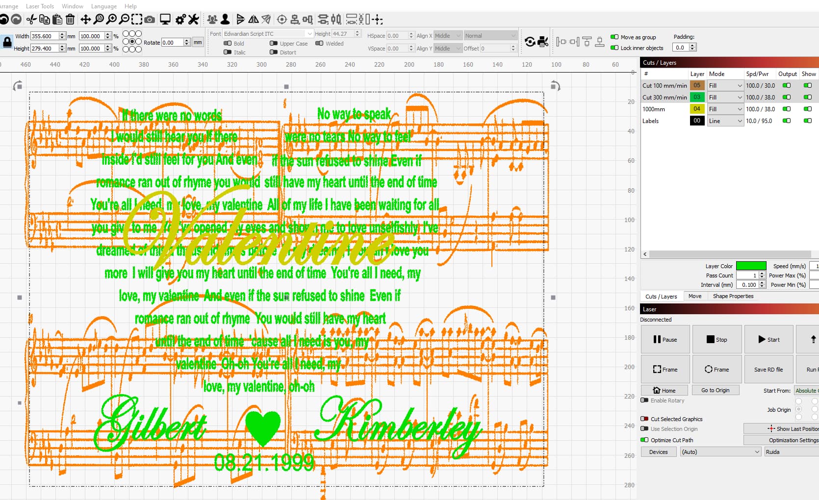

I have been designing my files on one computer and then burning with another. When I design everything looks right but when I go to other computer the Fill does not show. it shows line only even though it was saved as fill.
Check Window->View style on the target computer. Based on what you’re saying you probably want to use one of the Filled options there.
Thank you also how do I get this image to engrave the layers without going behind. In other words I don’t want the text to burn under the title across the middle. I thought by setting up the different layers it would do that automatically. Or is that a design piece I am missing. Never mind I figured it out. Weld shapes. lol
