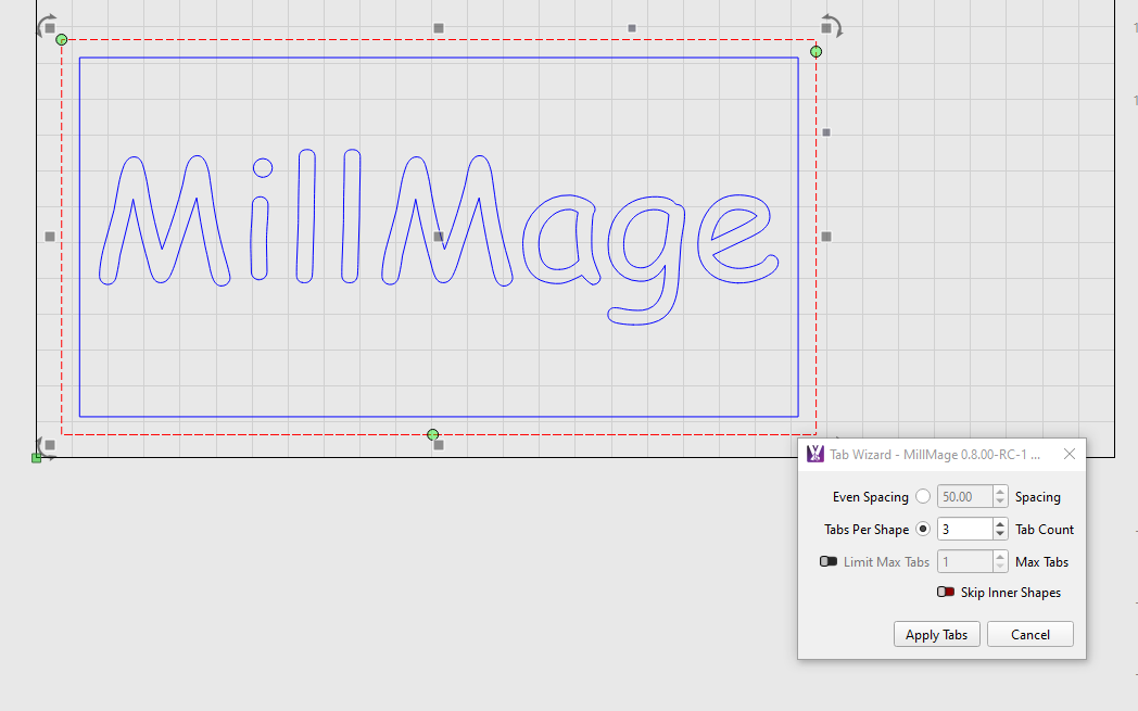

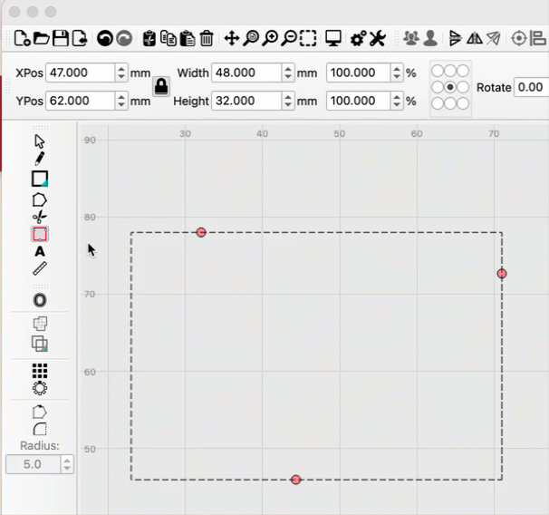

Maybe I missed it but on the tab wizard I can pick the number of tabs per shape but I cant pick where those tabs are.
Is there a way to edit the tab location?

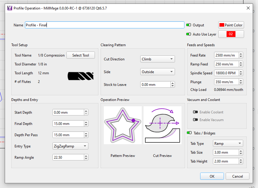

Also on the Operation settings for Profile it would be great if you could launch the tab wizard when you enable tabs if you had not set them previously.
No Place to change tabs:
Ability to launch Tab Wizard:

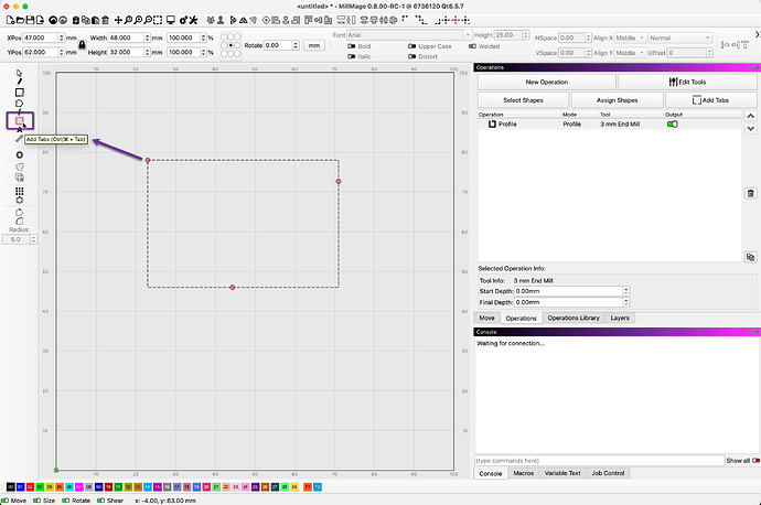

Yes, MillMage provides auto-placement of tabs as you show. Additionally, you can add, delete and control placement manually. On the left sidebar, you should see the ‘Add Tabs’ tool. :slight_smile:
2025-06-13_10-14-43 (1)
Who thank you and sorry for missing it, makes a lot of sense now how it works.
You are welcome. No apologies needed. There is a lot to discover. Your questions are helpful, as we look to refine UX, process and flows to better match what users might expect. All good. :slight_smile:

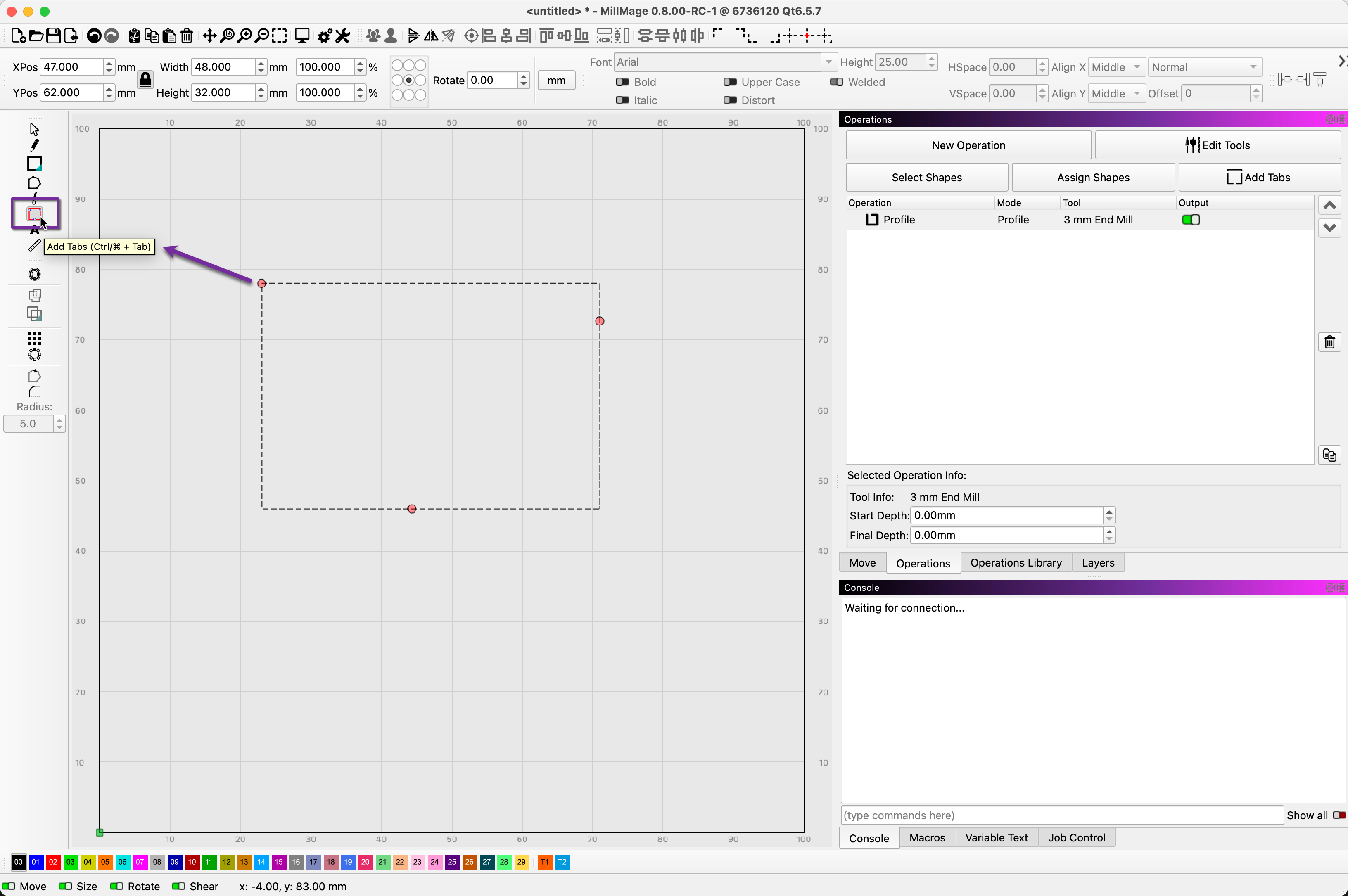

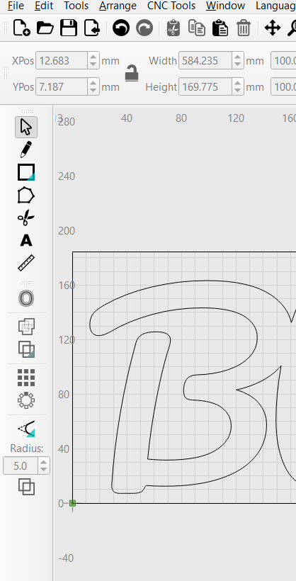

My Add Tabs button is missing and using CTRL + Tab doesn’t seem to work either.
I tried uninstalling and reinstalling the software and resetting the toolbar doesn’t seem to work either. I can use the wizard. Any suggestions?
Do you have beginner mode enabled?
That was it, thank you.
