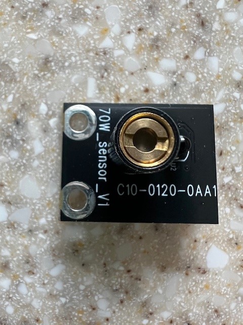

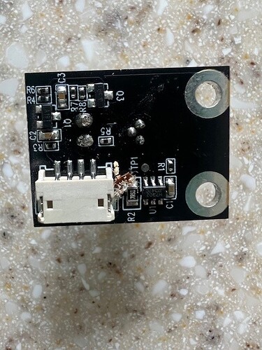

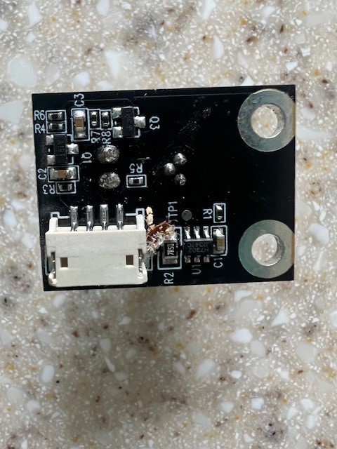

I am wondering… Is the pointer on or off while you are actually burning or cutting?
The cross hairs is located in a small module mounted up inside the laser module. It contains the cross hair and also the Flame Alert sensor. Here’s what it looks like
Could his pointer controller board be bad?

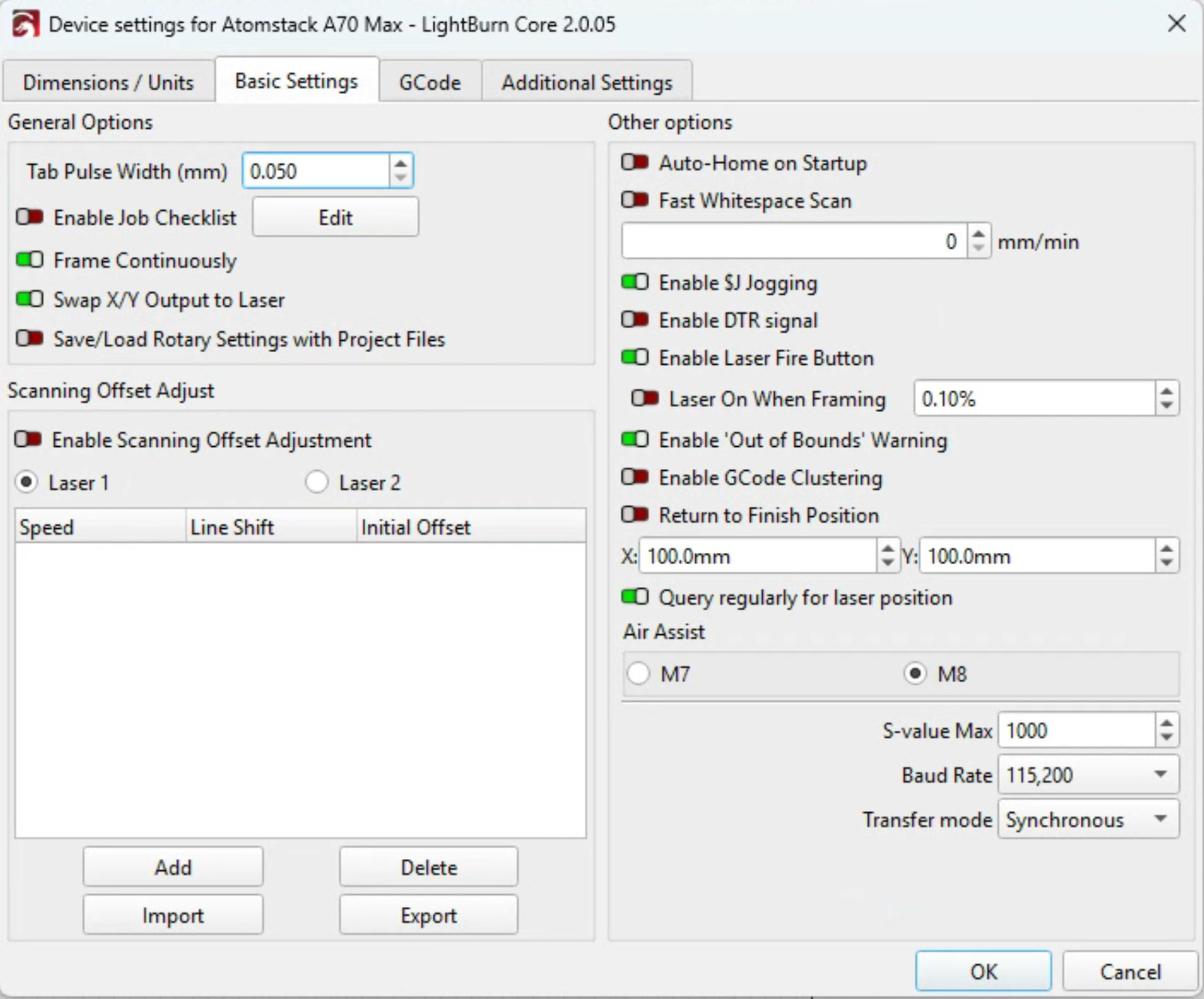

All right, here’s how my A70 works. I have these settings
On when framing
I also have laser Offset enabled
When i connect and home the machine the Cross Hair comes on and stays on while im homing. When i frame only the cross hair comes on. My cross hair stays on all the time unless im running a job
. When I run a job the cross hair turns off and the laser beam comes on
Now that makes sense, and how I would expect it to operate. Laser off, pointer on, negative logic.
If he has the same settings it should work the same as mine. Only thing i could think of is if he has laser offset enabled without any x or y offset values. My machine is an A70 Pro. But his A70 Max should use the same X and Y offset values or get him pretty close.
Should fix it.

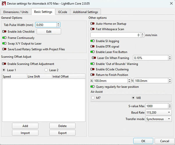

Show us your Laser Offset Settings. If this works in Atomstack Studio then your machine is fine. Seems the logic is bassackwards in Lightburn. Try turning on “Laser on when Framing” and see what happens
Here’s all the settings for an A70 Max.
Compare these with your machine

Is your device set up for GRBL. Is this a new machine. Has this ever worked correctly in Lightburn. If none of this helps i’m out of ideas. Time for a nap. :frowning:

If I turn on “Laser On When Framing” yes. If I turn it off, then not.
Sounds like yours is operating normally.
