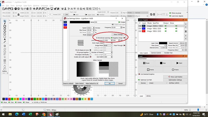

in some of the older videos I see a crosshatch toggle switch in the cut settings editor, but doesn’t appear when I look in mine. what am I missing? \
edit: it looks like it’s because of the graphic I’m using, but what if I want to crosshatch a given graphic (like a logo), is that not possible?
Crosshatch is available for “Fill” mode layers. Image layers have other options but not crosshatch. If your logo was made using vector graphics you could apply a crosshatch with the fill mode.
ok thanks for that, that is helpful knowing that it has to be a vector.
