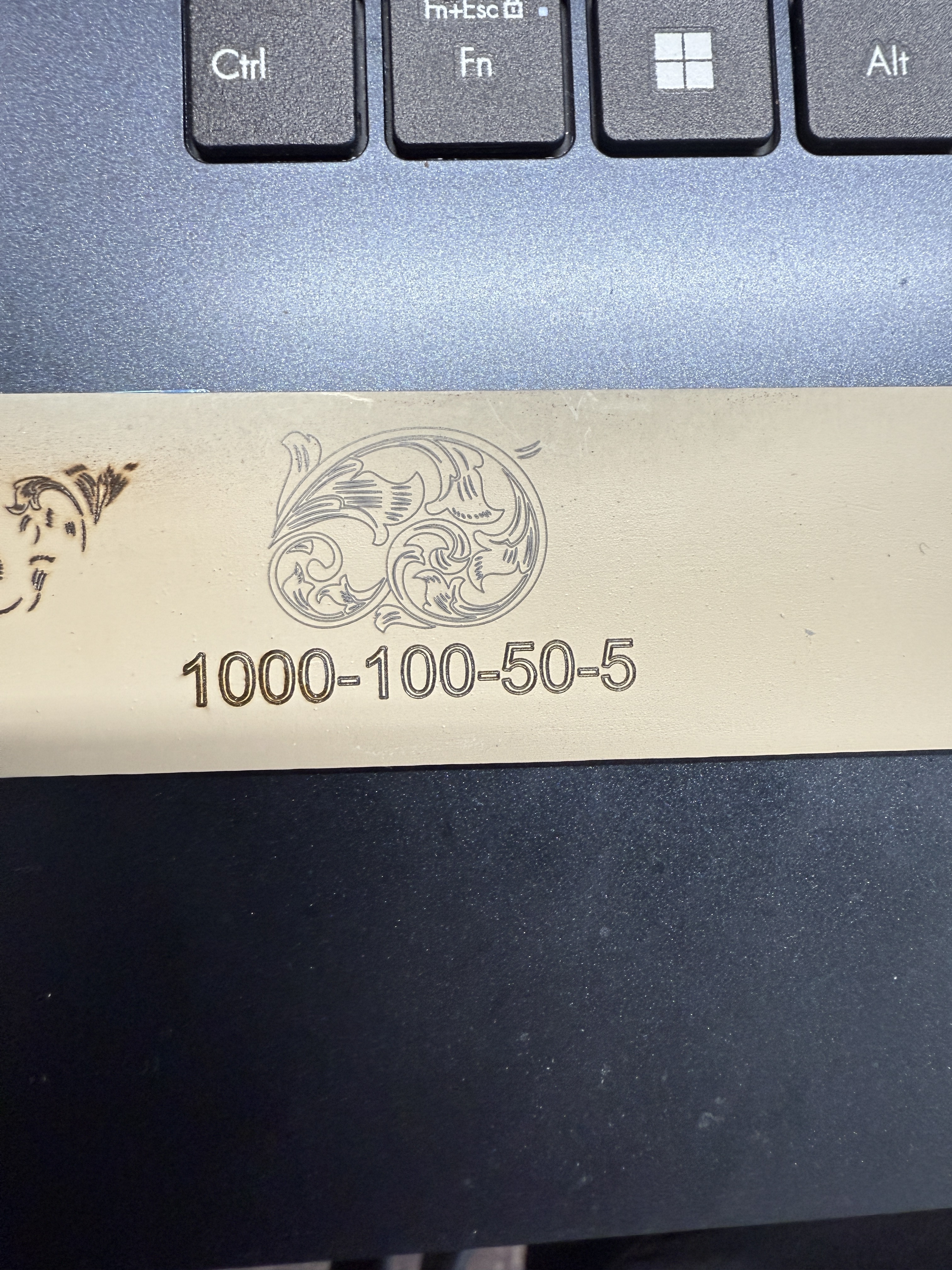

Curious on this engraving
Why is the design lighter than the numbers? The numbers are speed power freq and passes.
Thank you.
Mac 50W fiber 110 lens.
![IMG_0442|375x500]
It’s steel with Cerakote’s desert sand.

Did you import your laser manufacturer’s settings when you created the device profile?
I don’t think so but not sure. I thought the laser setup did it.
Both on the same layer? What are your parameters, Speed=1000, ?100, ?50, Passes=5? Screenshot best.
It was just a test piece. The numbers are the speed, power, freq and passes.
They were on different layers.
Most likely there was a setting on one of the layers that was different. Sometimes easy to miss. Put them on the same layer to confirm?
