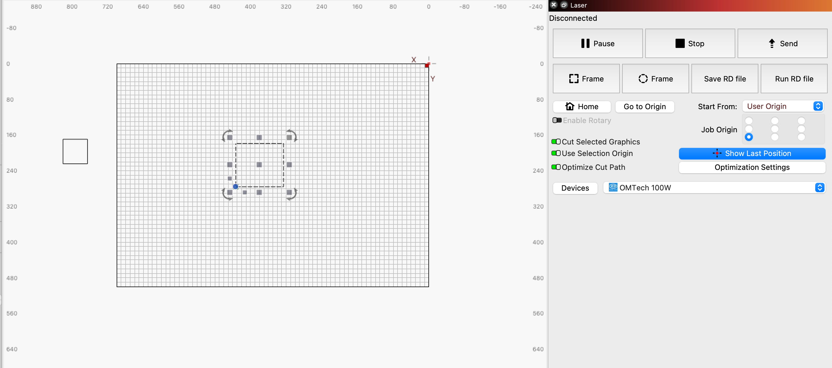

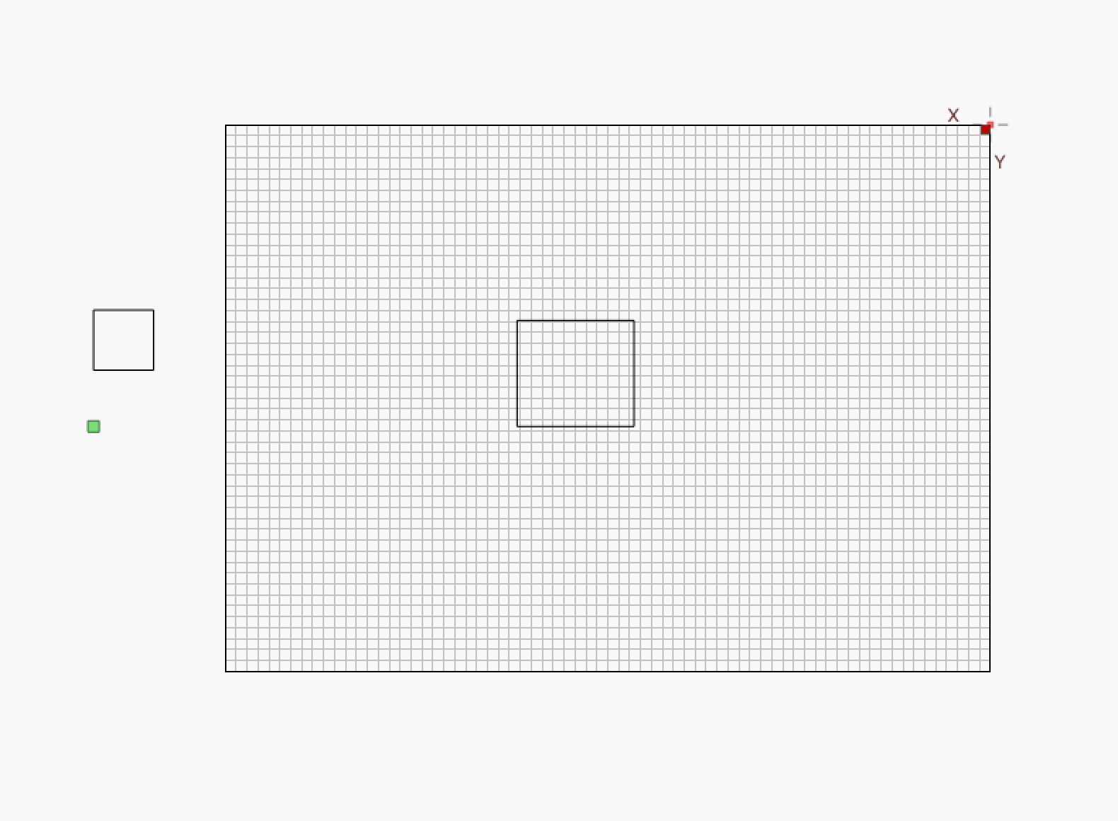

I had some confusion when I first started. In User Origin or Current Position, if there is any artwork off to the side of the work area, Lightburn wants to include that in the cut unless you have Cut Selected Graphics AND Use Selection Origin selected. That can cause the job to be out of bounds. Check the preview window and that will show you what exactly is being sent to the laser.
In this image you can see I have a square outside the work area. This also affects the position of the green Job Origin Square.
If I use Cut Selected Graphics AND Use Selection Origin you see the green origin moves to just the selected item.
