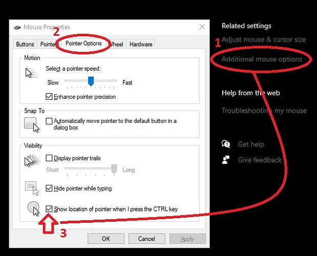

To help locating your cursor, try the below. I’ve used it for years in training sessions where my students weren’t sure where I was pointing to on the projected screen. I just simply hit/tap the Control key and the Radar helps them find my cursor.
