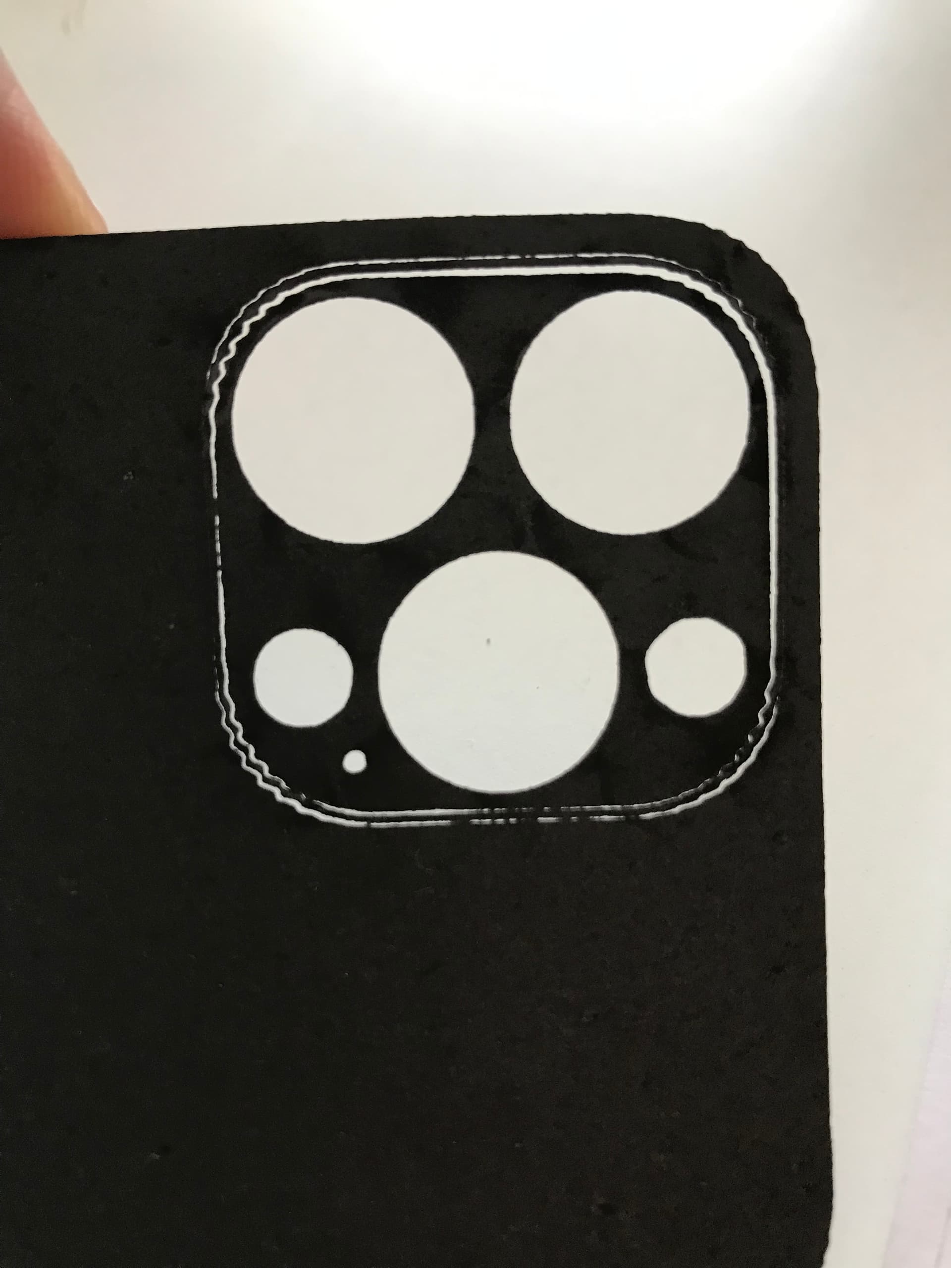

I am facing some difficulties as some vector files working fine with Epilog laser/ system. Taking the same vector the curves relate in kind of a zick zack. I have tried many things already but not able really to make any progress.
I saw that in some older versions it was possible to adjust a “curve tolerance” but did not find it. Further I have tried to optimize the vector in lightburn, Corel Drwar same as Adobe illustrator but did nit help at all.
In the preview it looks fine. The laser in general works also fine but as mentioned have some issues with vecotrs which I dont rally understand.

Thank you so much. Tried the curve tolerance but did not work unfortuntly. Strange when using low speed the curve is fine but with higher amount of speed this zic zack appears. With some other curves and and circles is no issue using very high speeds
Can you take a picture of what you’re seeing? This sounds like a machine wobble issue, which isn’t uncommon at higher speeds on the cheaper Chinese import machines. There are few different things that can cause it.
What speed are you running those at?
I would have the same thoughts but curves are no issue when doing other curves and circles at very muchhigher speeds. I tried also to smooth the files
at 40 its ok for this file but when going over it have always these zic zac
“40” isn’t a speed. 40 mm/sec? 40 inches/sec? 40 inches/minute?
If it’s mm/sec, then you very likely have something loose, like a belt, bearing, lens, etc.
sorry, yes 40 mm/sec. Nothing loose as many files working fine at much higher speed rates. Thats really strange

Here is the file, left is already a smoothed path, right one not. Bith have the same topic when using speeds above 40 mm/sec. Slow speed no problem. But as mentioned other files are no problem. Would just like to understand the issue, thank you so much

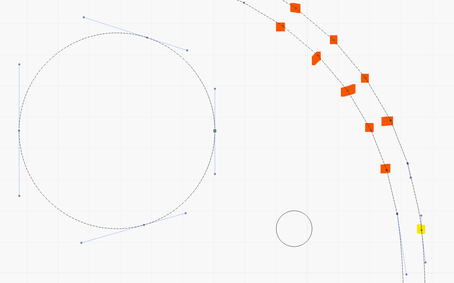

I think what you may be dealing with is that the rounded corners aren’t really curves but rather a series of straight line segments. I suspect your laser is having a hard time with these.
One spot where you do have a curve the curve is actually oriented inverse of what you’d expect. Highlighted in yellow.
Thank you very much. I guess youbare right. Is there any tool you can optimize this easily? I tried smoothing also in illustrator but its easy to change the dimensions when getting to crazy
Can you simply create and retain it as a bezier? Then allow LB to handle the curve rendering.
How are you generating this design? This would be trivial in LightBurn by creating a rectangle and then using the corner radius property within Shape Properties.
