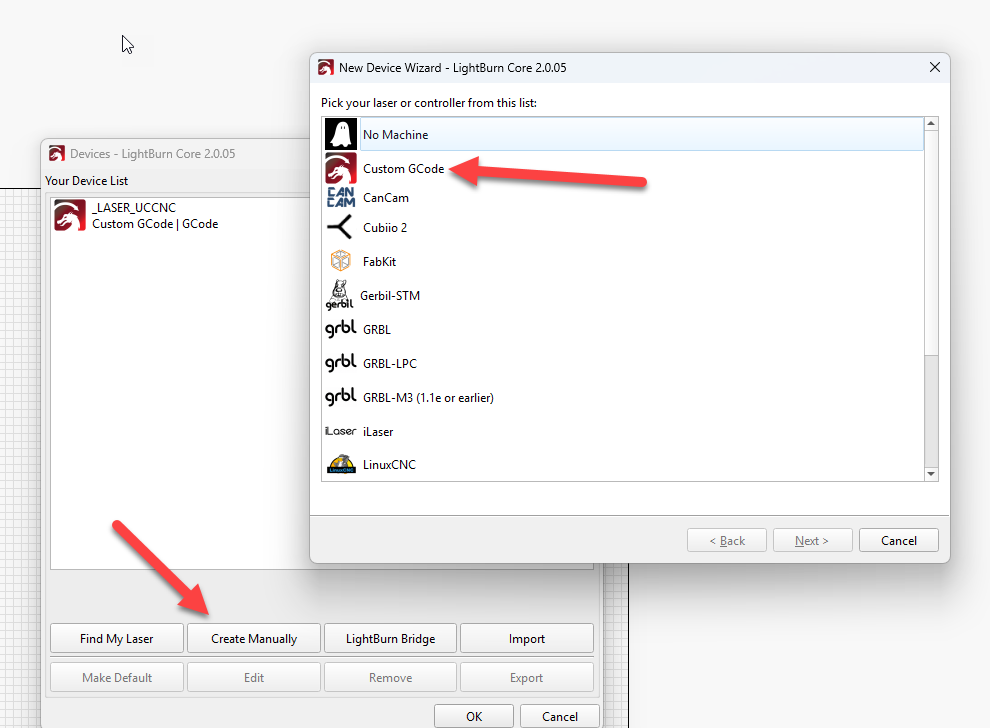

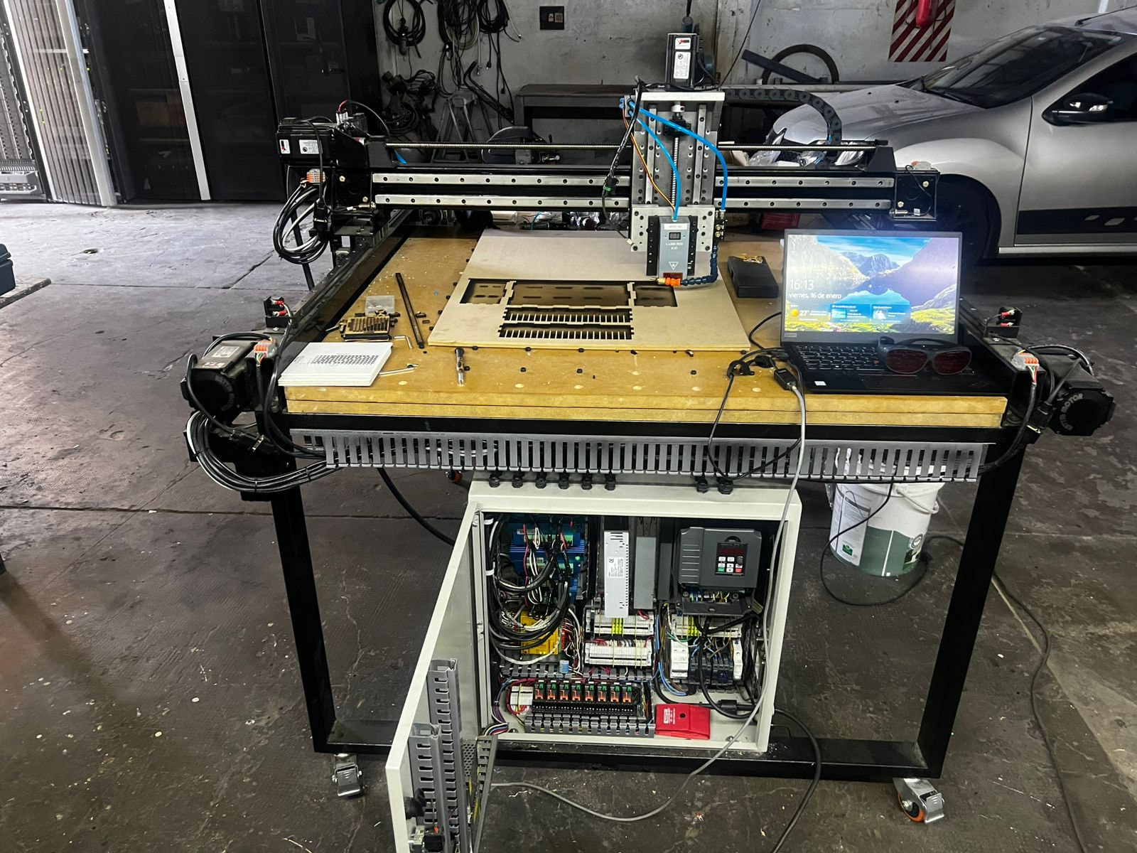

Hi I am using the standard LightBurn Pro version (my cnc cant be directly managed by lightburn as it has its own controller software so i needed the “custom Gcode” feature on the pro licence).
My cnc was hand build by me as a multipurpose tool (i can exchange the tool head to accomplish different tasks, laser cutting, plasma cutting, or milling) based on the PrintNC Project but i have done many modifications to the original design to make it stronger for metal cutting and fitting larger closed loop motors with position control.

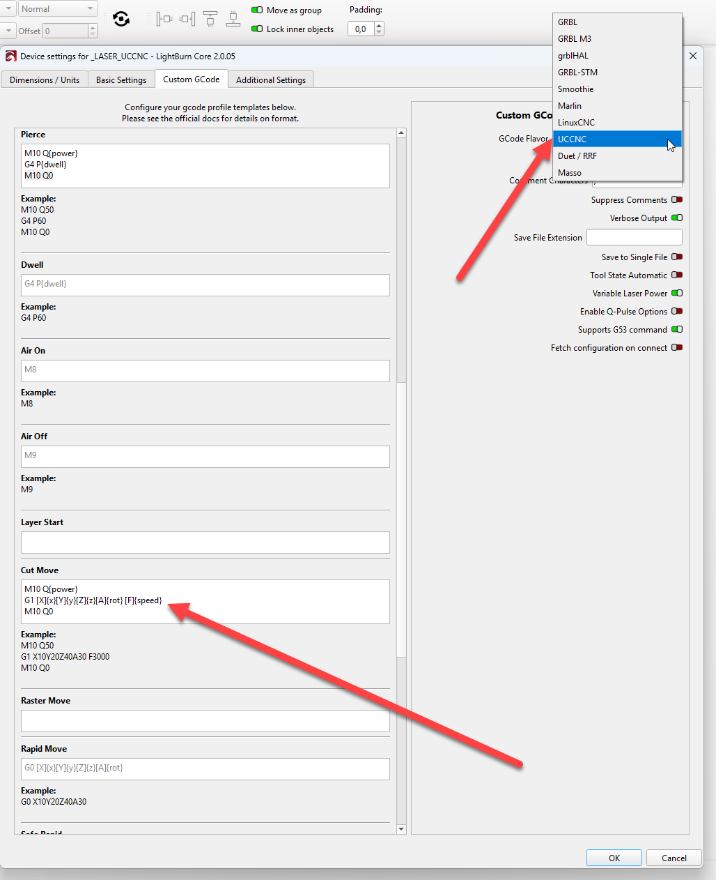

I manually created a device chosing the option “Custom Gcode” as there is no direct Support to UCCNC (most similar was LinuxCNC but does have different set of commands)

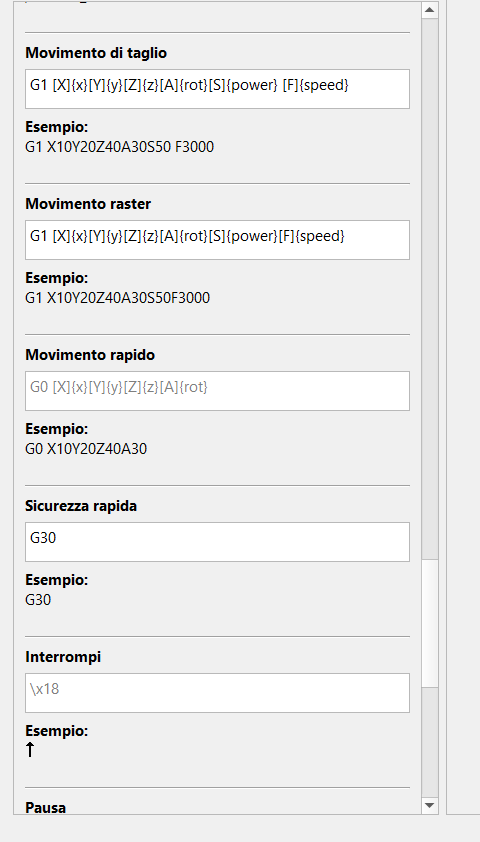

Today i got it finally working (laser now is off while moving to next cutting starting point) by specifically telling the code to send a “turn off” on every cutting movement (i think this should be in fact the standard behavior as there is a “fire off” command, but the software is not actively using it when exporting the gcode)
if you are having the same problem and using custom gcode, maybe you can try also adding a line an extra line in the “cut move” settings (bare in mind this is very specific to my controller documentation that states the allowed / supported gcode commands). i will post all my config in case someone is also trying the UCCNC gcode flavour.
looking you gcode customization gave me a few ideas that I implemented and got it finally working. as mentioned my controller has its very particular implementation of gcode as yours. there was no way of getting the laser off when moving between cuts, but after analyzing the gocde exported I noticed that it always “resends” the cutting power parameter on two connected cutting movements even if unchanged.
now i send a “power off” at the end of every cuting line (as mentioned on the post i was expecting this being the default behaviour as there is a fire off command set)

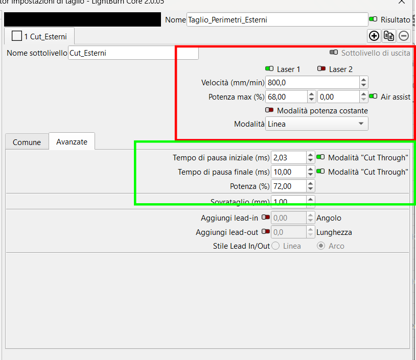

I’ve found several anomalies…
But there are definitely two BUGS!!!
The first, in the red box, is that even if you use the second laser (tool), the code always uses the power set for the first one!!
The second, in the green box, is that this function doesn’t work in this custom version because it doesn’t issue the necessary commands!!
If you have time, can you test these two things? And see if they work for you?
I’ve already reported the bugs to Lightburn…(a few versions back), but in the new versions the bugs persist and haven’t been fixed, and I haven’t even received a response from them!!
Please use only the first Power % box with Laser 2
The switch from Laser 1 to Laser 2 is mutually exclusive, so the second power box is somewhat redundant and currently not doing anything (noted for cleanup).

I’ve already discovered all the limitations of the custom version!
However, the function highlighted in green works really poorly! It’s a bug!
Because if you select it, it activates the S% power, but not the pause! If you deselect it, it activates the pause but not the power! And it only does this on the “input”, not the output!
I’m sure the Lightburn team will fix this problem and all the others with this version! Because currently, it’s the only version that allows you to activate extra functions on those with a custom laser!
