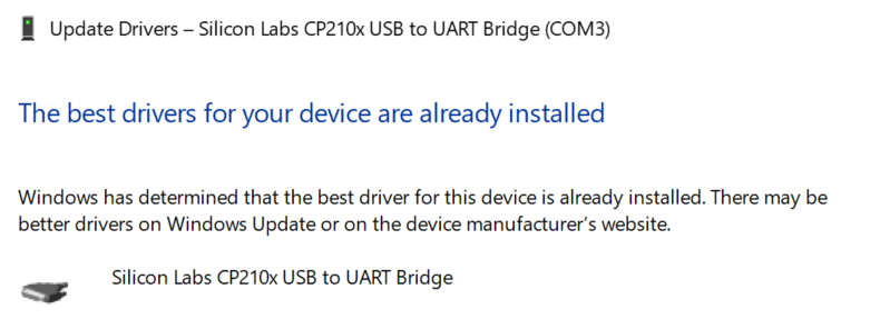

Did you install the si labs CP210x driver linked on the wiki page?
Hello Aaron
windows reports driver is up to date when you do an update driver request.
forcing the latest driver from Sillabs results in this error.
As the standard profile works at the same baud rate and on same hardware i don believe it could be driver related.
