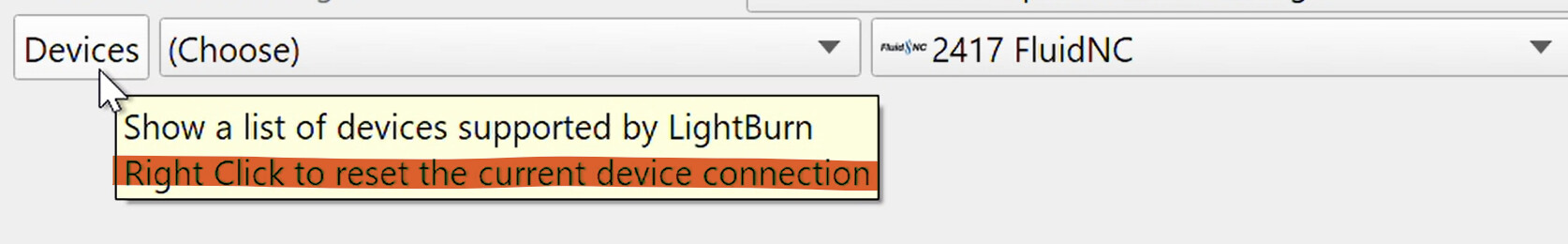

If you really want to: Wireshark can be used to sniff USB packets. It has its own learning curve, to say the least.
You can look inside an exported .LBZIP by renaming it to *.ZIP. The contained .lbdev file can be opened with any text editor.
Uhm, What makes you say that?
I’m probably biased, but most comms issues can be attributed to faulty USB cables, drivers, operating system, or firmware.
Many oddities can be resolved by restarting the controller, or right-clicking the Devices button in the laser window to reset the USB connection.

After connecting and selecting the device in LightBurn, did you try
