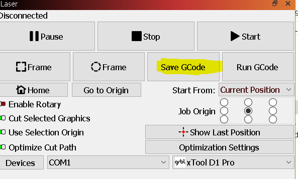

(Follow these steps)
Vevor controller switch in laser mode, in Lightburn Console window:
    1. type $$ and copy/paste here the output
    1. type $RST=* and wait a few moments
    1. Type $$ and copy/paste here the output
    1. Disconnect Vevor from PC and from power supply (turn OFF).
    1. Unplug offline controller
    1. Reconnect Vevor to PC and power supply (turn ON)
    1. Test your machine for moves then put your laser goggles turn ON laser and try.

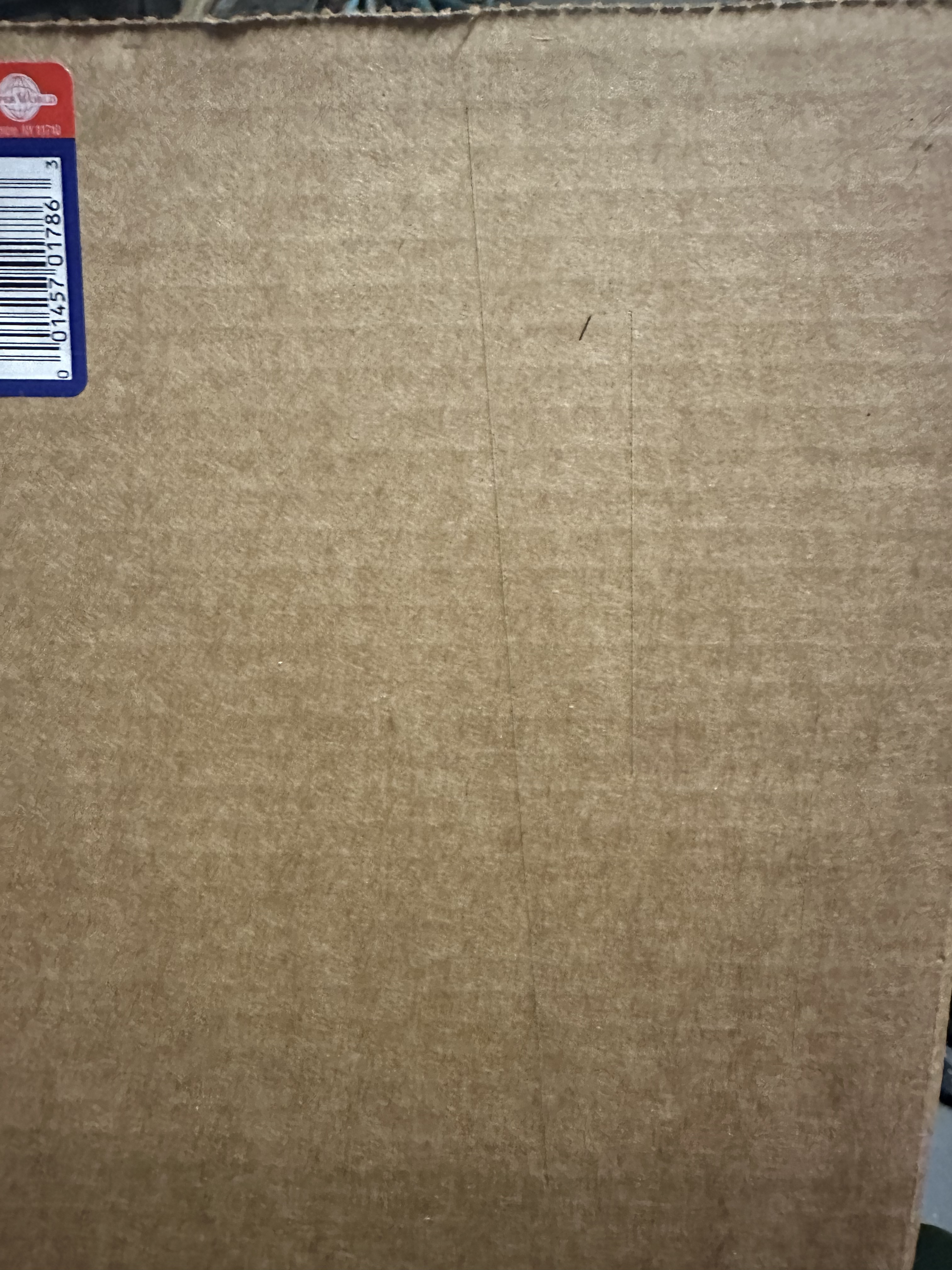

it seems better, but it keeps turning off randomly, and i cant home it anymore, and its not cutting thru all the way still. but it seems to be getting better like the one pass was deeper i think
This is what it looks like when it cuts now
This is looking much better and the line appears stable.

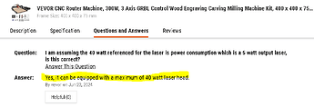

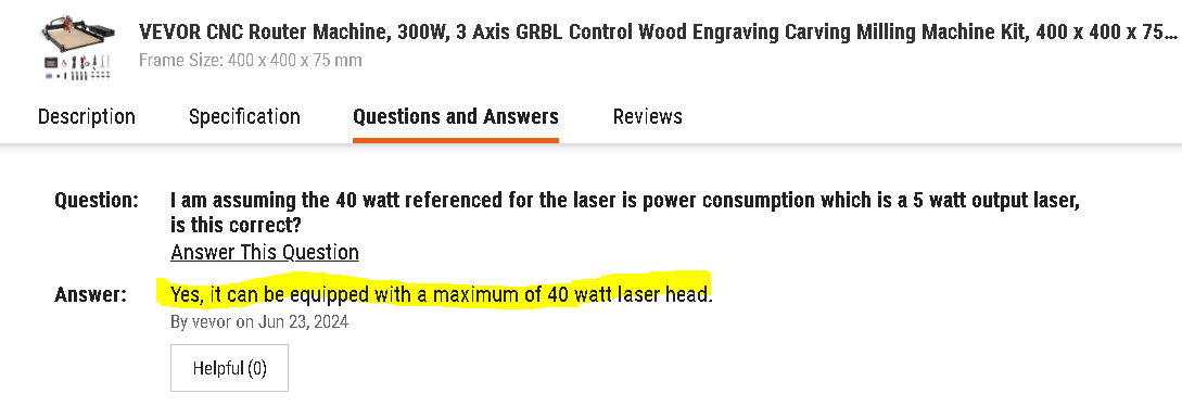

If the laser needs 80W input to make 10W output.
80W/ 12V = 6.67 Amps (for just the laser) at full power.
5 Amp supply may not be enough.

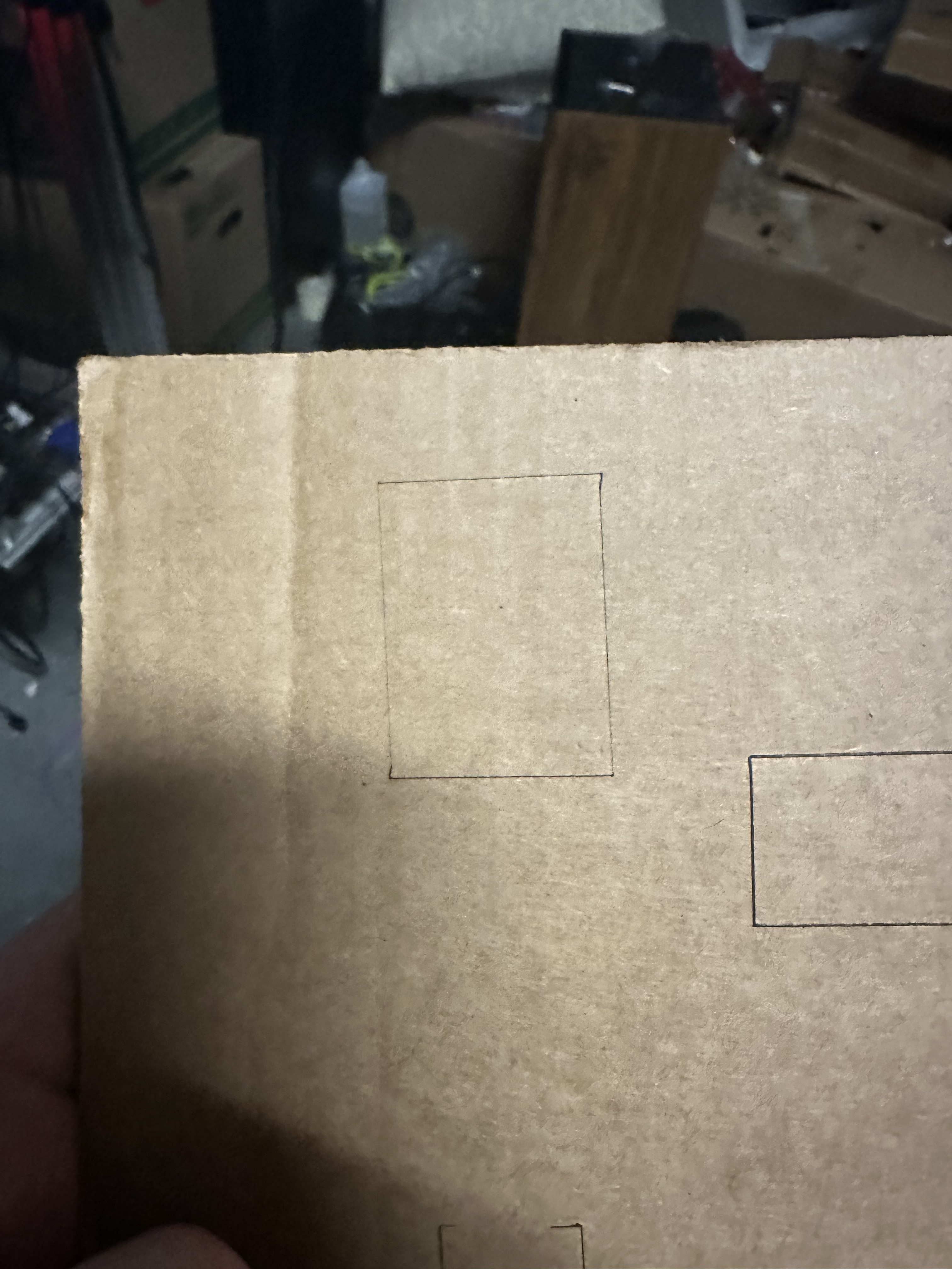

If you are still having trouble with the laser engraver shutting off randomly, unplug the laser near the module and repeat the job without the huge power draw. If the job moves completely from start to finish then you are most likely dealing with an insufficient power supply.
This is the result of me changing the psu out to a 10 amp one I have tried to change the $30 value to different things and that maybe the problem, I am also trying 100 mm/m at 97.5 power one pass is that not a good starting point? It doesn’t seem to be passing thru nearly as much now

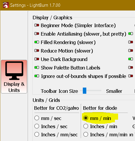

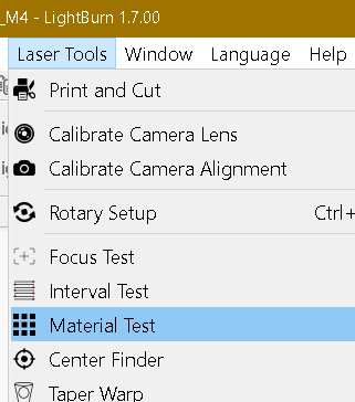

After:
  • In Settings use mm/min
  • image
  • Regarding the above answer we don´t know if your controller can hold >5A so use the 12V/5A power supply and do a Material Test power MAX 50%
  • image
    Keep power at MAX 50% for now, run a few jobs and then come back for the following steps.
I tried it at 50% power and got no cut lines, I bumped it back to 95% and still got the same result from before, not cutting all the way thru
