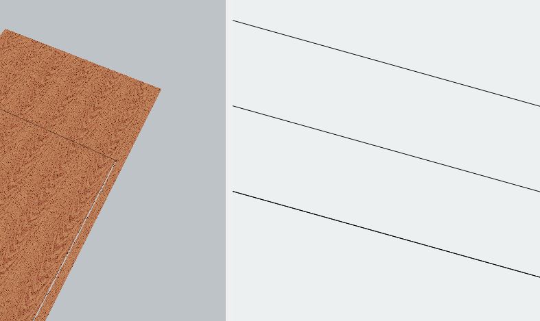

final depth of 18.6 set doc at 6.2 mm
preview shows 3 cuts when ran job it did 4 passes ?
it cut though board in the 3 passes the 4th pass wasnt very deep
is there a reason it would do 4

Preview looks like it shows 3 and a teeny bit, so the last two are super close together - the 3rd (lower) line is darker.
Most likely, you did a 0.5" job and did 3 passes at 0.1666" each, and that last pass was the 0.0001" remaining (or something very similar). If you do “34%” as your pass depth, it’ll work out better.
We could potentially put in some “fudge” code to catch cases like this, but it’s not there at the moment.

Confirmed via email, but your settings were 18.70mm final depth, and 6.21 depth per pass, so 3 passes would get you to 18.63, with one more pass needed after that.
If you used 6.24mm it would work as expected. 6.23mm might work, but it might also make one final pass at 0.01mm depth. That last pass I could possibly filter out.
