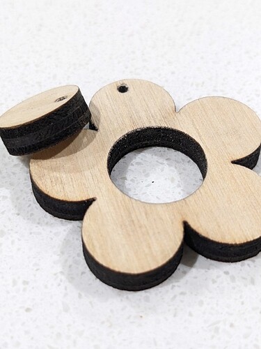

When cutting circles, squares etc, the end points have a step.
IE, they don’t meet up using LB.

Armed with a LB file on a memory stick, I aske Wayne if he could cut the flower shape on his Thunder laser 24 and 35 machines. I was hoping that this would prove, once and for all that our machine was the problem.
But…er…no! :rage:
The same issue was replicated on both the Thunder lasers, even tried on Wayne’s computers turning on and off “hide backlash.” Results were the same. Misaligned end points…!
So, maybe, I don’t need to plough 15k into a new machine I thought!
Wayne said that he uses RD Works and would try cutting the LB file though RD Works.
RD Works cut the circles perfectly. Endpoints married up with out any step at the end of the cut.
Amazed as much as I was, Wayne then tried again on LB, and guess what? Misaligned end points. Both of us were as perplexed as each other. Clearly, there is an inherent problem with LB software somewhere? I don’t buy it, that the “hide Backlash” option needs turning on, this is masking a LB issue, is it not?

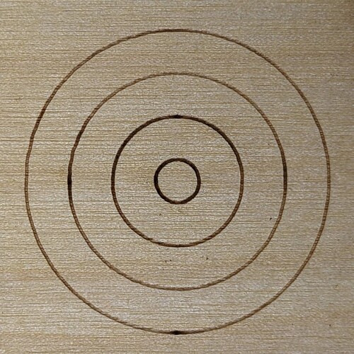

I’d like to better understand the issue. I’ve cut literally thousands of circles on multiple lasers and do not have the issue you’re describing but I may be misunderstanding the issue.
Can you provide the following:
  1. Photo of cut circle showing the artifact you’re describing
  2. Full screenshot of LightBurn with design loaded and ready to burn. Can you have Cut and Laser windows visible during the screenshot
  3. Screenshot of Edit->Device Settings
  4. Upload .lbrn file with your design
  5. Upload .rd file generated from your design
Is something preventing this?
Took a look at your design. I don’t see anything inherent in the design that would be a problem.
Ran it without fuss with only changes to the speed and power.
Also ran a concentric circle test.
These were without “Hide backlash” enabled and run on 1.4.01 beta although my results are no different than on previous releases.
Unless the RD file is somehow being generated incorrectly not sure what would be going on. I wonder if somehow the RD file is being generated as if “Hide backlash” were enabled. This could possibly explain why RDWorks looks correct while LightBurn does not. Reviewing the RD file would confirm this.
If the RD file is being generated correctly then this type of issue is almost always related to mechanical backlash. However, your results in RDWorks would make that seem less plausible.
Do you have a backlash setting configured at the controller? Under Miscellaneous in Edit->Machine Settings in LightBurn.
