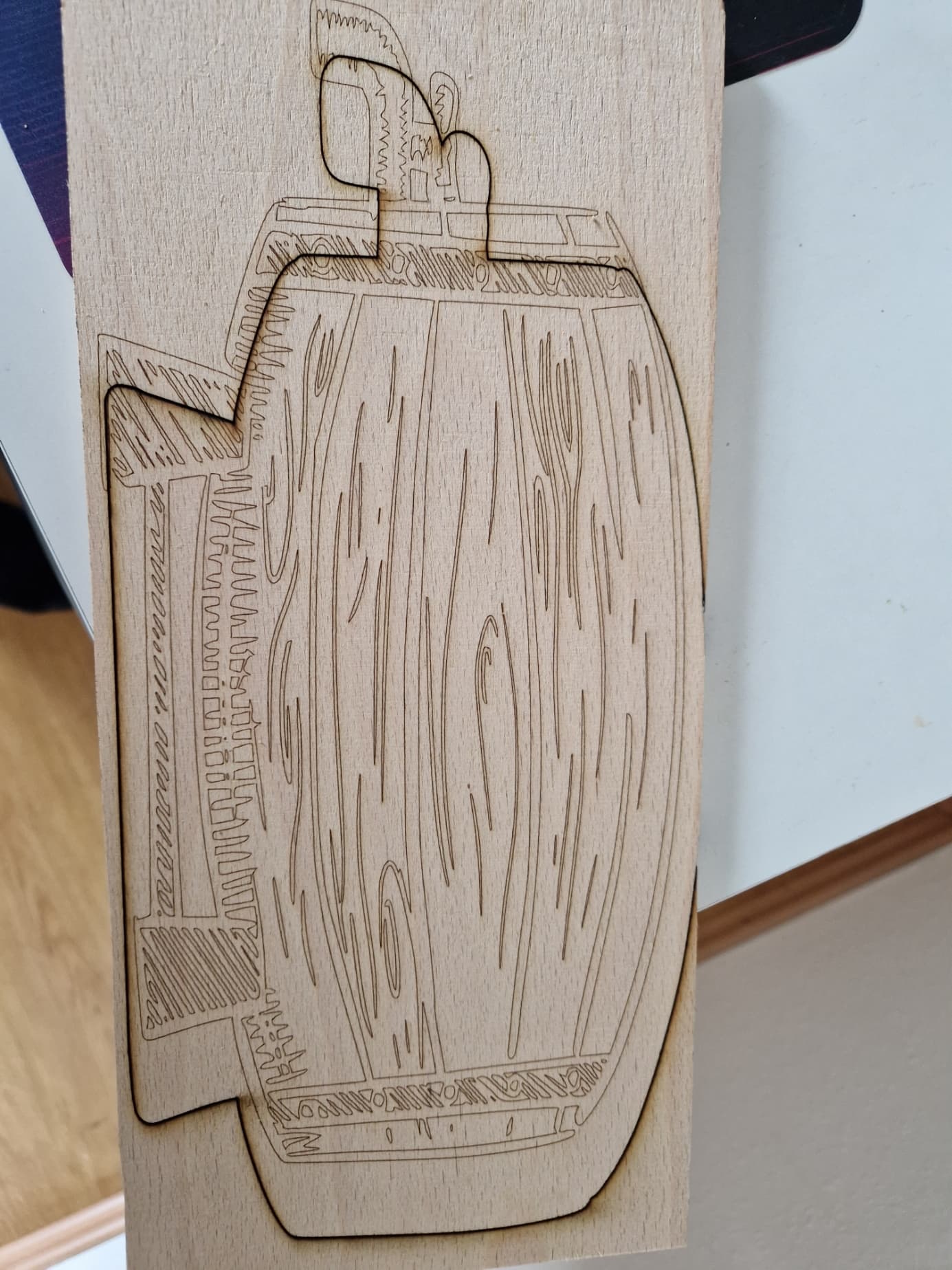

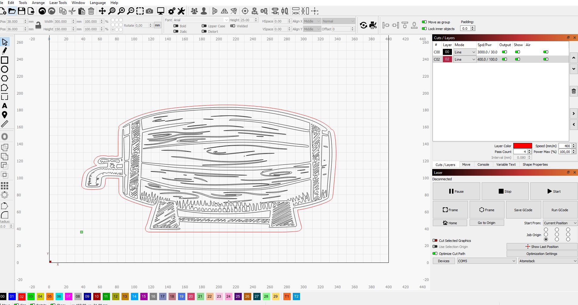

have a small problem I cannot solve. As you can see in the attached pictures I have a barrel and then I have the outline which I want to cut. In the preview everything looks great. But for the actual cut its just completly off.
I use the Atomstack X20 and when I tell him to go over the contours of the project he is going a bit out of the X and Y positions.
I attached here the beginning of the G-Code of the file, maybe someone here can see where the problem is:

Are you running this in a single job or in 2 separate jobs?
Can you save the entirety of the gcode with a .txt extension and upload the file here?
job.txt (352.9 KB)
attache dit here. I did it as a single job :slight_smile:
I don’t see anything fundamentally wrong in the gcode. I think it may be possible that you’re losing steps during the rapid moves between layers.

Thanks for the feedback but its not the belt tension. The machien first makes the inner engraving with higher speeds and no slipup of any sort. Afterwards the outer cut is made with a very slow, 4* repeated cut and it all aligns perfectly…except that its a few cenitemeters to the right :frowning:
But thanks for checking the gcode.
Theoretically then there should be a problme with the machine. Which also does not make too much sense for me since its all cut really good but just a bit to the side.

Quickly want to emphasise what the laser did at the beginning of the job. I did set it to “Start from current position” but after confirming the position in the controller and starting the job, the machien would move a bit down and to the left…which I think should not be happening.
With the correct job now this did not happen anymore.
Perhaps this is due to the way that the offline controller is working. It may override or somehow interfere with coordinates.
I realized I didn’t state it specifically, try running the same job from LightBurn connected to the laser to see if you have the same issue. That will isolate the issue to the offline controller.
Seems to be the offlien controller. Started the same job once with the offline controller and once with the lightburn directly from the PC.
With the PC the laser moved to the right and started its cut.
With the offline module it went to the bottom left before starting.
Since I am reliant on the offline controller this is not that great for me. Lets see what the future brings. Also just updated the firmware but no luck there.
