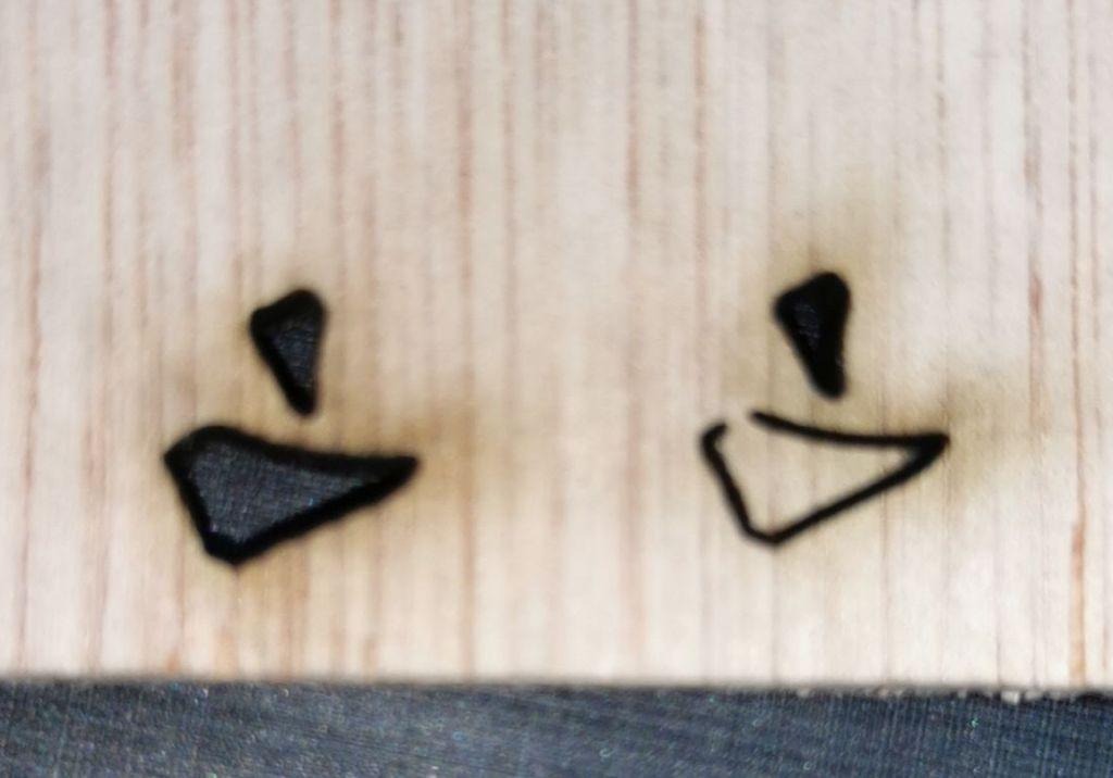

Here is a picture (Cut are 3mm x 3mm, very small !)
Left cut well, but right didn’t !
Guess what is the difference ? (Speed, power are then same, wood, geometry. There is 10mm between the two cut start maybe)
The ONLY difference is when I start the cut with job origin on Top Right, it is OK. But when I start bottom left, a small piece of cardboard or wood is NOT cutted. Some other job origin works, some others does not. I did not test everything !

What settings are you using? (Min Power and Max Power, specifically) Do you have tabs enabled? Does it improve at all if you use the ‘Hide Backlash’ option in the ‘Optimization Settings’?

No tabs enabled of course. This is EXACTLY the same job, exception made to the starting point of the job…

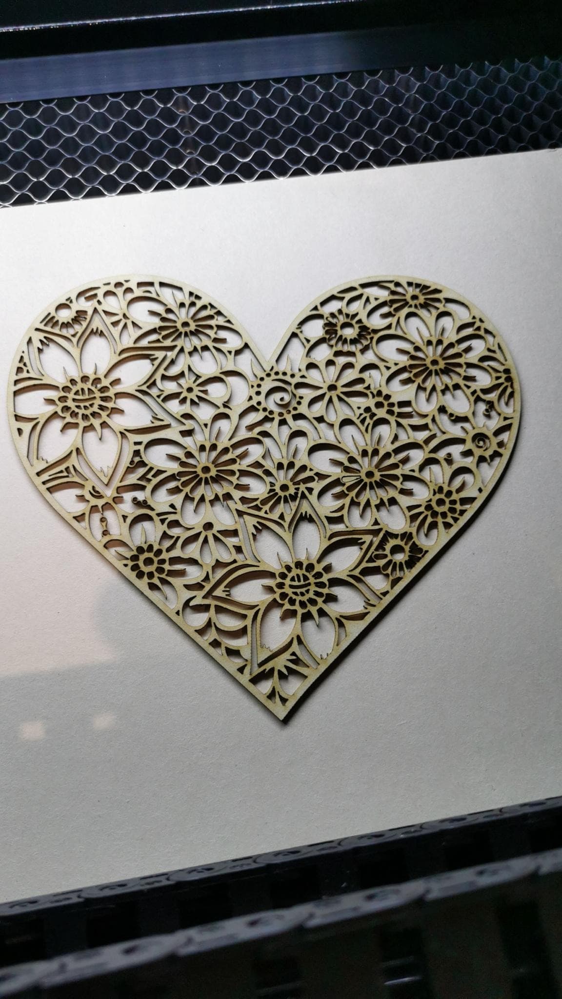

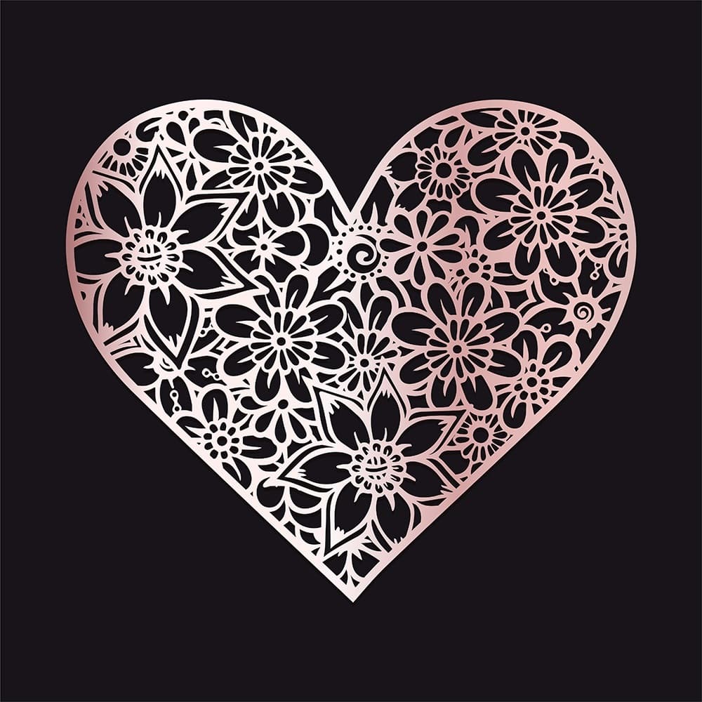

I don’t even move the gantry, I move the piece of wood under the laser each time. I was lucky to catch this issue. Problem came firstly from a very complex cut: Some piece were not able to detach, and I did not understand why. Here is the initial design

Backlash could easily be the issue - when the job is run from different starting points, the path planning in LightBurn chooses different shapes to run, because they are closer to that starting point, and the order of the shapes that follow will be different as well. The shape order and cutting directions affect belt tension when starting and ending a shape.
If you enable the ‘Hide Backlash’ option, it accounts for this, and forces the entry and exit directions of closed shapes to be consistent. If enabling the ‘Hide Backlash’ option makes it run the same from all starting points, then you might have a small amount of looseness or slop in your motion system.

Complex models (Heart) with many intricated details lead to some piece of material that does not detach properly.
I will try to cut the heart with starting Top right. If everything is perfect, I will conclude that is really not coming from the machine itself or from the parameters, but rather some kind of SW issue.

yesterday evening, I have cut the heart again on cardboard, starting bottom left and again top right.
Bottom left, came out quite well, but lots (30% maybe) were a little bit difficult to remove. I had to use a needle to remove the attached part.
Then I started again the same cut, (Top Right) and it came out absolutely perfectly. All small pieces remains on the honeycomb, very nice :wink:

You have Power Min set to 0 - that’s almost certainly why this is happening. Power Min is basically the power used for corners, starting, and stopping. Where the laser begins the job from will determine the order and direction of many of the moves, causing it to slow down or stop in different places.
When the laser slows to 10mm/sec or less, it will drop the power to 0 because that is what you have told it to do. CO2 lasers don’t fire below a minimum power threshold, usually about 10% of the tube wattage. if you are cutting, you should set Power Max and Power Min to the same value, or very close to it.

I think the difference may be due to the direction the beam travels around the shape, because that affects the path planning and the speed along the path.
Traveling clockwise, the path finishes on the straight line. Lines are produced by a single command, with the acceleration settings controlling the speed and, therefore, the beam power along the line. With the minimum power set to zero, the beam shuts off as the speed decreases.
Traveling counterclockwise, the path ends on the curved section, made up of many tiny straight lines. The speed along each lines begins at a specific takeoff speed that is high enough to fire the laser, but, because the line is so short, the acceleration settings have no effect: the line ends before the speed changes. As a result, the beam cuts “normally” for each of the zillion tiny lines along the curve.

Edinsley did a better job of explaining it, but this is exactly what I was trying to say in the above paragraph.
The direction the laser travels around the various shapes, and how it moves between them, affects where the laser has to stop or slow down, and when your Min Power value is zero, those points will have less cutting power applied.
If the path is traveled in such a way that the direction of the laser head at the end of one shape is the same direction it will take when moving to the next one, the head does not need to make a full stop, so the power would not be ramped down to Min Power.
If the direction to the next shape is the opposite direction to how the laser is traveling when it finishes the current shape, it would have to stop completely to change direction to travel to the next shape, and that full stop would cause power to ramp down to Min Power.
The starting point of your job will determine how the laser head travels through the various shapes, so this can absolutely affect where and when the laser head needs to stop.
