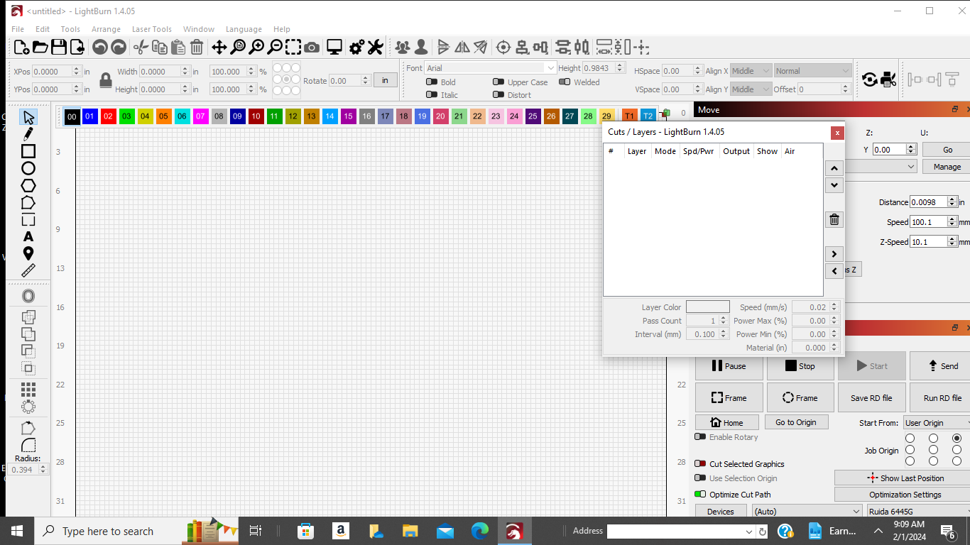

I moved the Cut Layer box and cant get it to go back to it spot. How do I restt it?

You can fully reset window layout by going to Window->Reset to default Layout.
However, you should be able to redock the window by clicking on the window title bar and dragging the window near the center of the window pane currently showing “Move” until it highlights in blue. Then release the mouse.
It worked! Thank you!
