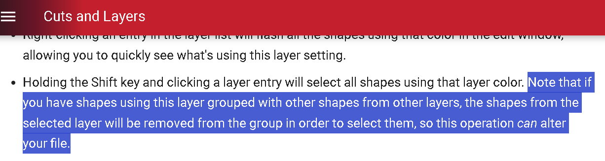

Perhaps try disabling “Show” on the layer if you don’t want to potentially grab those shapes instead of reassigning them. Or you can select all shapes on a layer by clicking the layer while holding shift.

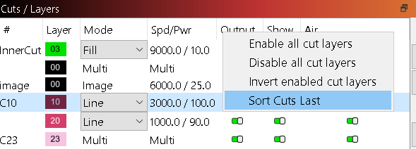

One option you can use to make the cuts last and not ruin the job is to right-click on the cuts/layers bar and select Sort Cuts Last.
I A L W A Y S do this (notice the all-caps?) before I hit the Start button. Node editing taught me this lesson.

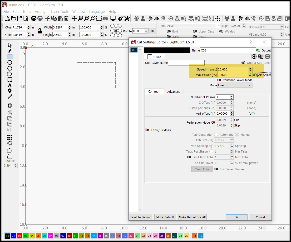

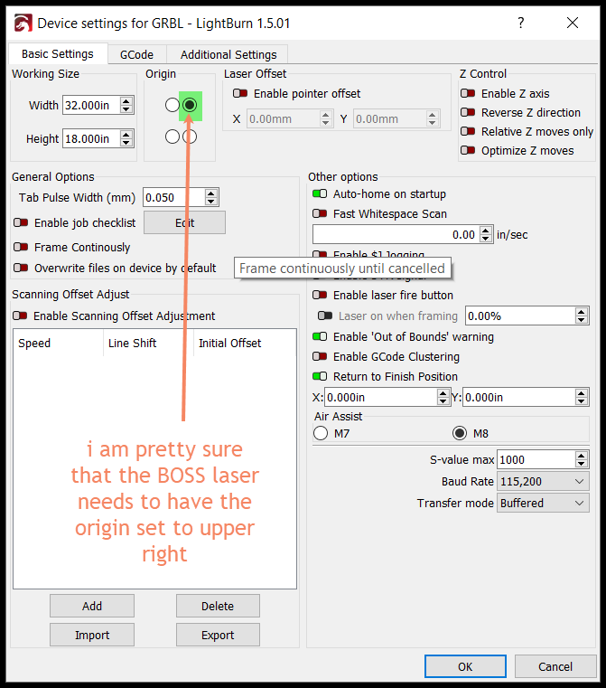

Hello, I am unsure if this is the feed to bring this up on. However, Here goes. I recently bought a Boss Laser CO2 - 100w Laser Engraver and Lightburn. I am new to both. I had previously been using a xTool diode 20w with xTool software.
Now to my problem, I added my Boss Laser to the Lightburn program and I when I take an image on Lightburn (DXF File) and attempt to cut it out, first it mirrors my image on my laser and when I set my speed at 20 and my power at 100, it runs a lot faster on my laser and ends up scoring instead of cutting out the image. Has anyone else had this issue and can anyone give me any advice on how to fix both issues?
Where is your origin set to in Lightburn? It should be set to the corner that the laser homes to when powered up.
What does your screen look like in cut settings?
